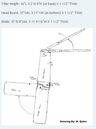

This might not be the same design but this is how the Mac 25's baby sister (the Mac 22) does it.

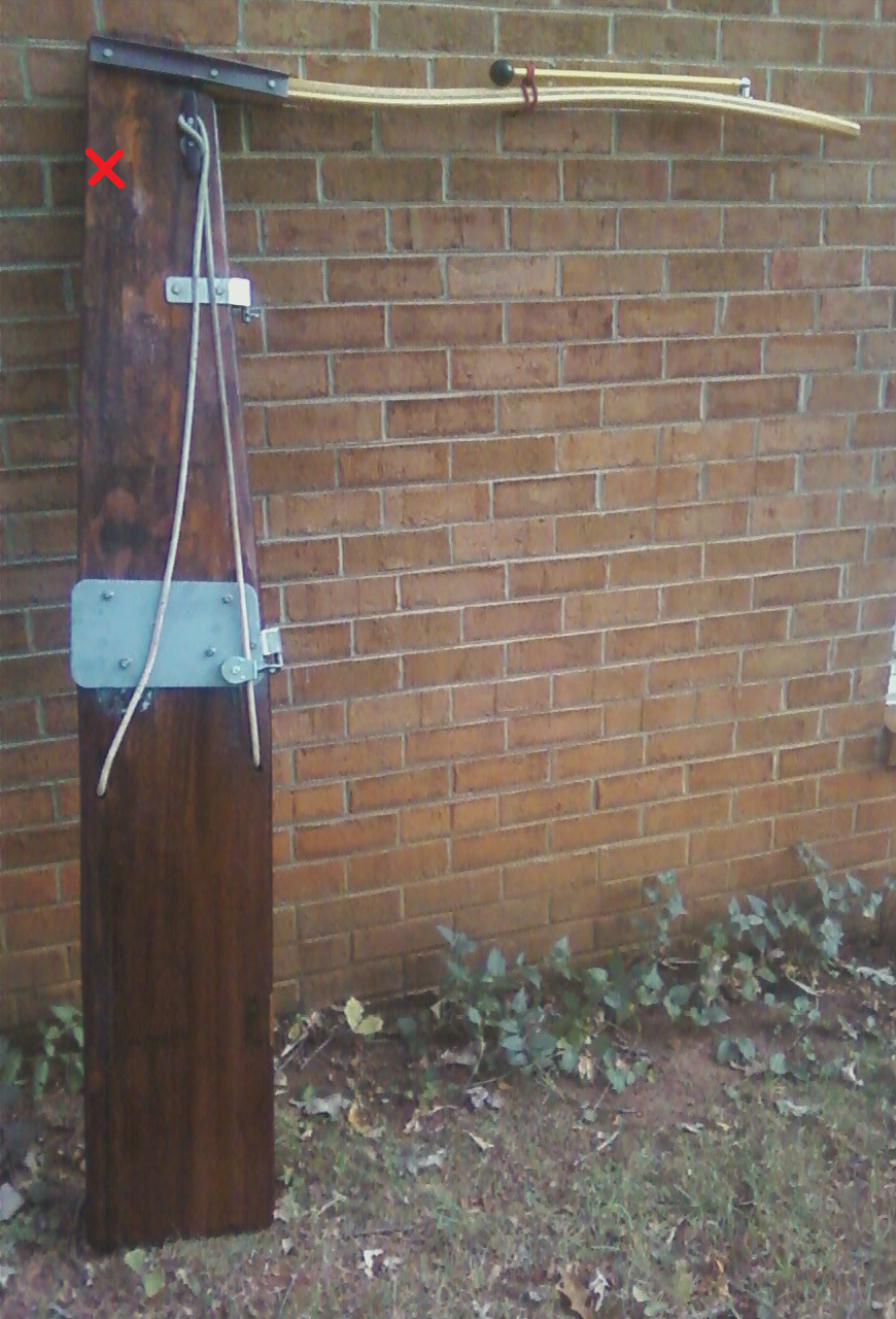

I always found it hard to lift the line without reaching far overboard, hanging off the stern. I think if you added a cheek block where I drew the red "X" and rand the line through the block before running it down the back, you would get a lot more purchase and have an easier time lifting the line.
