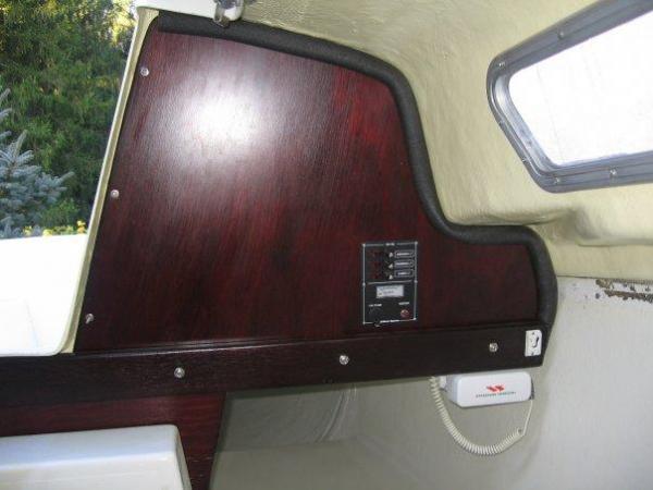

Has anyone else with a Mac 25 found this issue?
Is there a 1/2 inch plywood bulkhead surrounding the area? If not, what you've described could certainly happen.
If so, does the bulkhead wedge tightly against the step inside the companionway?
Pics of the bulkhead would be nice.
I'll look for some of mine to post.
Feb 20, 2011
8,059
Found one that barely shows the part. You can just see the stained and sealed plywood as it laps over and through-bolts with the upper bulkhead and companionway.

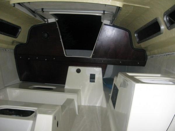

Not very clear in these pics, but there should be a board that fastens the cockpit floor (deck half of boat) to the hull liner (which is firmly attached to the hull). My 1979 model has the winch step, which I reinforced with wide oak flooring .
Sep 25, 2008
961
Macgregor & Island Packet VENTURE 25 & IP-38 NORTH EAST, MD
There are also 2 bolts you can see in the front cockpit footwell.

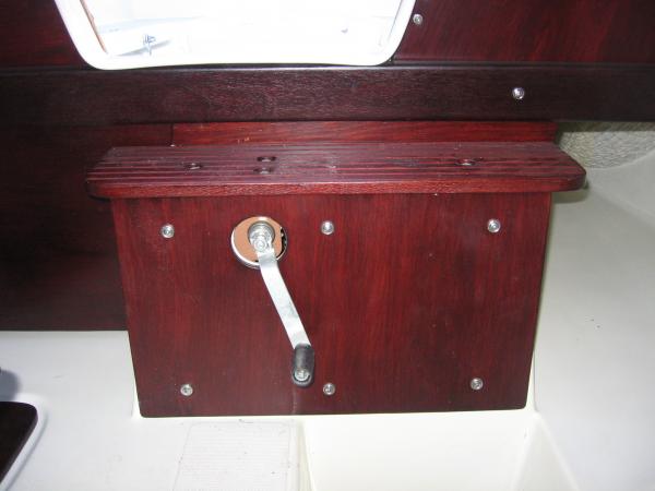

found a better pick of the bulkhead setup

You've jogged my mind. I'm refurbing the Mac 25 and have removed all of the bulkheads and other panels. There is a piece which fits beneath the threshold which may provide stiffness to the area when hoisting the keel. I'll have to check it out.
