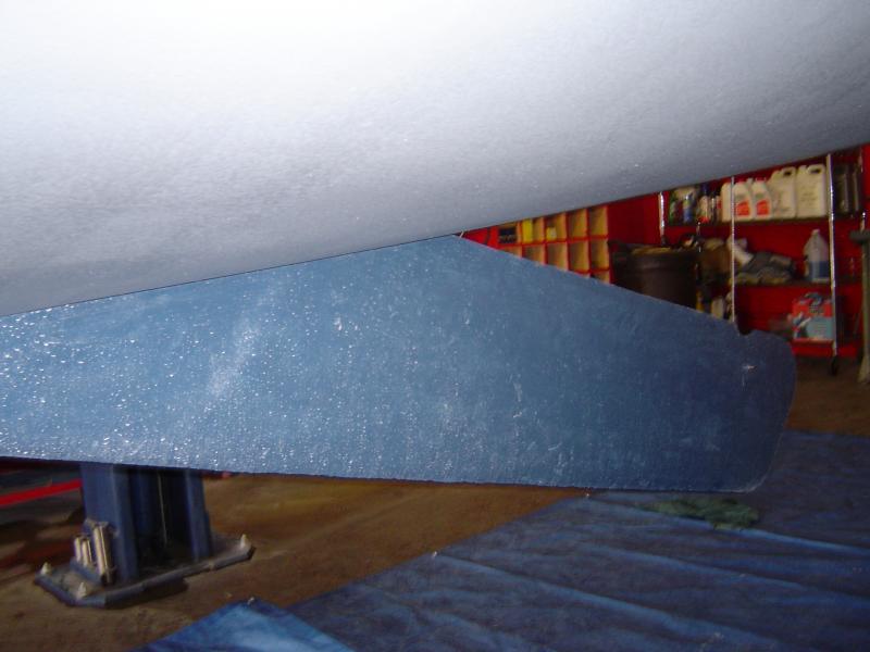

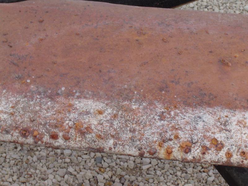

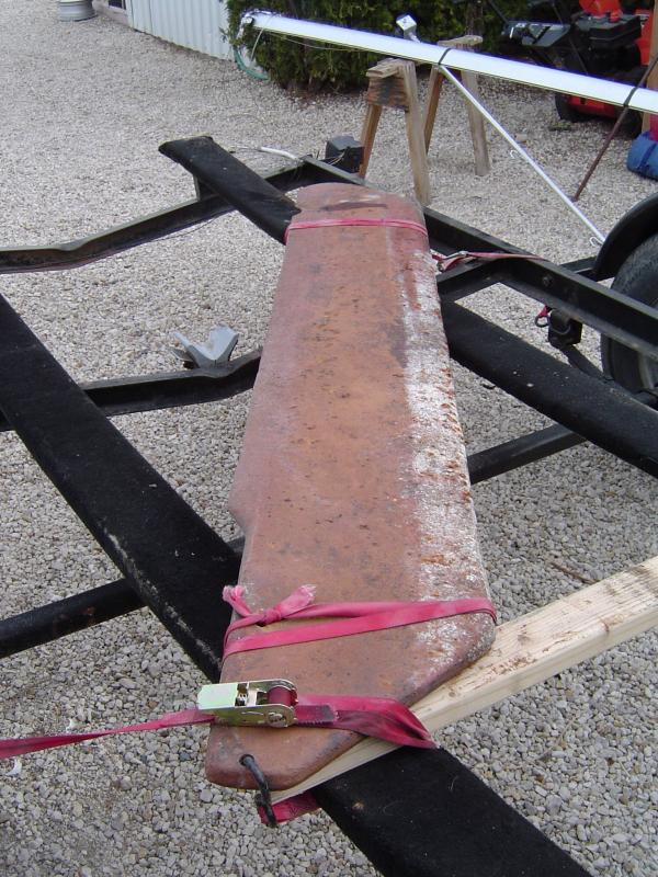

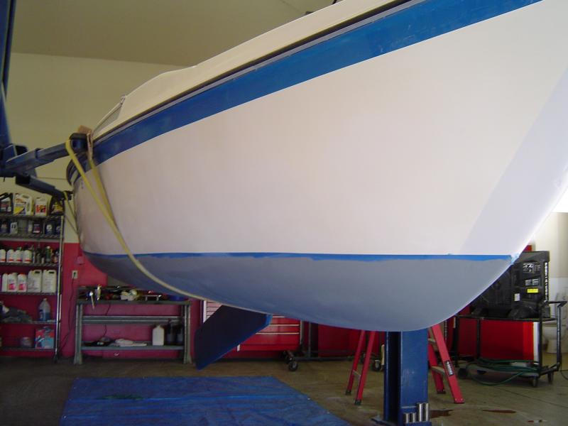

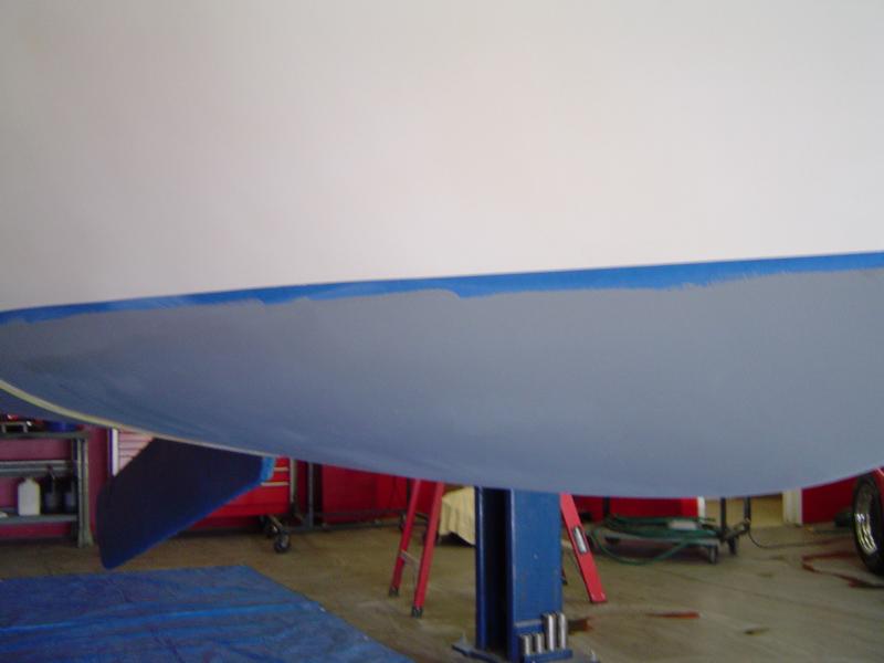

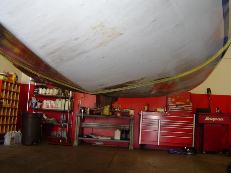

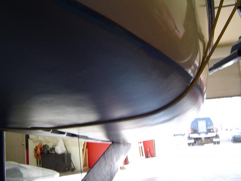

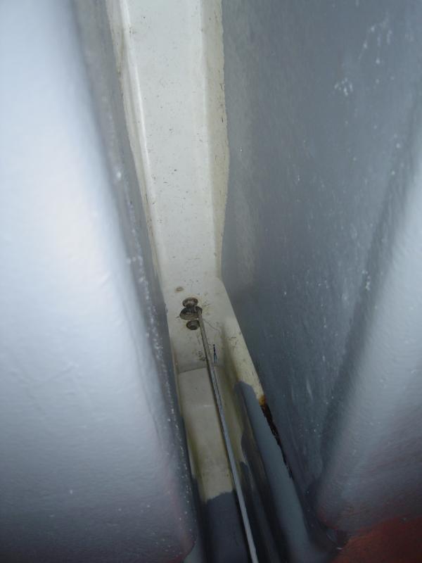

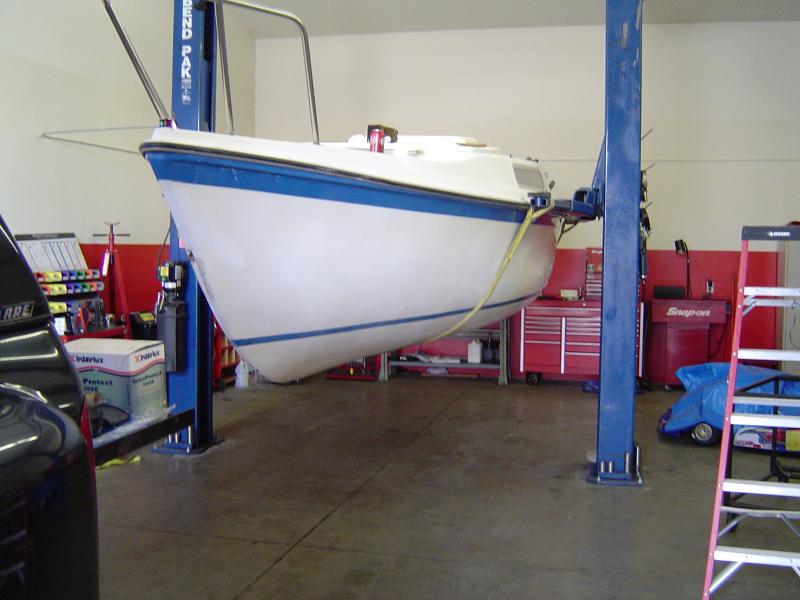

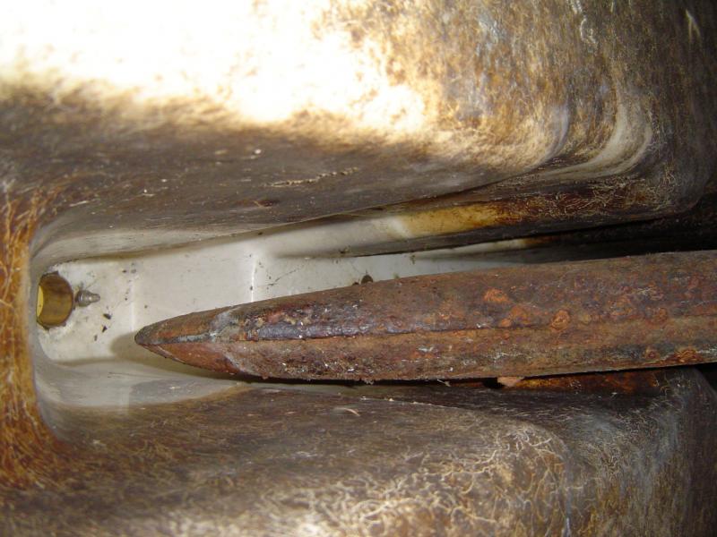

I just finished bottom job to remove/treat blisters and apply barrier coat to my Mac22.
Fortunately a buddy let me use his lift at his auto repair shop for a week, which made the job manageble. Once on the lift, I sanded out the bilsters (about a hundred or so dime and quarter sized deformities), filled with Interlux watertite epoxy, removed the keel, took it to a local sandblasting shop to remove rust etc., primed, painted (rust inhibating metal paint) and re-installed keel, sanded epoxy spots then topped it off with 3 coats of Intec 2000 barrier coat (1 gal). No anti-fouling paint as it lives on the trailer most of the time. All-in-all a bugger of a job that took 5 days of 6 hours/day to complete, one which I have no intention of repeating again. I also repainted the trailer and replaced the bunks and carpet while waiting for the barrier coats to setup. I've included some snaps of the process for any fellow MAC sailors that may find it of interest.
