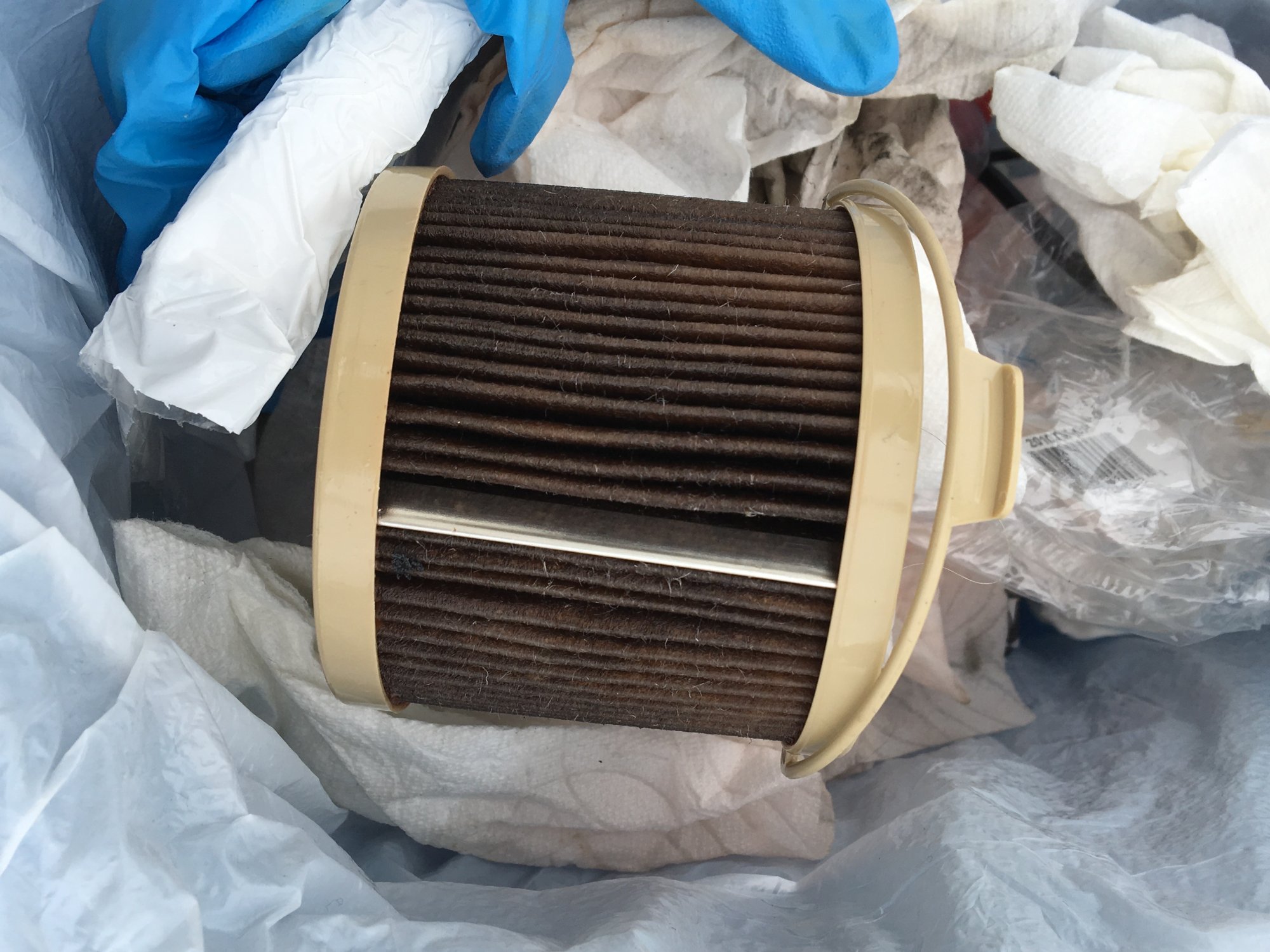

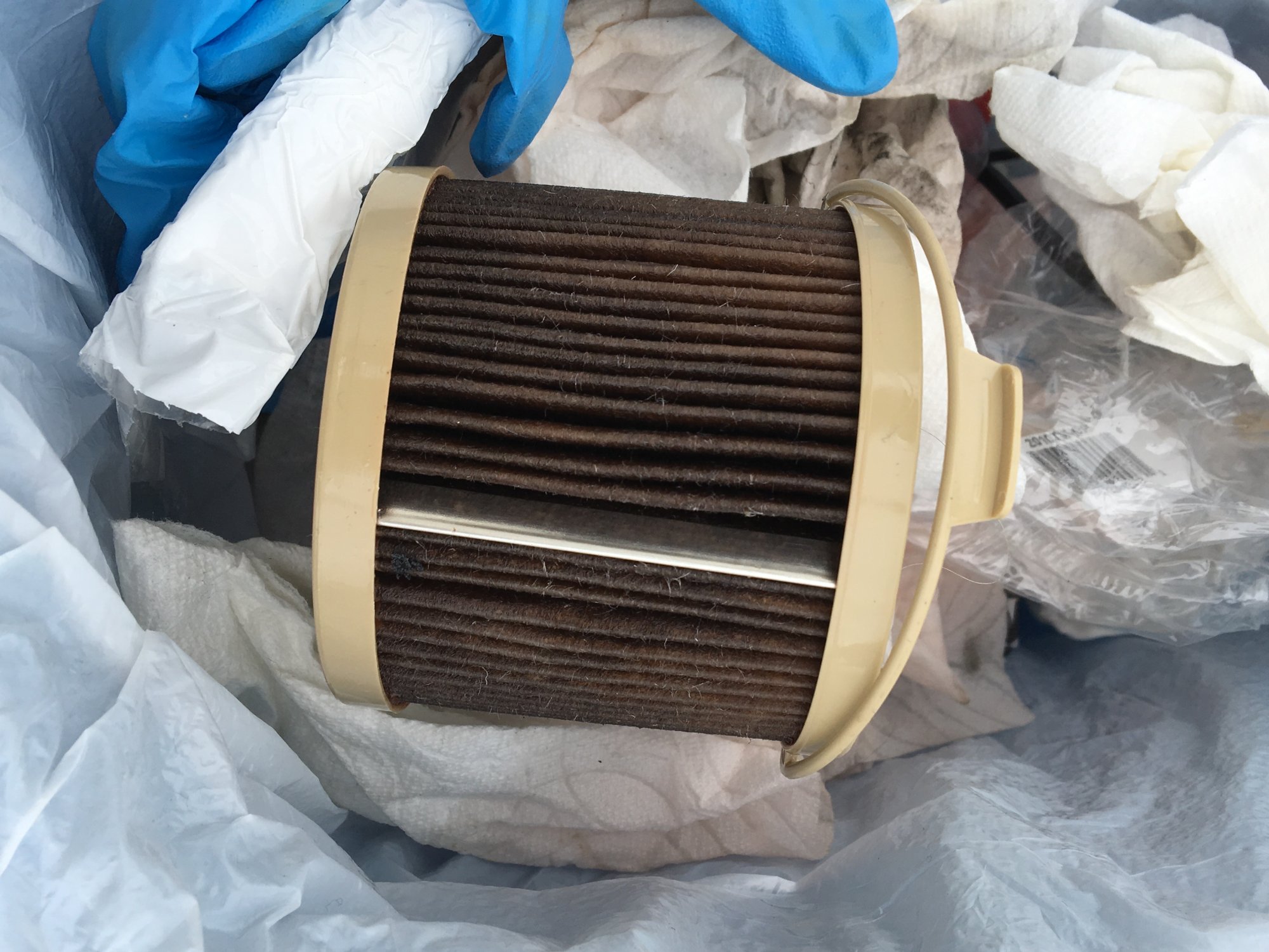

  4. You installed clean filters. I had this issue. Here is an image of a dirty filter that caused my engine to stop.
