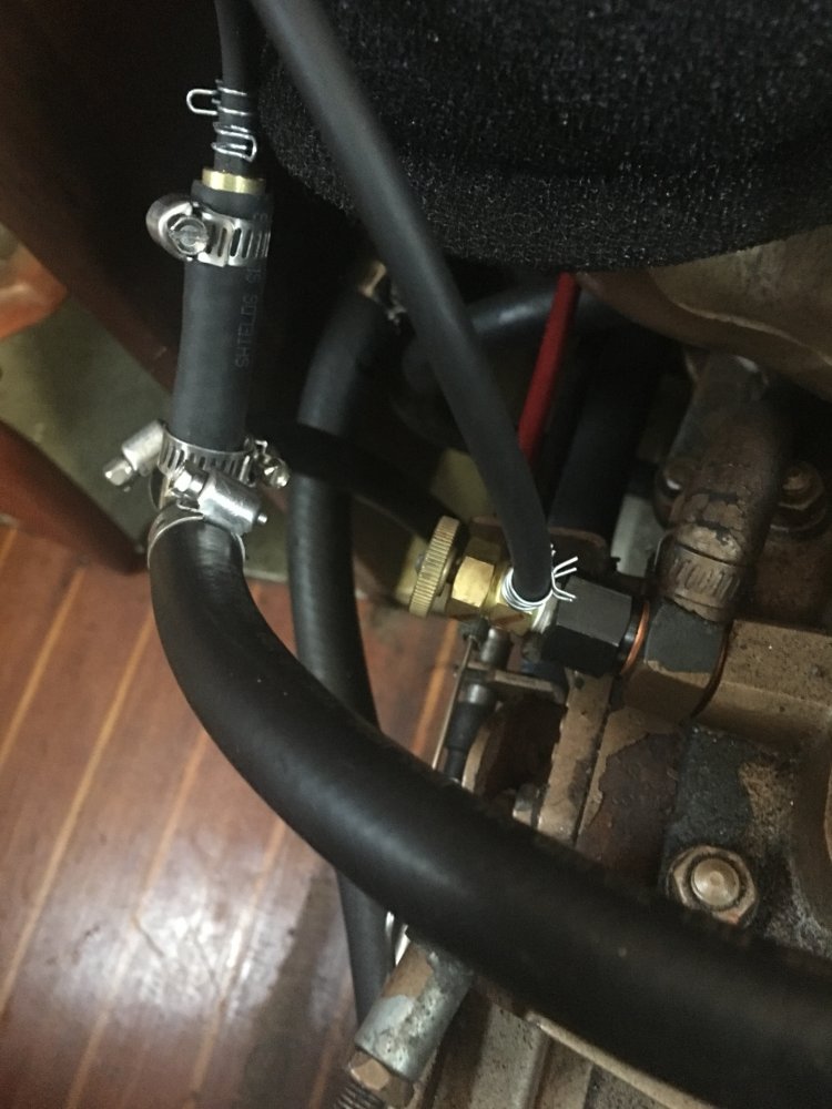

Do you leave the bleed valve open 1/4 turn?
Yes, it helps keep any residual air out of the injectors. It doesn’t impact performance because your only bleeding a tiny bit of fuel, the engine gets more than enough for the .5gal/hr it needs.
@jviss I leave it that way
Les
Mar 27, 2016
89
Catalina 30 Hingham
I will try anything about right now . Just to be certain this is the knurled thumb screw bleed valve?
May 20, 2016
3,014
Yup. Mine is a retrofit your tubing may look different.
One thing that hasn’t been mentioned is crap on the screen on the fuel tank suction line.
May 20, 2016
3,014
Hope is just fuel. If your sucking air it should mostly routed back to the tank.
Do you still have the bolt there or the bleed valve as shown. If the bolt leave it tight or you’ll have a big mess. With the valve it’s routed to back to the tank, invisibly via the fuel return
