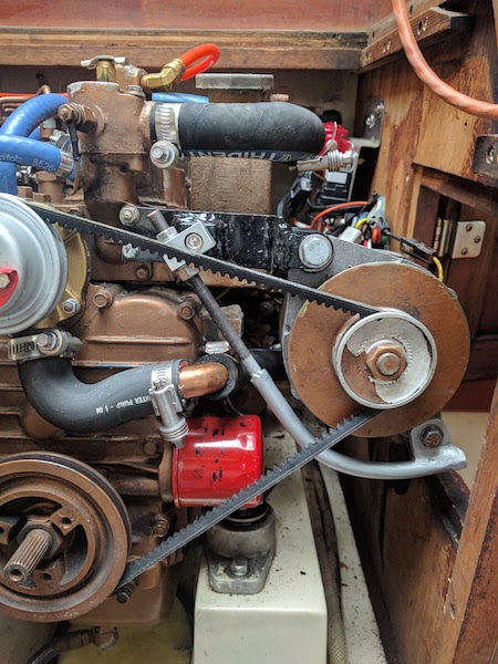

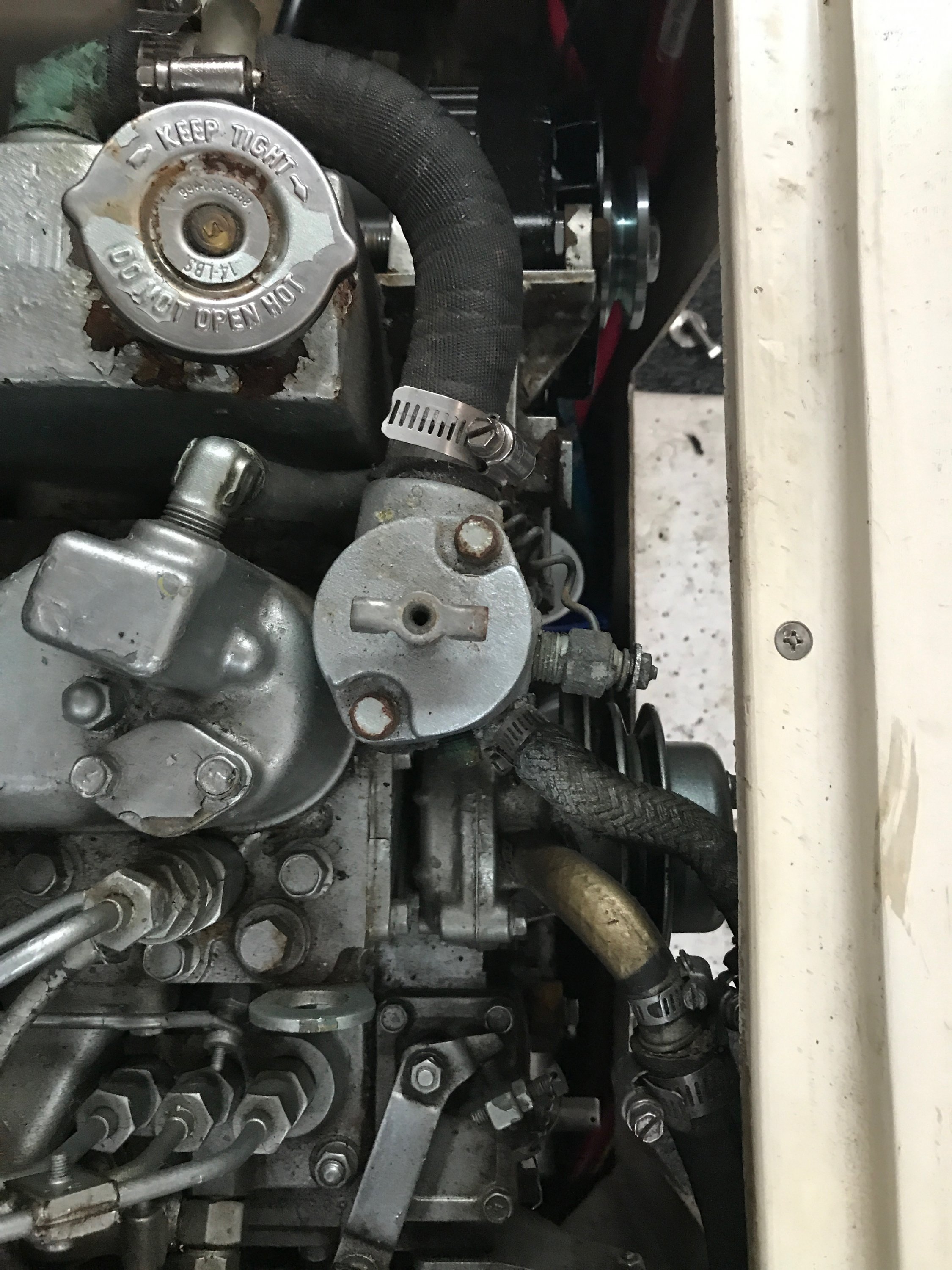

Photo of the top of the M-25XP showing smaller thermostat hoses and one of larger bent hose. The second photo shows the short 90 deg bent hose I'm more concerned about bending my self. It comes off the bottom of the fresh water pump of the diesel.

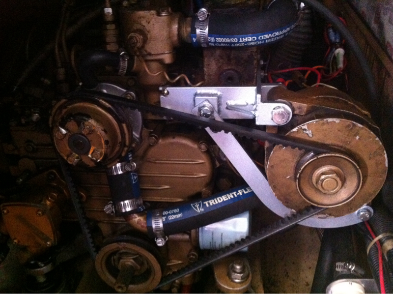

I replaced all hoses with Trident Flex.
Not wire reinforced, but way above heater hose.
More $ but not really that much for all hoses. Easy task.
No prebent required.

The trickiest hose is the one underneath the coolant pump: http://c34.org/bbs/index.php/topic,7084.msg47677.html#msg47677
Others I used Trident, wire reinforced. All over. The 90 deg you show is easy to make do with regular hose.

Stu's link took me to a thread on the C34 site with both a Gates part number and a Dayco part number. Both are listed on line at various auto stores so next time I'm out I'll pick one up.
I'll be back down to the boat on Saturday to measure the lengths I need and will probably go with the Trident Flex hose.

Picked up a Dayco A 70637 for $3.95 at AutoZone. Looks like it will do the trick for the bottom water pump hose.
