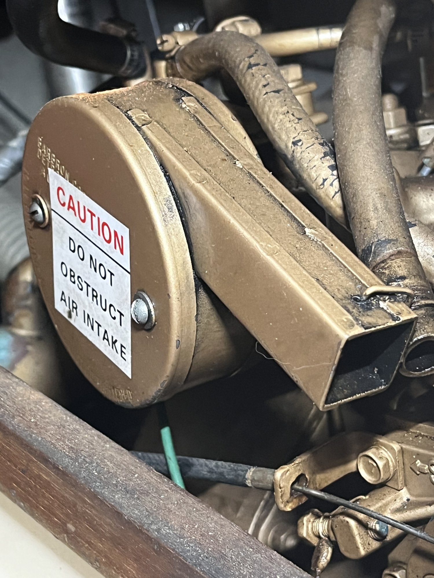

I am looking for a solution to add an air filter to my M-18. My understanding is the round box is just a muffler.
I know this might be overkill. The engine is 40 years old and still working. But I have removed mud daubers from the engine compartment, so I don't consider the environment completely clean (an assumption for marine engines).
Has anyone added on an actual filter?
May 17, 2004
6,255
The intake breather in your photo can serve as both a silencer and coarse filter. Inside it originally was a metal mesh supporting a foam filter. Over the years the filter has probably broken down and been digested by the engine. The fact that the engine could eat that and still runs fine should give you some indication of the engine’s tolerance for debris. If you want something to keep out things like mud daubers just find a replacement element.
