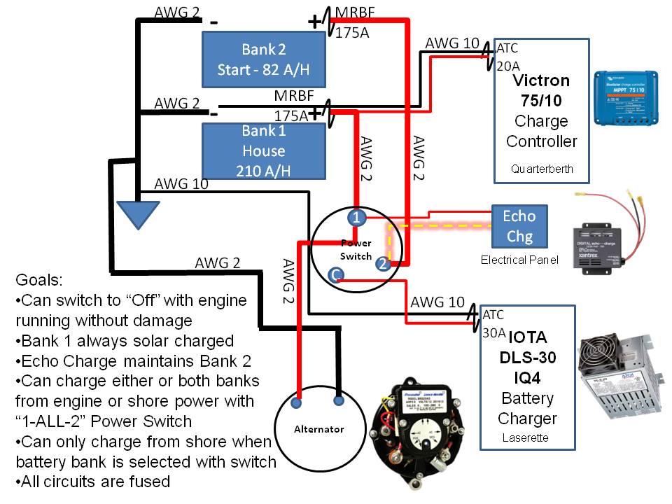

During the season, I keep the batteries charged by a 100 Watt Solar Panel, which is then connected to a Victron Energy MPPT Controller, which is set up for Flooded Lead Acid Batteries.
If it helps, here is a schematic of the charging setup of my primary electrical system;
TLDR; I am looking for battery recommendations. I am currently planning on 2 EverStart Maxx Group 29DC batteries from Wally-world for ~$260.
Change my mind!

The two Grp 31 are Bank 1 (House) and the single Grp 24 is bank 2 (Spare). See the diagram of my charging system above for details.
I looked but hard to follow. Just wanted to pass along the suggestion which I infer you already understood.
