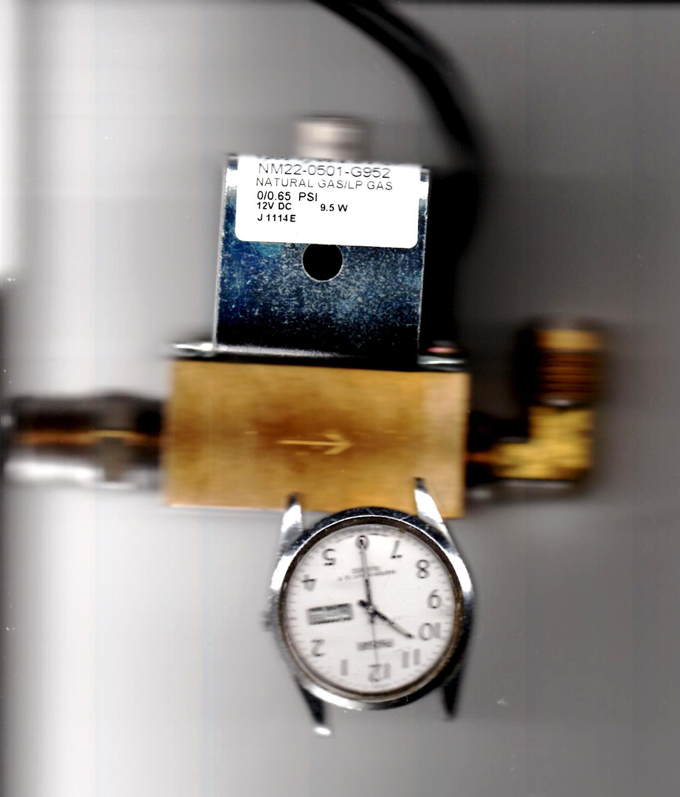

12V LP gas solenoid on my Beneteau 323 is frozen closed...and in need of replacement. It is the factory installed low pressure solenoid. In searching the forum, I've noticed that the AFC model 151 is highly recommended...however this model is intended for installation on high pressure side. Question is...can this 151 high pressure solenoid function if installed on the low pressure side. I've checked specifications, and do not see a minimum pressure required for proper operation, therefore seems like it would work. I'm sure some will say to simply install on high pressure side. Therefore...yes, I am aware this is an option... If there is some reason to not install an HP solenoid in the LP position, please advise.

RS, did you price a new one on the B parts site? I bought one, but can't find the paperwork. It is the B part #459888. 065 psi, 9.5 w.

Ahhh.....Ron you are correct, the part number I reference above is for the entire assembly (hoses, reg, solenoid). The solenoid itself is part number 459888 and priced at $103.37. A bit better than $183. Still not beating the AFC 151 for ~$30.

Any chance you could post the photo of the oem selenoid, once the replacement arrives? Thank you.

Gunni, I purchased the AFC 151 (HP 1/4"), and will need to add fittings to swap out with factory LP solenoid (LP 3/8"). So, am expecting that much.
Bosman, I'll take pic's of OEM solenoid and AFC solenoid...and follow up as to if the AFC truly works on the LP side. I expect it will.
