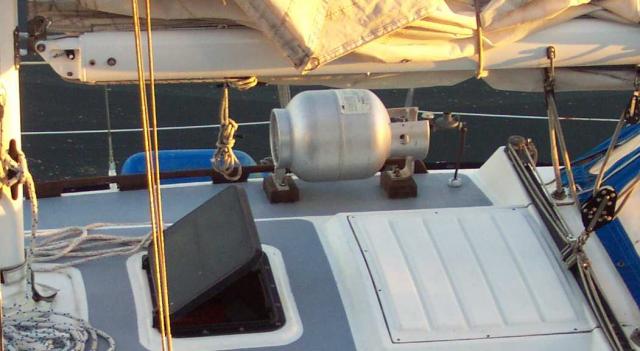

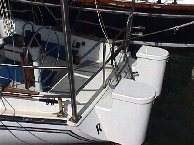

I saw the twin unit that rainbow chaser ( see picture) built and located on his stern. I am afraid following seas would take them out. I have seen another set up from Jim Hayes were the tank was laying sideways on the cabin top. Short of attaching it to the rear pulpit, I am at a loss.

But forced to add small tanks(10 lb.?) I would place them in the far corners of the stern. Someone did that recently on a smaller Cherubini I think. Maybe they will see this and provide a link. Basically they glassed in two sides with a top and vented the bottom out the stern I think.

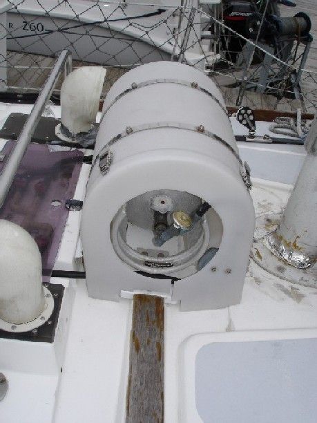

I inherited the arrangement in the attached picture from the previous owner. I have long been dissatisfied but it works. Now I have come up against the fact that the gas bottle must be recertified and it has inspired me to make some improvement.
I would like to use 20 pound bottles because they are only 4" taller and 2" greater diameter than 10 pound bottles.
I would also like to have 2. I like Ed's suggestion of somehow sqeezing them in the cockpit area
