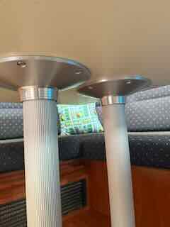

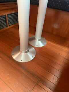

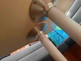

I have a Hunter 39. I want to switch the long table legs with the shorter legs. I'm probably missing something obvious but I don't see how to remove them. There doesn't seem to be a set screw or anything. The shorter legs don't have anything that indicates there fastened down. I've tried just lifting it off but haven't been able to. I didn't want to apply more force in case I am missing something. Does anyone know how the table comes off?

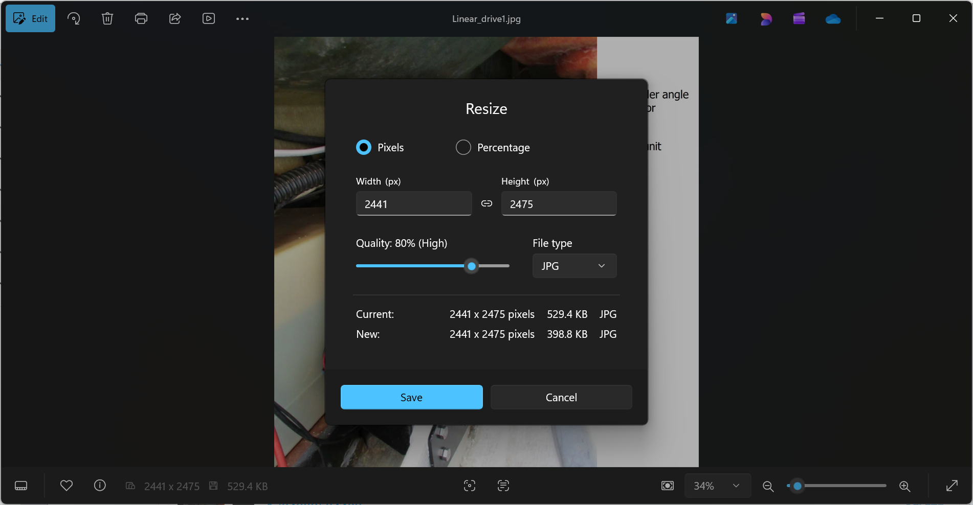

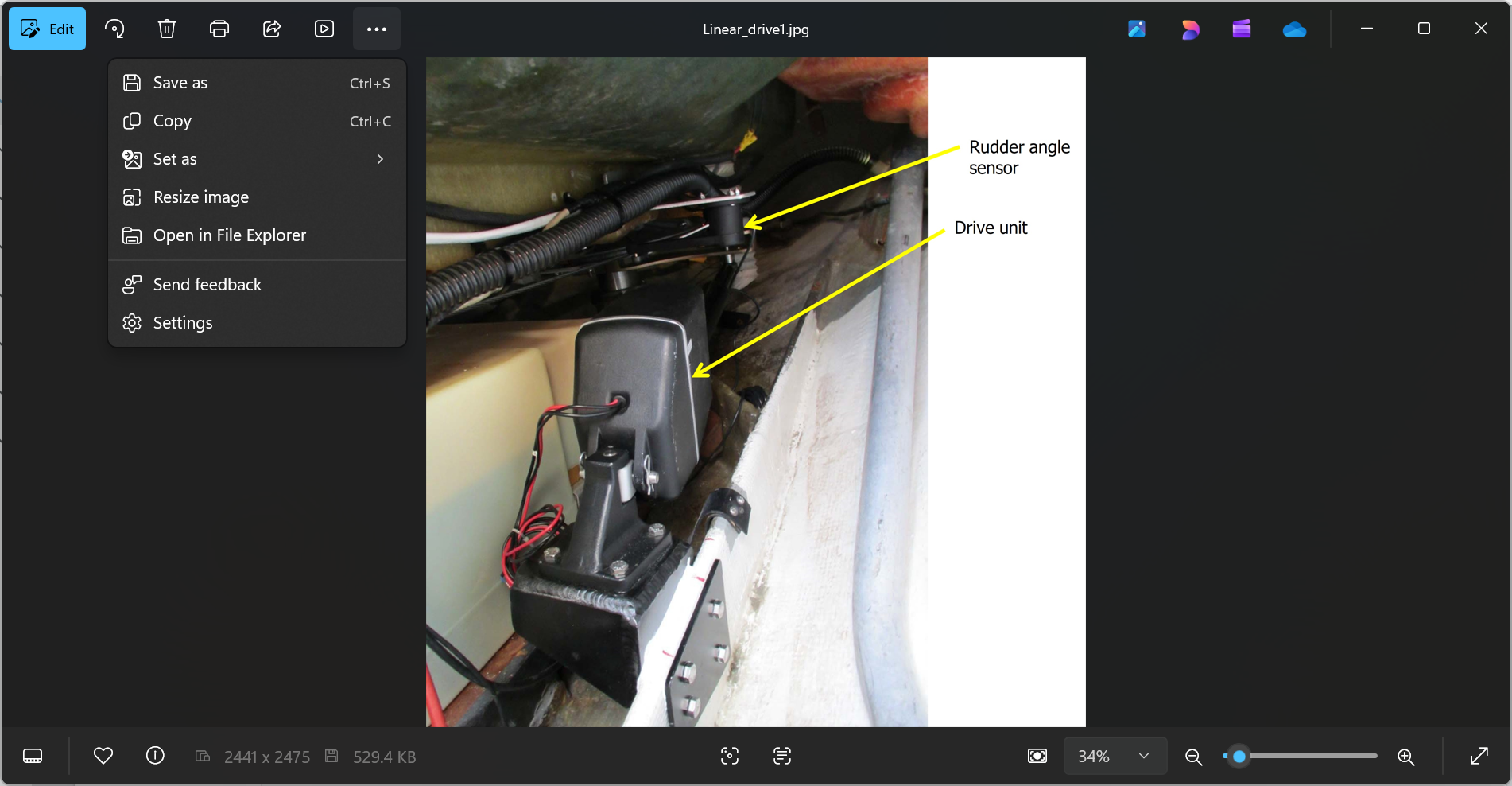

I tried to attach photos but it is saying the images are too big. Anyone know how to reduce the size?
May 1, 2011
5,602
Pearson 37 Lusby MD
Use an image editor to reduce the size of the images. For example, on Win 11, open the image in Photos. Click on the three dots and select Resize image. This will give you the ability to reduce the number of pixels, reducing the size of the image.

Maybe start by removing all four screws in each of the two conical cover plates (top and bottom), remove the assembly and see what's holding the tubes tightly inside.
Be careful if any hinges are attached to the table top as that could upset the apple cart for angularity.

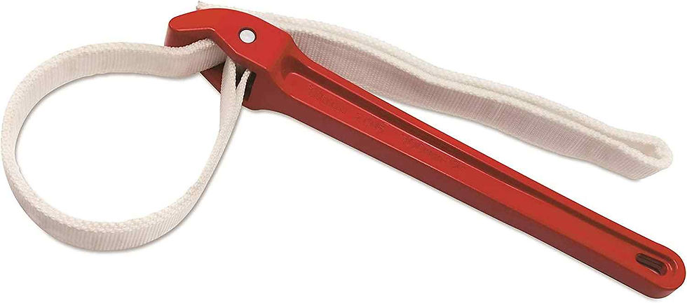

When I had that occur I used a strap wrench. The type you use to remove a large oil filter.
If you can get one with a rubber strap it will grab better on the aluminum pipe. Then just rotate the pipes. The wrench and a bit of CB should loosen them enough to pull them out of the bases.

I had a 2011 39 ft Hunter, and always found the table legs difficult to remove. There is nothing holding them in place except the tightness of their fit within the sockets at the deck and bottom of the table. I suggest that you just gently wobble the legs back and forth, while pulling legs away from the table. I always found this frustrating

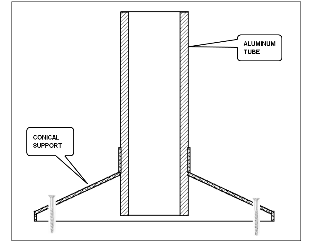

@Dave Thompson , thanks for your additional input in helping to solve this "simple for some and confusing to others" problem.
Would it be fair to say the below sectional drawing
represents what you found within the conical fittings holding each of the two aluminum support legs in place on your 2011 39 ft. Hunter ?
As we can see from the photo in post #1 :

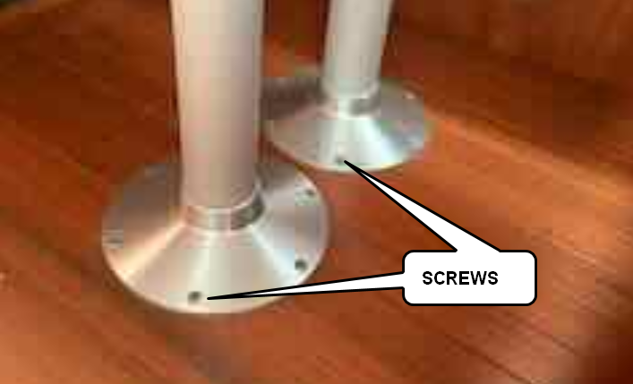

.............. the bottom support cones are each held in place with six screws into the cabin sole as well as the top support cones :

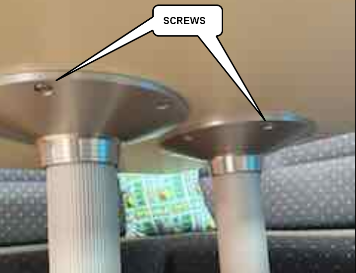

................. which are screwed to the underside of the table.
I don't think it too far a stretch for either the mind or body to carefully remove the wood screws from all four of the cones while supporting the table top in place. The table top is then slightly lifted and the two aluminum supporting assemblies removed.
They can then be inspected and any required remediation done to allow the legs to move freely or else replace the legs.

As a professional in this matter, having removed and switched two short and two long tubes over multiple sailing seasons, to set table height to bed or dining table, if you lift the table you often can release the legs from the floor base and then grip the tubes and wiggle or rotate them out of the bases beneath the table top.
The tubes come out more easily when you can pull them straight out. Sometimes they can feel like they are jammed in place. This is when I have engaged the strap wrench. Twisting the tube and a bit of penetrating oil can be the magic juice to break them free.

Thank you all for confirming how this goes together with out me having to completely disassemble it to figure it out. I was able to get the legs off. Thanks to some of the feedback here I realized it really wanted to come straight off. I couldn't get if off by myself but with two people pulling straight up and came right out. Fortunately didn't have any corrosion. I looks like because there are two legs and the table is heavy pulling by myself they would bind against each other. Again thank you all for your help.
