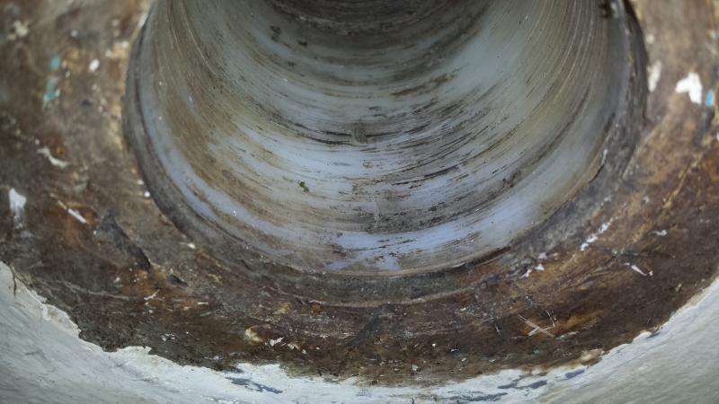

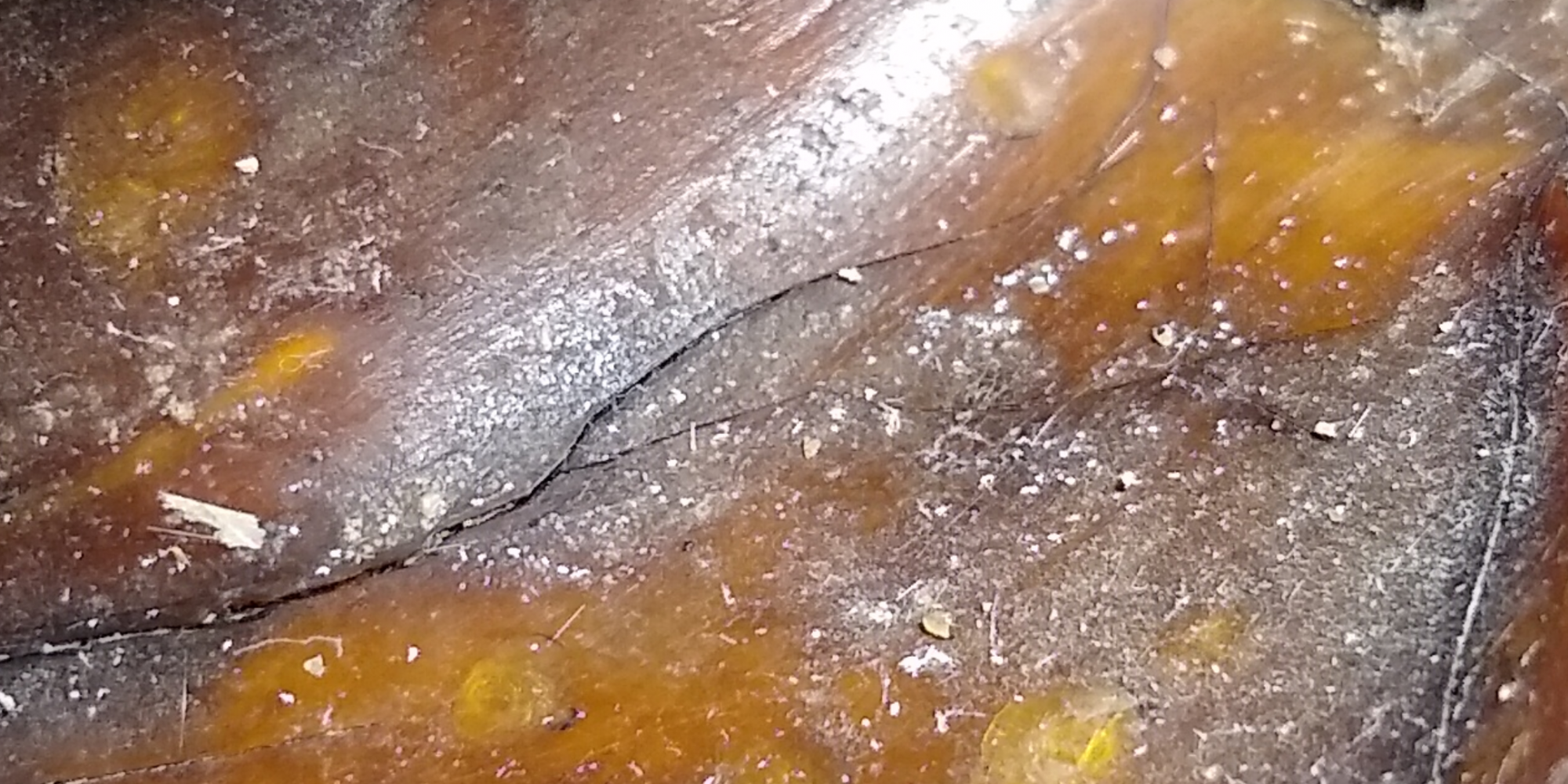

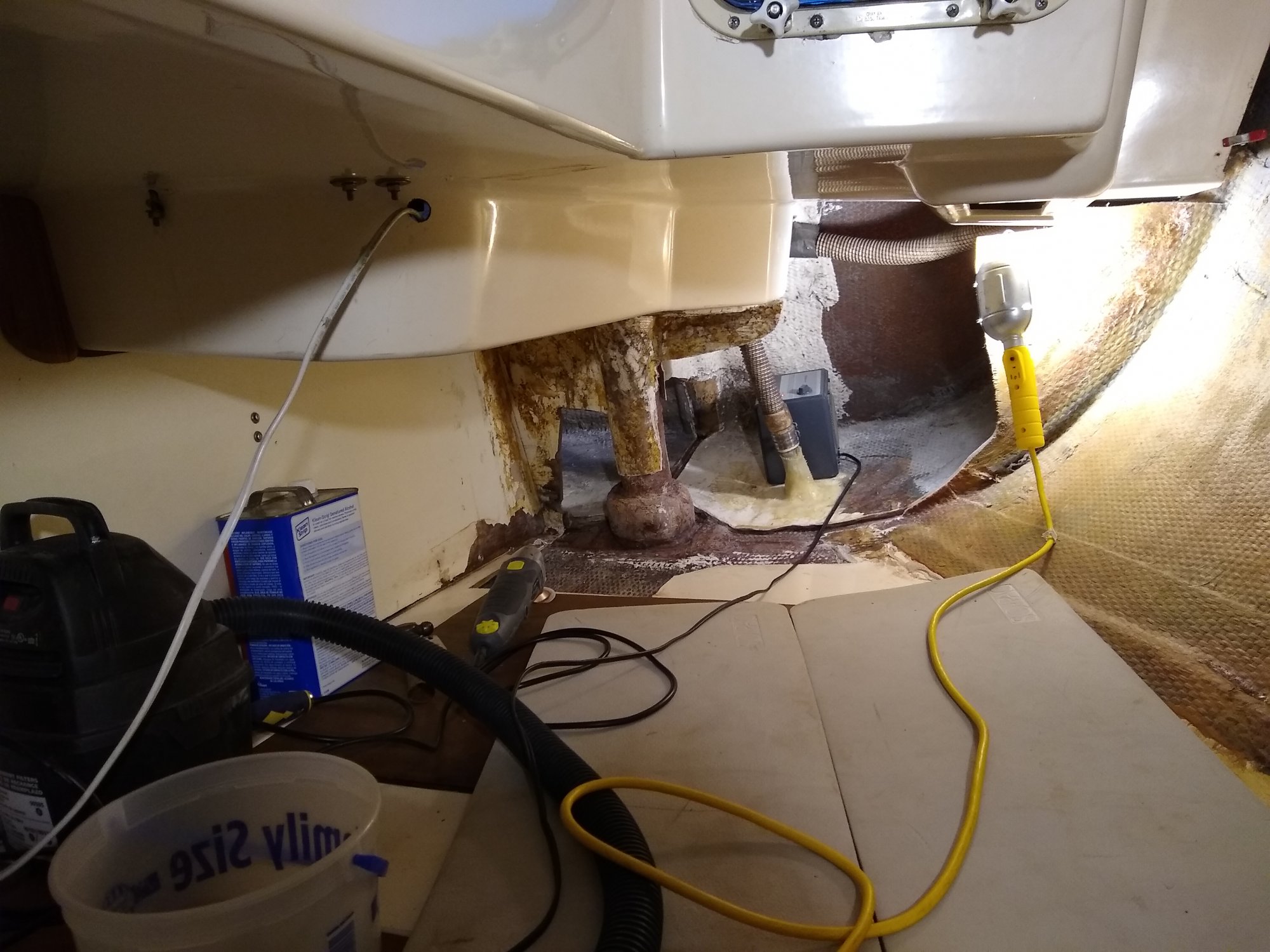

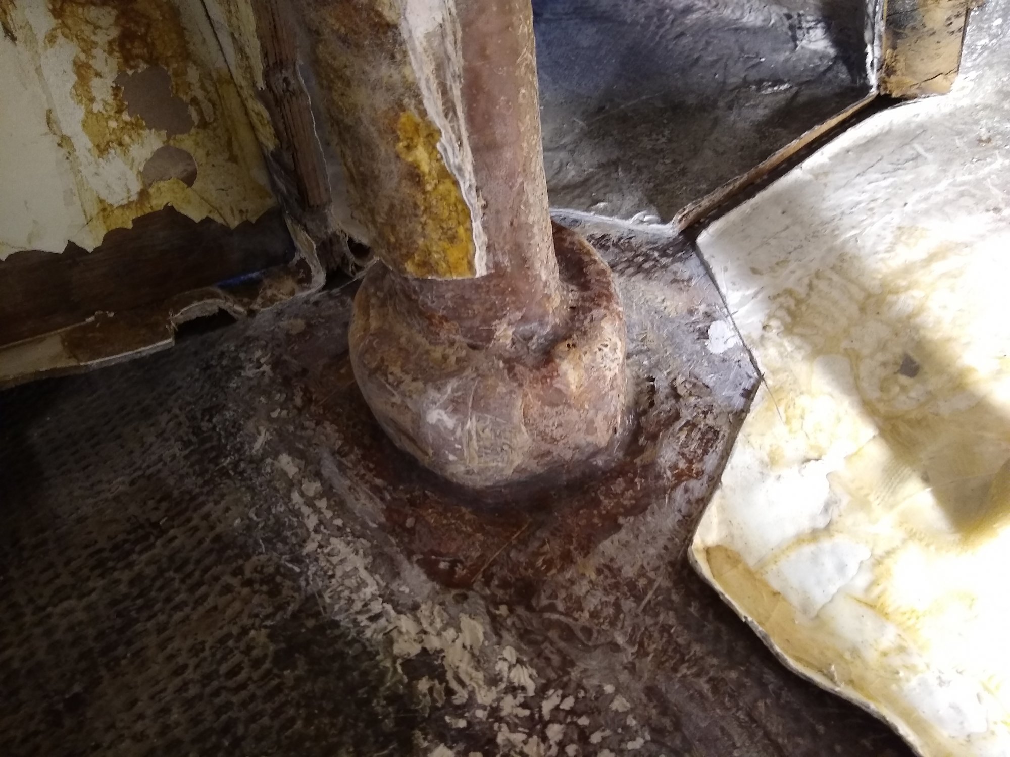

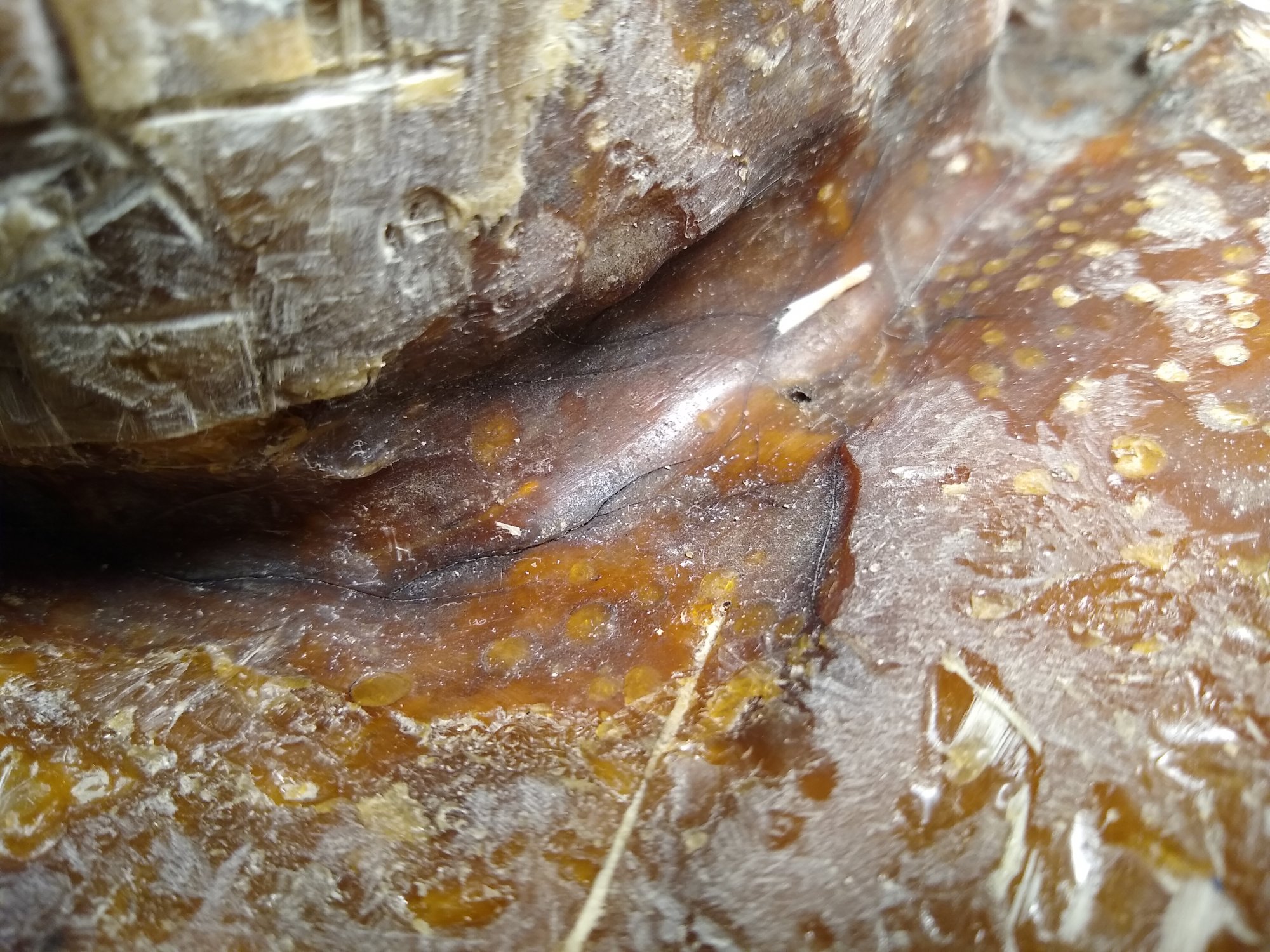

I removed my rudder and this is what I found.
The lower bushing is made from the same Delrin material as the upper bushings and it measures approximately 6" tall. It is my suspicion that the leak is migrating around this lower bushing and through a unseen crack or opening within the tube behind the pocket the bushing sits in.
As you can see in the pictures the bushing seams to be held up in place with a fiberglass plate of sorts. This plate measures about 1/4" thick and I'm sure the hull is thicker than this plate. I can insert a feeler gauge in between the plate and bushing almost an inch. I feel no screws with the feeler gauge while probing.
