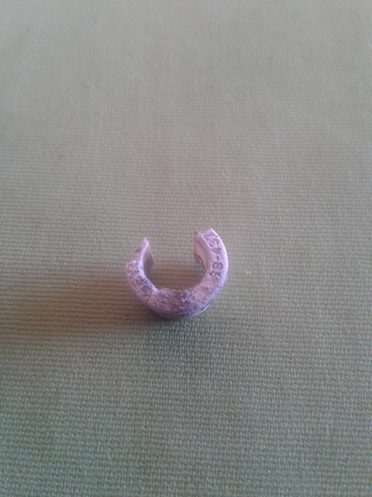

Looking closely at the picture I could make out most of the part# and some of the manufacturer name. A little help from Google and it looks like it is a Heyco SB437-5. Now my problem is what to do with the extra 238 since they come in a package of 250.

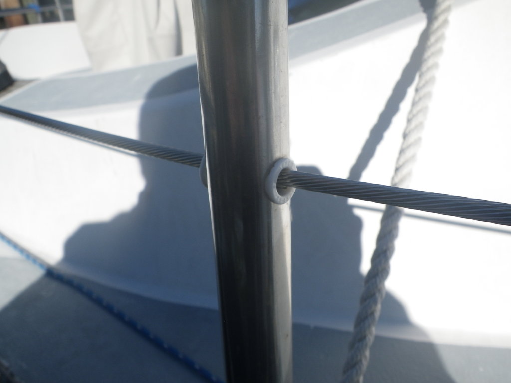

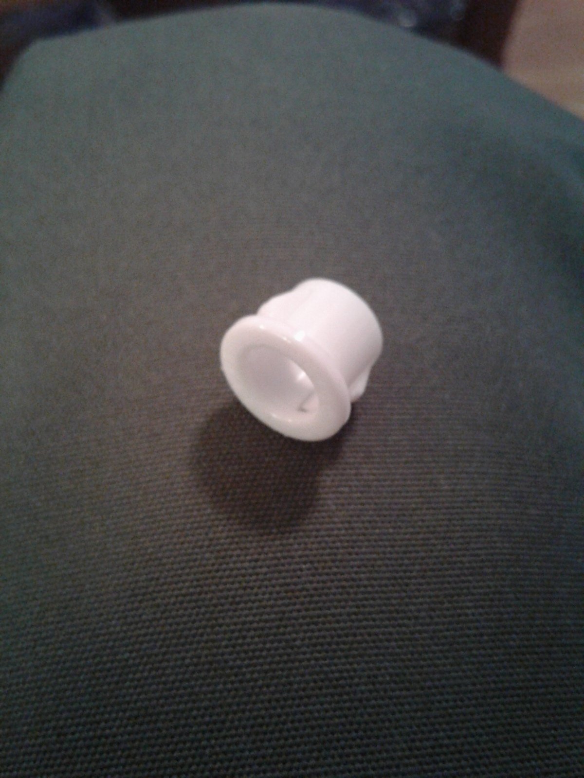

Yes there is one on each side to protect the line from the sharp edges on the hole in the stanchion. The original ones were all destroyed by the sun. Below is a picture of one of the new ones.

Are they split and push in on both sides? I don't have any on the Hunter.
Justin_NSA, I only had the broken part of one on my 1982 Hunter 30, see pic at beginning of this post. All the rest had crumbled and disappeared.

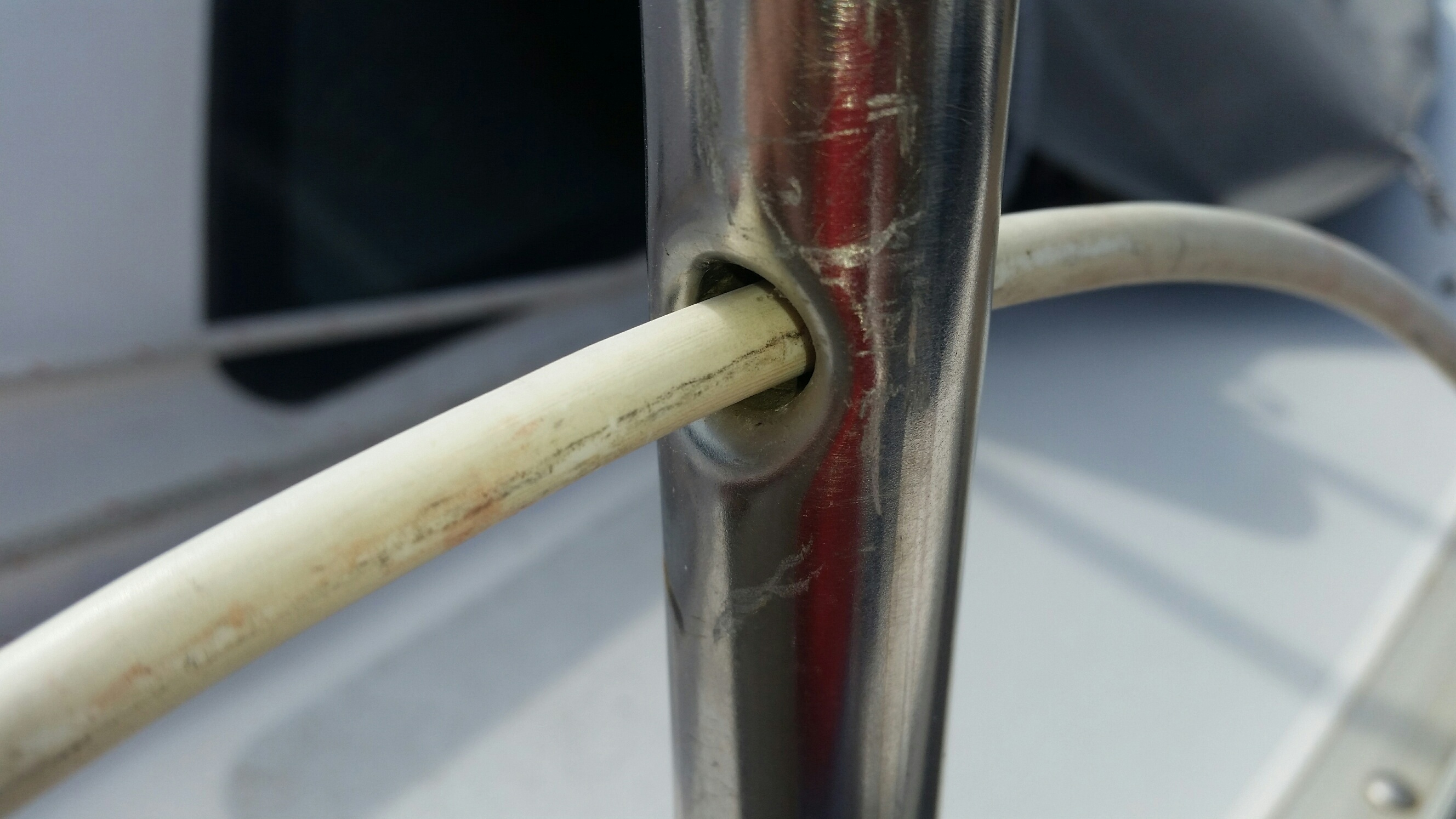

This is my setup. The lifelines are coated end to end. Seems like the grommets might protect the coating if they would still fit. May be too tight though.

The holes in your posts look like the were punched causing them to be rounded inward. The holes in my posts were not rounded so they were sharp and they chaffed the coating off the lifeline and were starting to wear on the wire. I don't believe you need the plastic bushings and I don't think they would work because they need the edge for the retaining clips.

Thanks for the observation. One less project. I've been counting that various hatch "bumpers" in my cockpit area that need replacing. There are 3 height sizes throughout. I need to make a final count and order them from the SBO store
