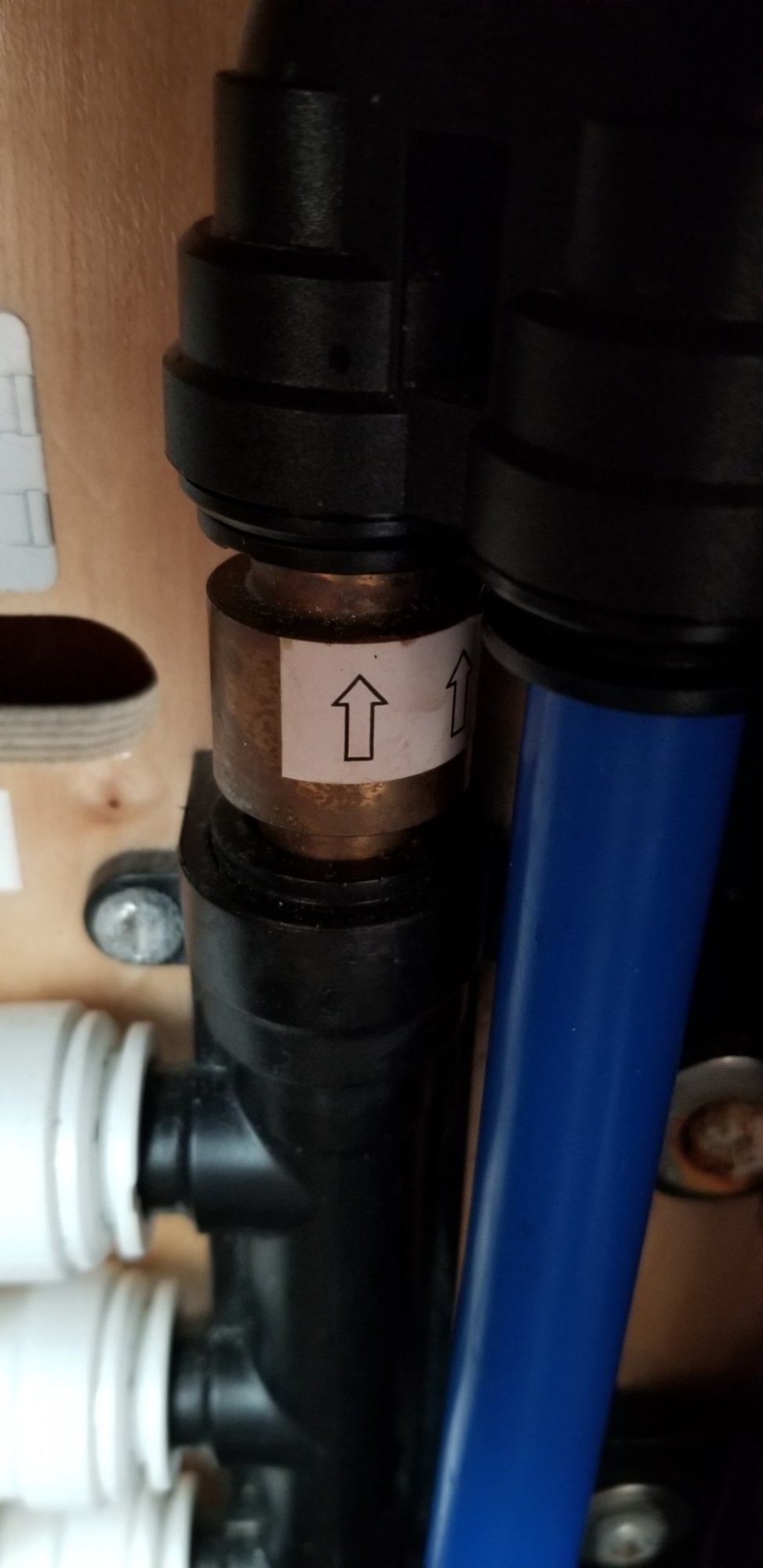

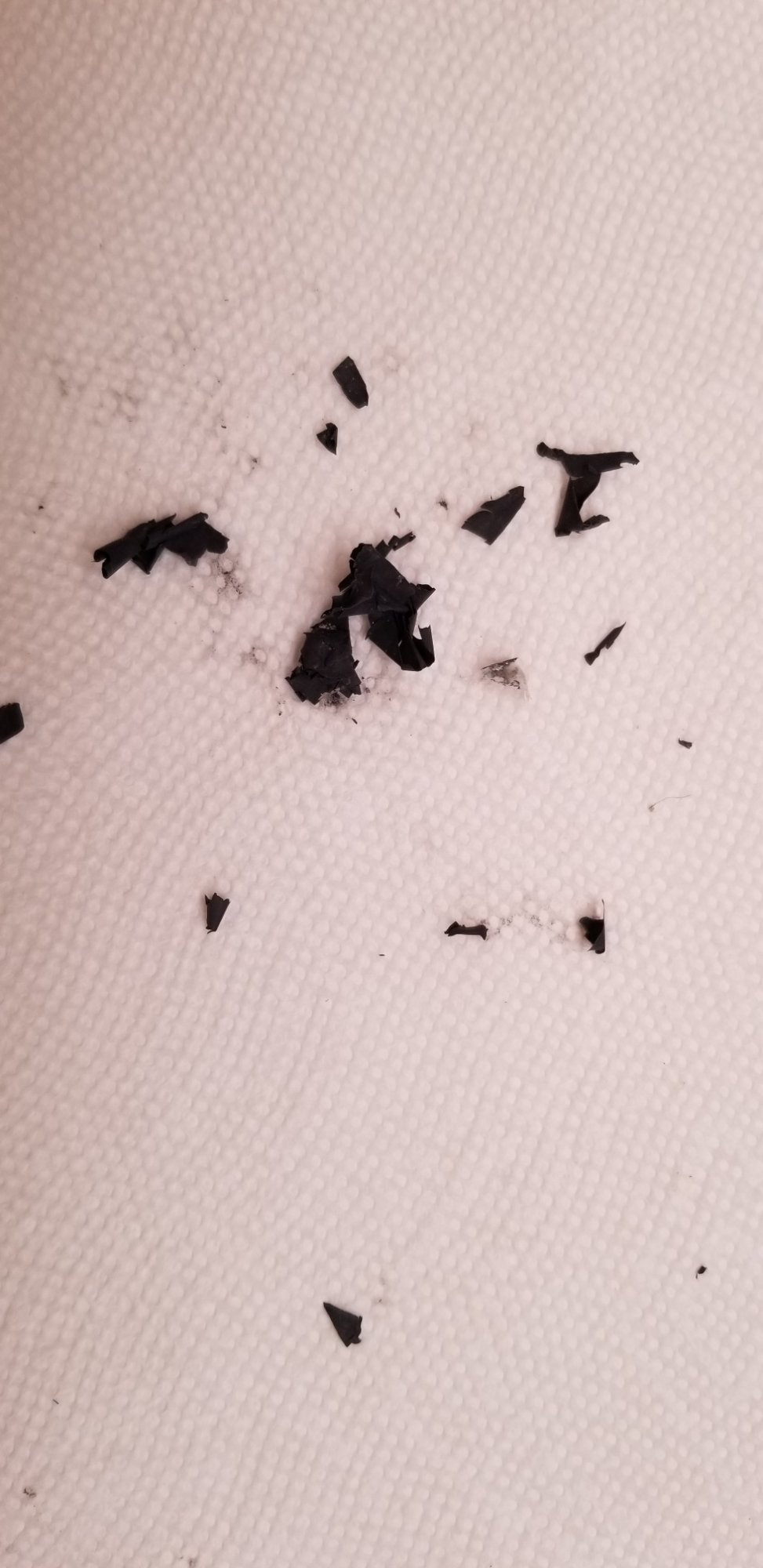

I found the problem.
Turns out that when disconnecting and inspecting the fresh water check valve I found just enough debris (black thin plastic tape like material) to slow down the flow!
Cleaned it out and the water pressure is back to normal.
