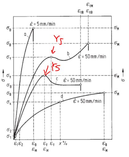

If, like many cruisers, you set the luff tight and forget it, there will be NO STRETCH unless the windload exceeds the pretension you set. No difference Amsteel vs. polyester vs nylon. Obvious? A 200-pound pull will not stretch a line that was pretensioned to 1000 pounds. The load on the cunningham will go down to 800 pounds, but the line will not stretch one mm.
@thinwater I'm not following exactly.
Here's a graph of several different polymers. When you preload, you are simply moving up the graph on the left hand side of the graph prior to the yield strength loading level.
The more vertical that initial section of the graph the "stiffer" the material is. The less the elongation per loading, the more vertical that initial part of the graph. But even with brittle materials there is still a very small measurable amount of elongation. Brittle materials tend to not have any of the curve related to the curve after the yield strength, they simply break at the yield point. This is shown in the graph above for a brittle polymer where you see the circle indicating fracture in the far left hand curve.
The materials being discussed in this thread fall in the region of the two middle graphs. The lower graph is for a highly elastic polymer.
However, with preload or no preload, there will still be very small amounts of movement - not 0. At least that's how I understand it.
dj
Say the halyard is tensioned to 1000 pounds. You increase mainsheet tension 200 pounds. The tension on the halyard at the masthead is still 1000 pounds, and the tension on the length from the masthead to the deck is still 1000 pounds, but the load at the tack is now 1000-200=800 pounds. Thus, the length of the section from the masthead to the deck will not change because the tension has not changed.
Your graph is correct. The trick is that the tension on the line at the masthead has not changed. The same with a cylinder head bolt; when the charge goes bang the clamping force goes down and the nut load goes up, but clamping+nut=bolt tension and the bolt does not loosen or stretch or fatigue.
As I said, if the halyard is loose, to move the draft aft etc, then the halyard will stretch. But only if the pre-tension is exceed. Walk through the elongation and stretch and I think you will see this is how it works. Engineering, deformable bodies 101. Since most cruisers never adjust halyard tension, they just set it for windward, stretch is not a serious problem. If they do not pretension, well, then you are correct. It all depends on the amount of pretension.
(If you want to test this, set up a polyester halyard for mast climbing. First do it semi-slack. It stretches when you weight it. Then get it bar tight. Zero stretch. A common mistake for rope climber system users.)
Perhaps I'm being a bit dense here, won't surprise me.
I'm not thinking of a main sheet halyard but rather a fore sail halyard. The fore sail does not have a sheet that applies downward pressure to the significant amount as a main sail does. So when loading your fore sail I'm not seeing how you aren't getting an additive loading on the halyard. Hence, having a stiffer halyard can be advantageous. If you can show me that, I'd be most appreciative.
