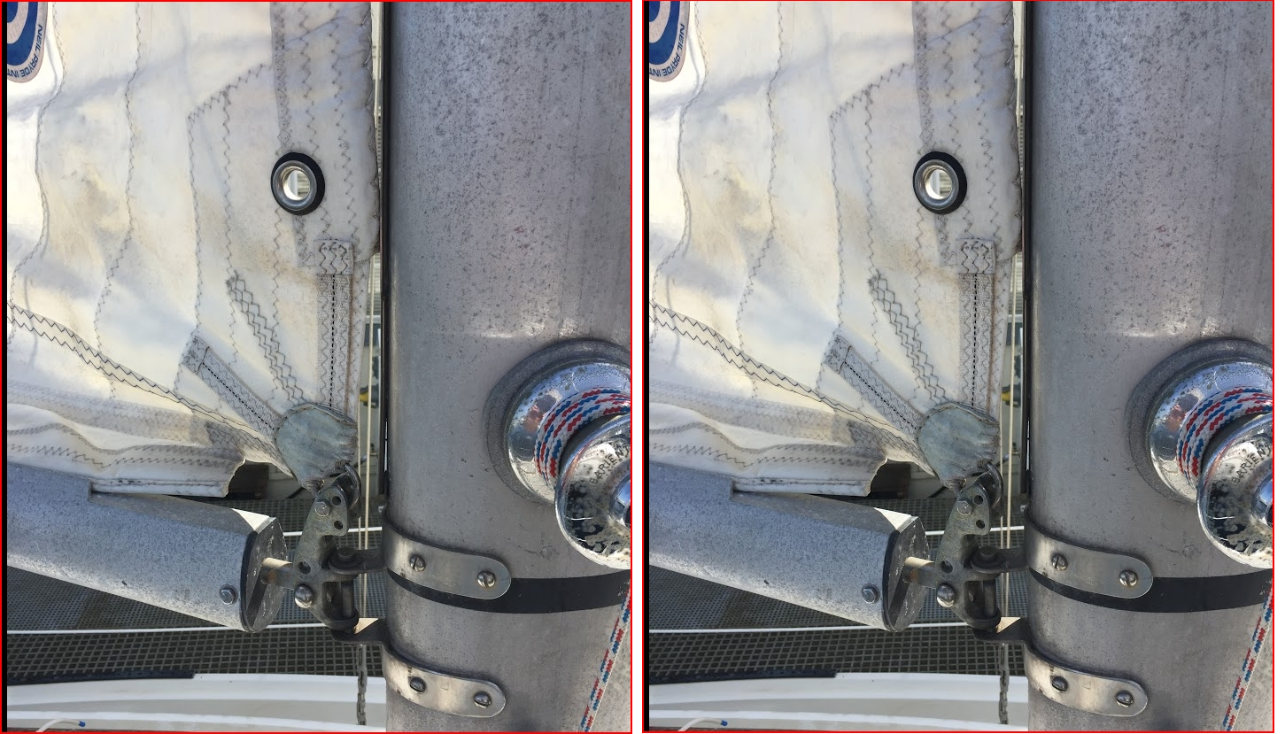

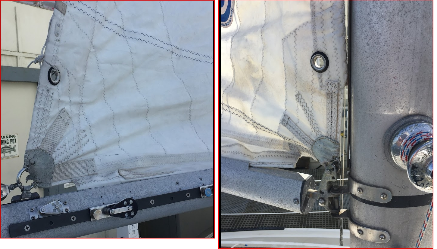

I realize I messed up the photo. Here is an update.
I think I understand the hole now at the tack, but the clew hole - how is it used?
7,719
It is a flattening reef. Sometimes you only want to take out some of the sail's fullness, the flattening reef does that, it pulls the shelf into the boom and reduces draft along the lower part of the sail.

I think typically found only with mainsails with the shelf (bolt rope in the boom track), no?
5,983
Slickcraft 26 Greenport, NY
The last time I saw one of those was on an Olson 40 - thirty years ago. It was very effective. It could make that main flat as a piece of plywood. I don't think the flattening reef lived past Dacron sails but that is conjecture. You could contort Dacron sails into various shapes. Laminate sails are largely the shape they are.
As for the question on how to use them: I think you'd want tension on both the luff and tack. One loose and one tight would seem to me to stress the sail.
Likes: FastOlson
Apr 5, 2009
1,562
I had a C25 with a flattening reef and used them independant of each other. The tack was used for the Cunningham to tension the luff and the clew was used to pull the belly and draft out of the foot just above the foot shelf.
