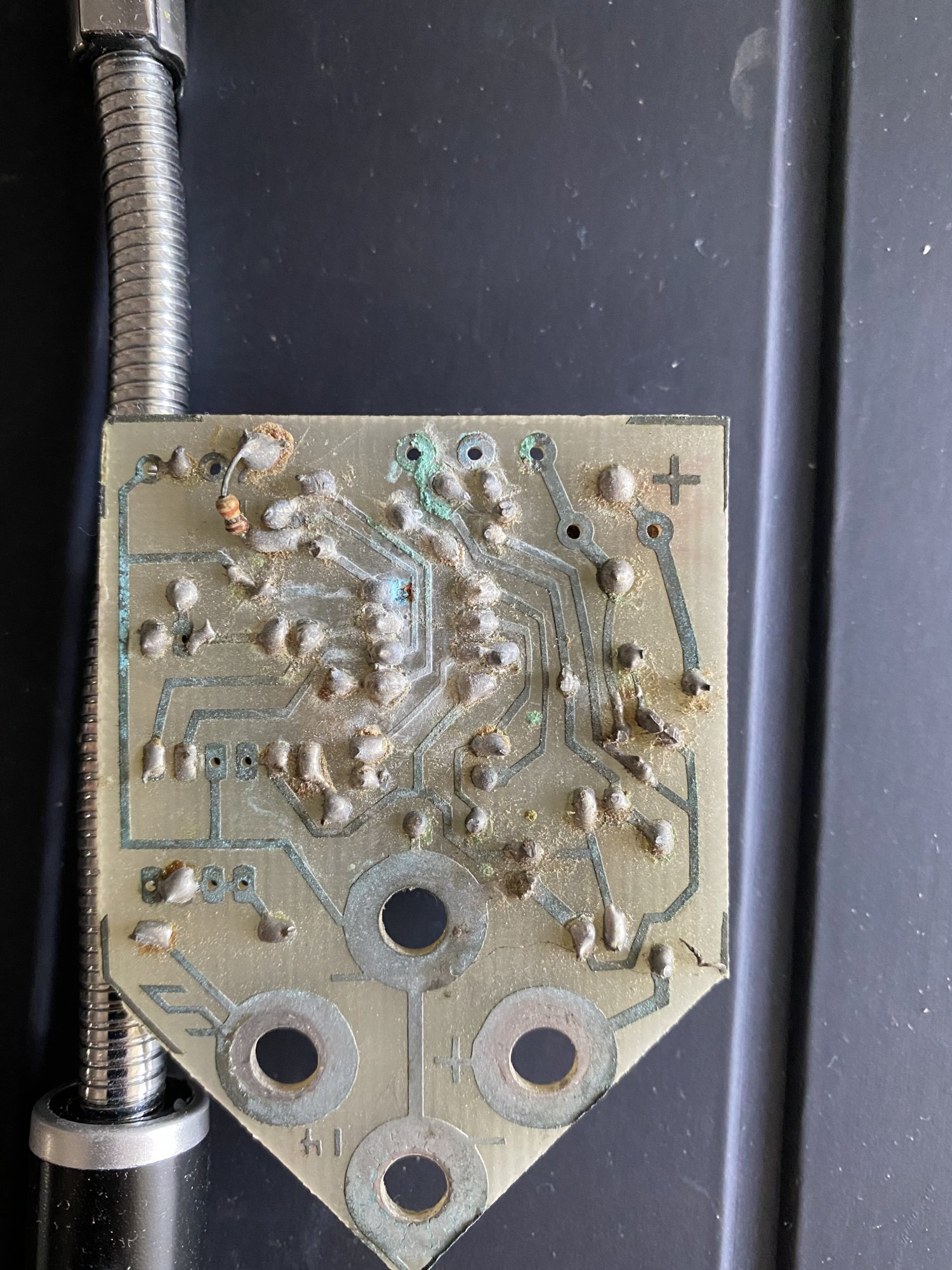

Most likely it’s the alarm circuit board going bad. That board is behind the cockpit engine panel and sounds the alarm for either low oil pressure or high engine temp.
The board on my boat went bad last season, having the same symptoms you are describing.
That board is no longer available. I replaced it with a new two tone buzzer. I bought it from Catalina Direct but I’m sure there are cheaper sources.
To retain the high temp alarm I installed a high temp switch in the thermostat housing. On my M25 XP there was a plug in a spare port next to the temperature sensor in the T housing. I believe I bought the switch from Amazon. The one from CD requires a funky connector.
If your engine doesn’t have the spare port you can drill and tap for one or buy the new t- stat housing kit from CD.
I connected the oil pressure switch wire to one side of the buzzer and the high temp alarm wire to the other side.
Now one tone of the buzzer is the high temp alarm, the other is the low oil pressure alarm.
Here’s a photo of the back side of my alarm board.

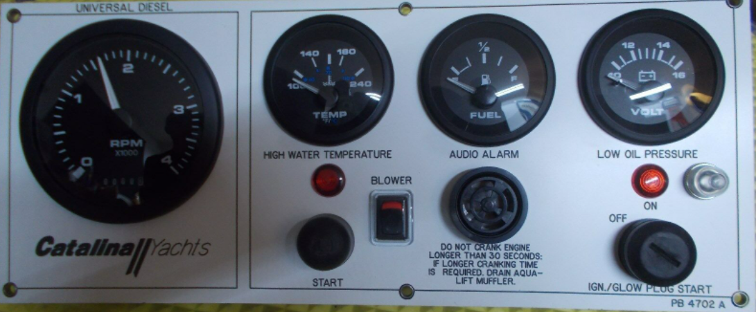

Wow, didn't know there was that much complexity for the indicators. I figured it was just a sounder and light connected to the ground via the oil pressure switch. I don't know that mine has an alarm for high temp. At least I don't think so.
My panel looks like this: (not really mine, just online found pic)

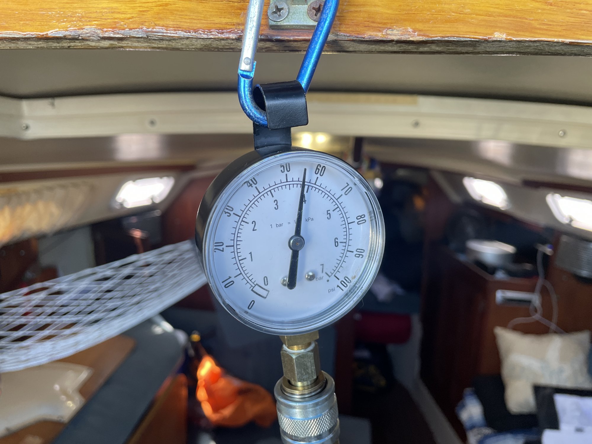

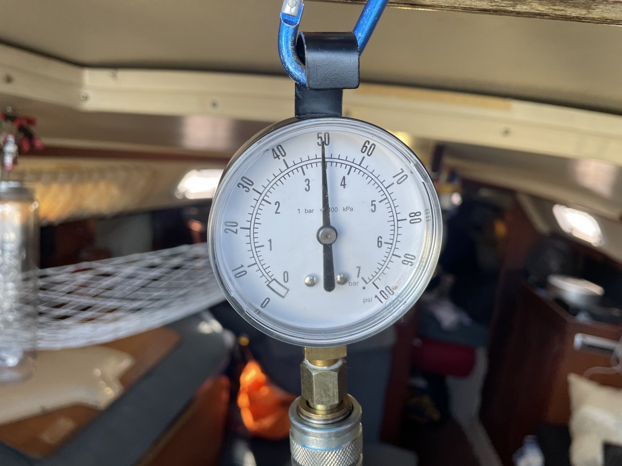

So, good news… my oil pump isn’t bad.
bad news is I have a new wiring project.
pressure at full cruising rpm and idle both stable at full temp.
and while the pressure switch was out and the wire not touching anything, I could still hear the faint beeps from the sounder. When we touched the wire to the engine, it went loud and the light comes on as expected. At this point I’m assuming the multi pin trailer harness is the problem. It’s cracked on both connectors at the engine side and looks like crap. My first step will be to get rid of that and replace it with a waterproof terminal block housing then see if everything is cleared up. At least now I know for certain the engine is okay.

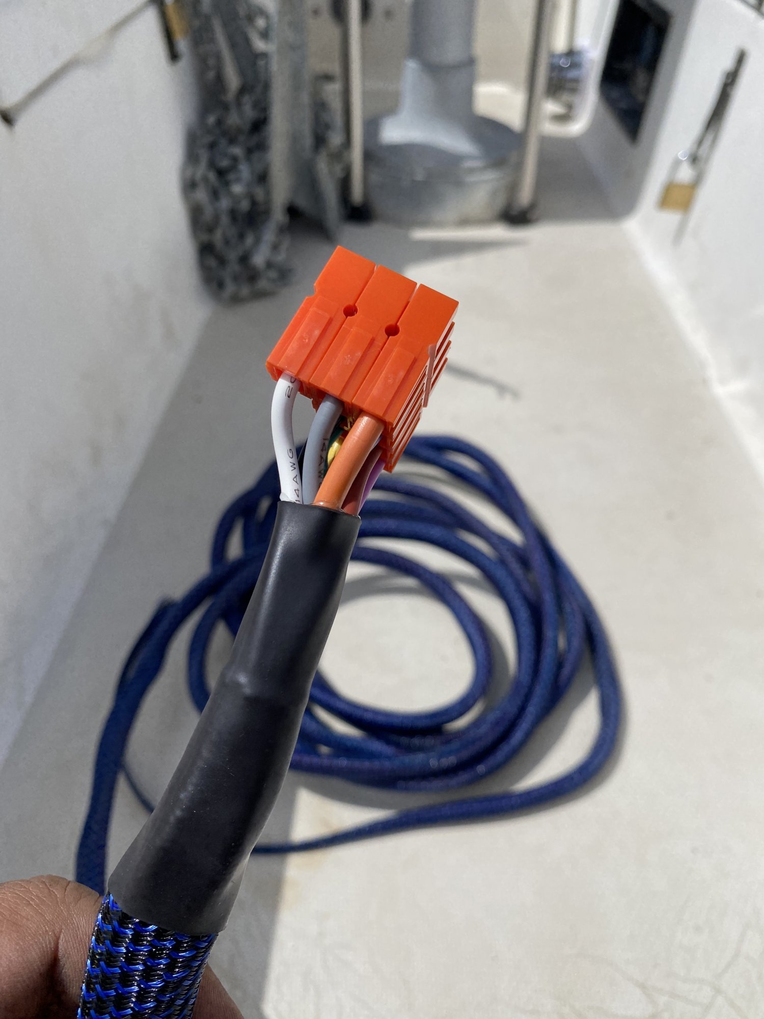

Here is my engine harness on the panel side.
Jun 2, 2014
606
Catalina 30 mkII - 1987 Alamitos Bay Marina, LB, CA
@jonelli
Many of us have been "harping" on those trailer connectors for years. Surprised you hadn't gotten the memo. :)
Here's some other stuff you should be aware of, too, applicable to your boat with identical systems to our C34 boats:
Critical Upgrades CRITICAL UPGRADES - DO THESE OR ELSE!!!
Hey Stu, yah, I hadn't really had any issues with it till now, and most of the warnings on the common critical issues were pointing to things I didn't have. I have the late 87 mkII with M25XP. I don't have the Ammeter setup, the oil sensor isn't through the fuel pump, the alternator bracket is on it's own bracket like the upgrade kit, and I've already upgraded the main charging system wiring. I'm not sure about the traveler through-bolts though. I'll have to check next time I'm at the boat.
For now, I'm going to replace the engine compartment connectors with this:
