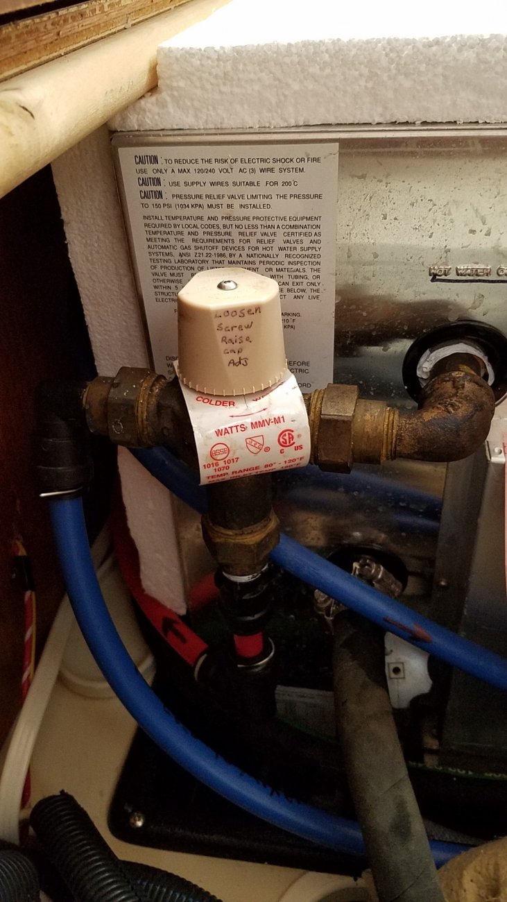

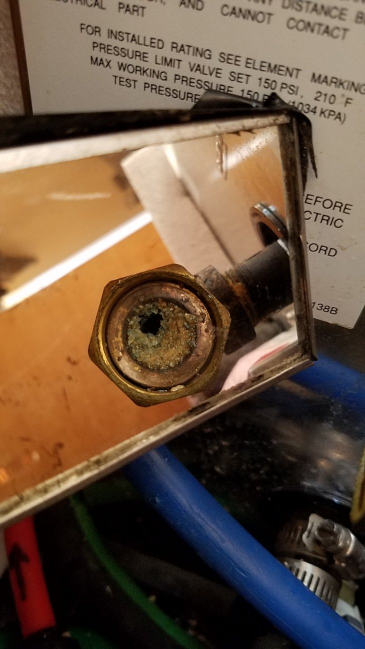

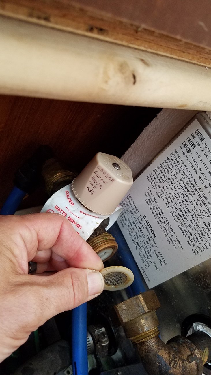

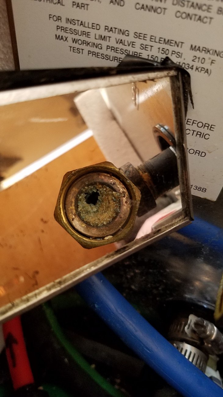

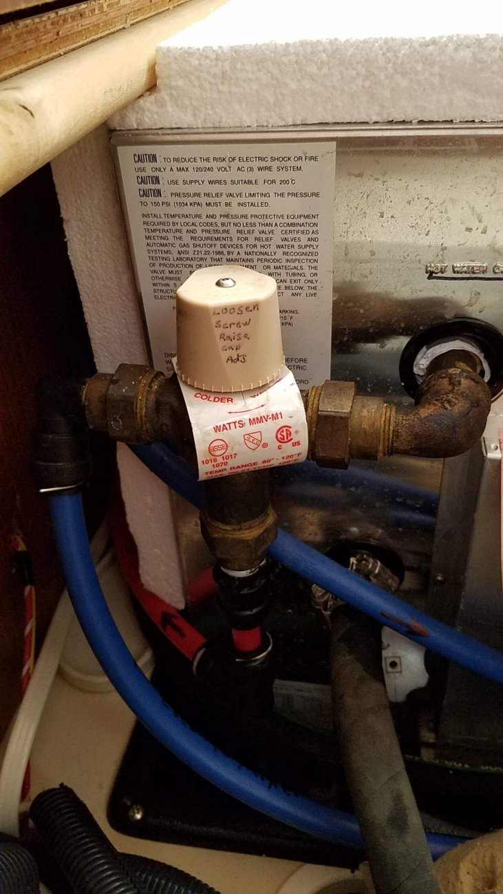

I have a 2007 H36 and had the exact same issue In the spring.
The culprit was the thermostatic mixing valve. Some crud had accumulated on the input screens for it - I disassembled the connections to it (didn't take the valve guts apart !) - there were fine metal mesh screens that had crud on them.......cleaned screens, put it back together, and presto - lots of hot water flow again.
Hope this helps you!
Paul
Historical forums what a great thing! This post dated back to 2013 certainly did the trick for me.
I have a 2007 H 41 DS and at start up of season 2018 I noticed a drop in hot water pressure and a further decrease again this year now down to a trickle. Thanks for posting PKFK. I didn’t know there were screens in the mixing valve, but it make since to protect the valve, and that was the problem. From the looks of the screens (only 2 screens hot & cold inputs not on the mixed hot water out) and orifice I’m surprised I was getting any hot water at all. I cleaned out all the debris and presto I have hot water pressure again.
P.S. On this model valve once you loosen and back off the coupling there is a good chance the screen will drop out and some how find the most difficult to reach part of your bilge.
I’ll try and attach some pictures of the mixing valve, screen and it’s assembly.
