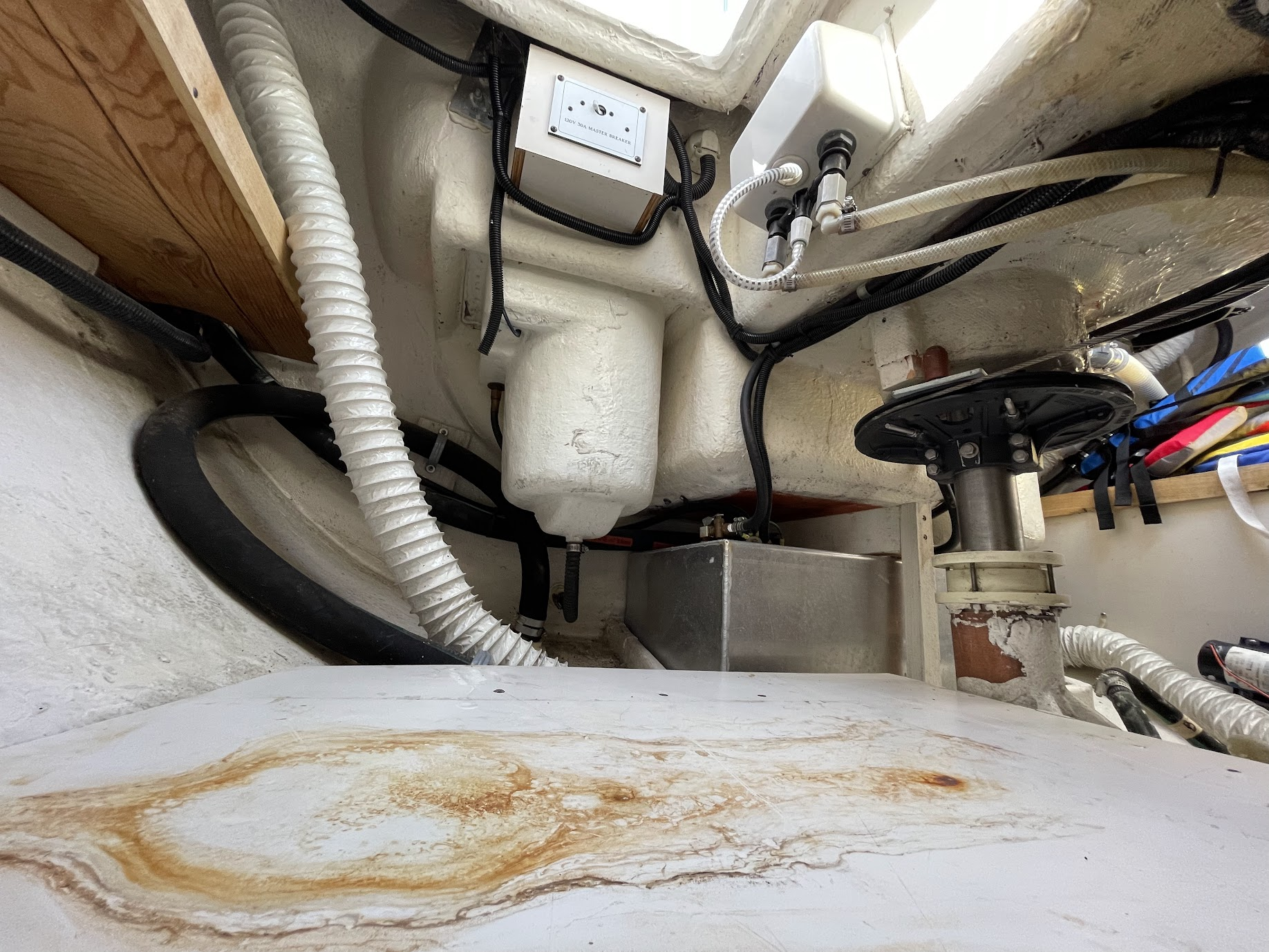

I'm new to servicing the fuel system and have read a fair bit on the topic, but had a problem recently that I think is fuel related and want to confirm. We left for a 4 hour trip that was going to require motoring most of the way due to the winds. Engine seemed fine the first 20 minutes out of the harbor, then while motoring at 1/2 throttle the engine started stalling. RPM dropped from 2500 or so down to 1000 or less. Moving the throttle more open had no effect. At time the engine sounded like it was going to completely die. This went on for a a few minutes. I'll note the there pretty good swells causing us to toss around in the direction we were headed. We got a tow back to the marina where we started to figure things out. The engine Universal M25XPB has never had this issue in the past that I've seen.
Diagnosing things, the fuel pump seemed to be working. If I opened a bleed valve on the engine, fuel would come out with it on. However, the water separator drain valve seemed blocked. I loosened it a few turns but would only get a drip out of it? Another pic shows green slime in the bottom of the bowl. Uh oh I thought. The filters have not been replaced in the past few years, but I do have replacement on hand. This was probably the first season where the boat had a 3/4 full (or so) tank over the winter season instead of full. I'm thinking that led to issue.
Do you agree and if so what's a proper procedure to clean up the system? Also, I can't tell from the pic of water is in the bowl?

After reading Stu’s notes about the check valve, I would replace the fuel filter (not familiar with the canister type…can you see how plugged up it is?)….
If you have an inspection port in the fuel tank, I would open it up and get a look in the tank to see if you have a bunch of junk in there.
Some people have had problems with a screen over the fuel pickup tube, and getting junk it the screen (particularly in conditions you described where any gunk in the tank gets stirred up). Solution there is to pull the dip tube and remove or clean the screen.

I was unaware of the check ball assembly on the primary fuel filter, but I do see the slotted screw-type cap on top of mine in the same place.
So I'm thinking:
shutoff fuel at tank
remove primary filter bowl and filter, clean the bowl and replace with a new filter
clean out that check valve
replace the secondary fuel filter mounted under the engine
reopen the tank shutoff valve and bleed the system at the point after the secondary filter
confirm the throttle cable is securely tightened
I'll note, my symptoms are similar to those that posted. I've also seen it where it will run at idle in neutral, but as soon as I engage the transmission, the rpm dip below 1000 rpm. So a restriction in the system seems to be the culprit. Not sure on the 310 if there is an access panel on the fuel tank, but I'll look. If I remove the intake tube from the fuel tank, what material is used to reseal that when you replace it?
Looking at the old pic I had of the tank (without the water heater installed), I see the shutoff valve there but not any way to remove screws or dip tubes?
thanks all!

We’ll that didn’t work. I completed everything in that list above and it will only run for a minute or less and die. Didn’t find anything in the check valve. Looked pretty clean. I bled the system until the air was out. Did that at the secondary filter and at the bleed point after that filter. Weird. How do you know if your fuel pump is bad? Mine makes different clicking sounds at different pitches when starting it. Like maybe fuels flowing and then not. It’s definitely louder than it used to be.

Looks it would be tough to get the pickup tub out without moving the tank. The fitting may unscrew from the tank and the dip tube would come out with it.
but no clearance under there…
try all the other things first :yikes:

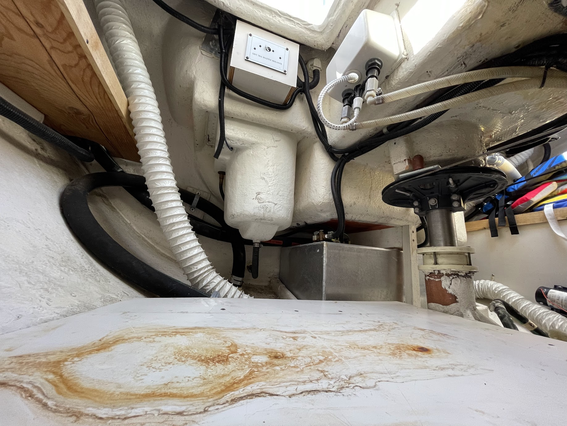

So I had the service shop look into the matter. It seems it might be a combination of things, but the main culprit was a bad oil pressure sender which had been replaced a few months ago as part of my request to get the low oil pressure alarm working. They couldn't do an extended engine test at the time as the boat was on the hard. Apparently that replacement sender was also bad and that combined with something about the fuel pump wiring being "wrong" were the cause. I'm aware that a second low oil pressure switch is in line with the fuel pump, but I didn't hear that the fuel pump or oil pressure switch was bad. It all seems to work just fine now and have used the boat twice since with no fuel starvation issues.
Thanks everyone for the assistance. You're all the best!
Pic of new wiring. the yellow wire is "new". I assume it goes to the oil pressure switch, but didn't look under there yet. I wonder if they ran a new wire back to the admiral control box for the oil pressure alarm? I didn't get a lot of details, but heard it took the better part of a day.
