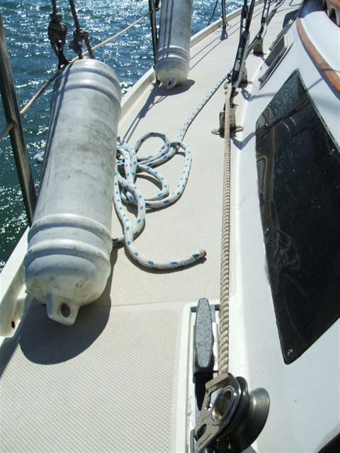

jibes, you already have two absolutely zero cost winches on your boat. They're called jib sheet winches. I agree with Ed that for our boats hauling by hand is not impossible, unless there are back injury issues, heavy winds or a stuck anchor.
If there was a recurring back issue, I'd buy a dedicated electric windlass.
For the others, I reeve a line through the jib fair leads to the anchor rode to the jib sheet winch and haul away. Have done this maybe three times in the last 13 years.
