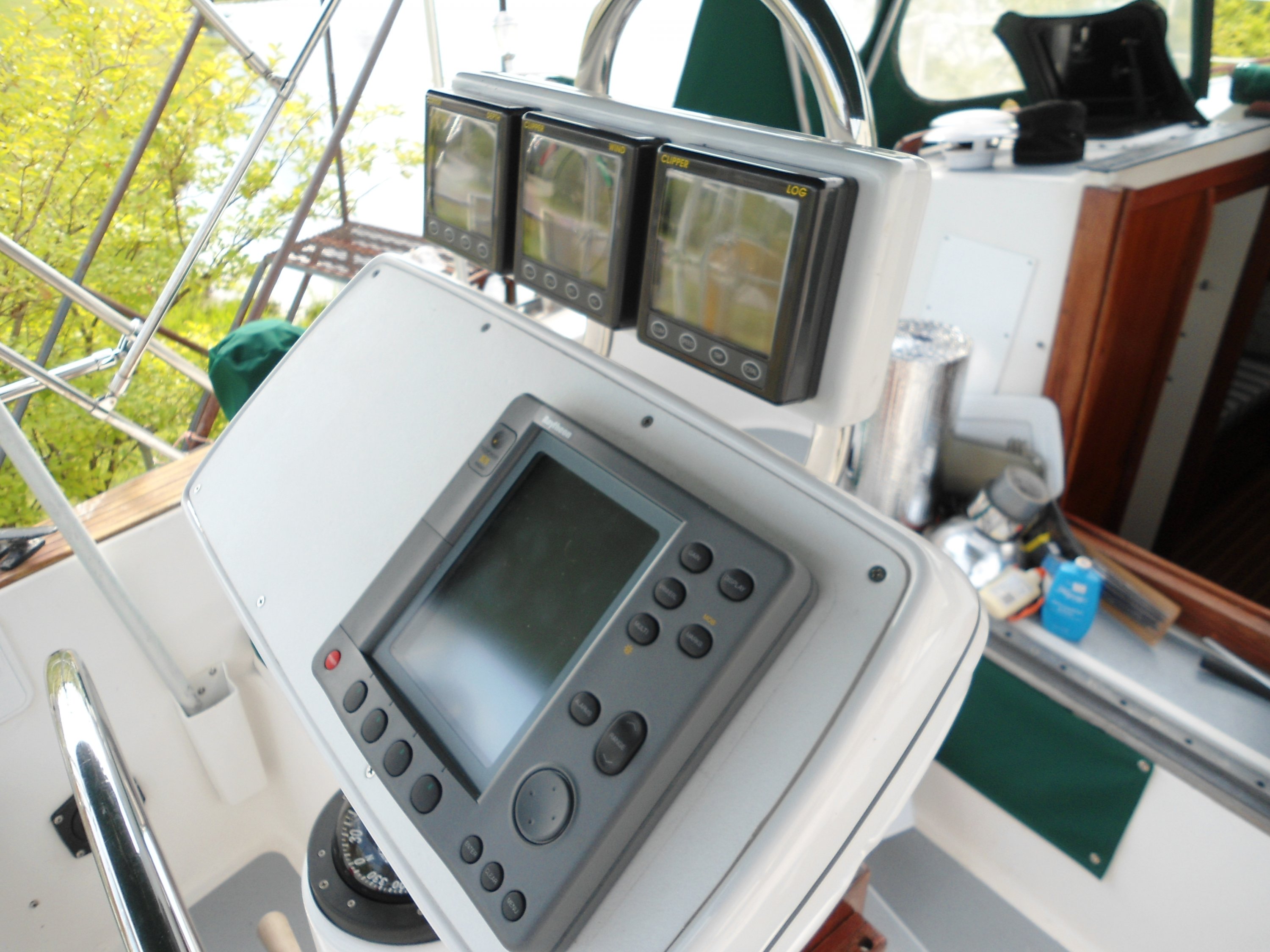

I'm trying to figure out a way to install an instrument pod for my pedestal, but the $400-$500+ for a piece of fiberglass is really giving me heartburn.
Anyone have any thoughts on low cost alternatives for mounting instruments at the steering position?

You could always make "pods" out of wood - either teak or ipe put a nice oil finish on them, or do plywood and cover with fiberglass - and autopaint.

I like that table - perhaps that's a good solution. I have a big piece of Starboard that a generous person donated to the cause.
The plywood/fiberglass solution is also a good idea. Still thinking!

I will be making my Maine Sail version of the chartplotter pedestal guard mount. I like the fact I can adjust, unplug and remove easily. Navpod should be ashamed to charge $500 for a fibererglass box. But sailors keep buying them.....oh well!. A fricken box shouldn't cost almost as much as what you put in it! Heck, I bought a complete Force 5 boat and trailer for less than Navpod wants for a stinking tiny box!

for less than the cost of a $500 navpod, you can buy a sheet of ABS and you can build your own... and have lots of material left over for cup holders, binoc holders, accy shelving and many other useful but expensive items... 1/4 or 3/8 material and some #6x1 or 1.25" stainless screws... the ABS works, cuts and sands similar to soft wood.

Purchased the largest navpod I could find for 100 box on ebay. Added a new 1/4" kingboard face and recut for my instruments. Works for me
