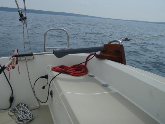

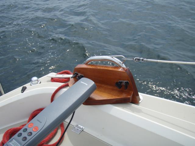

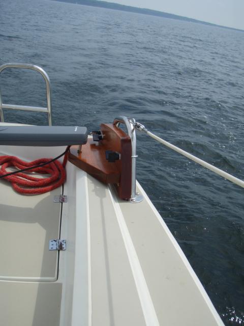

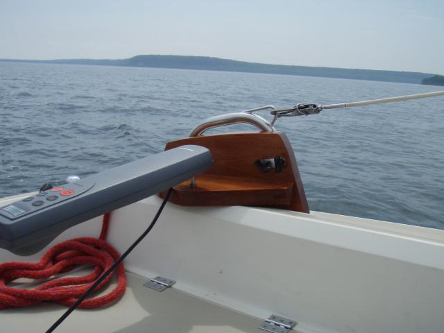

Anyhow, the installation was pretty easy with the only issue being how to mount in on the coaming so that it was level when attached to the tiller. I had bought the appropriate extension but hadn't purchased the pedestal that was needed to make it level. So I built mounting device that quickly attaches to the railing at the stern. I actually borrowed the design from Chuck who sails on Lake Erie and who posted his design a few years ago. My mounting platform is just a couple of pieces of maple attached with a 1 foot piano hinge, and then a couple of u-bolts that hold it in place on the railing. It works great, and I'm now a true believer. I've bought quite a few little gadgets for the boat over the years, but outside of the CDI roller furler, this has got to be my favorite.
I've attached a couple of pictures for those who might be interested. By the way, these photos are off Peninsula Park in Door County.
