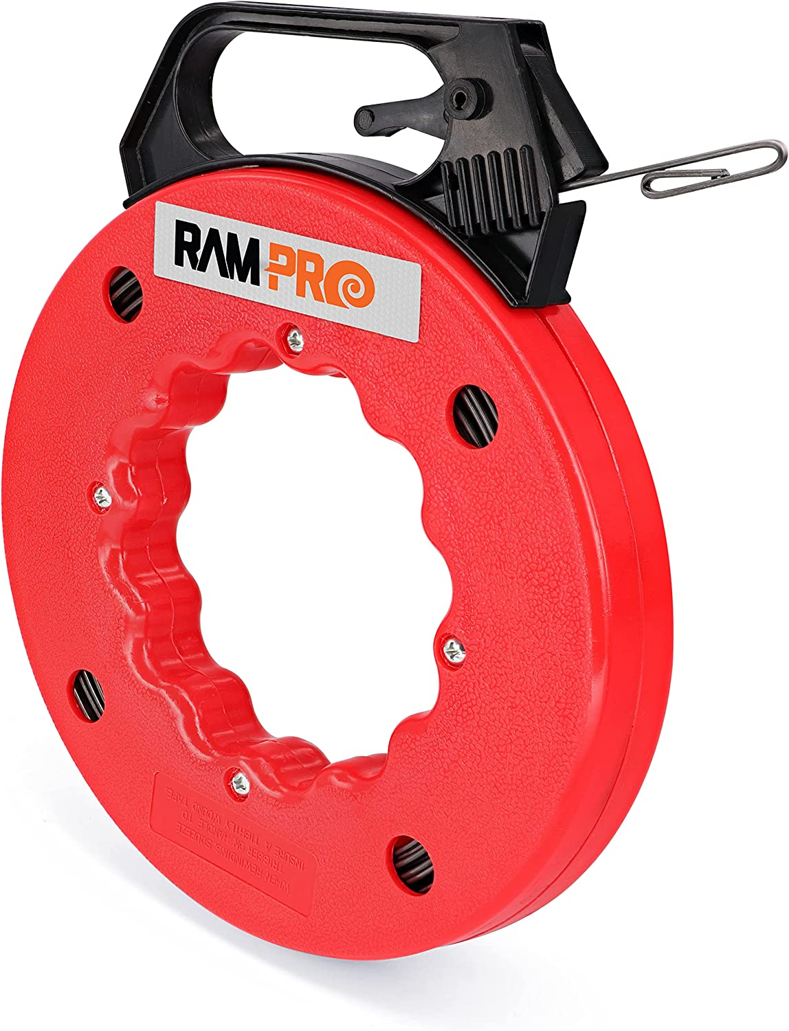

You can use an elecrician's snake to feed a messenger down and then pull the halyard through.

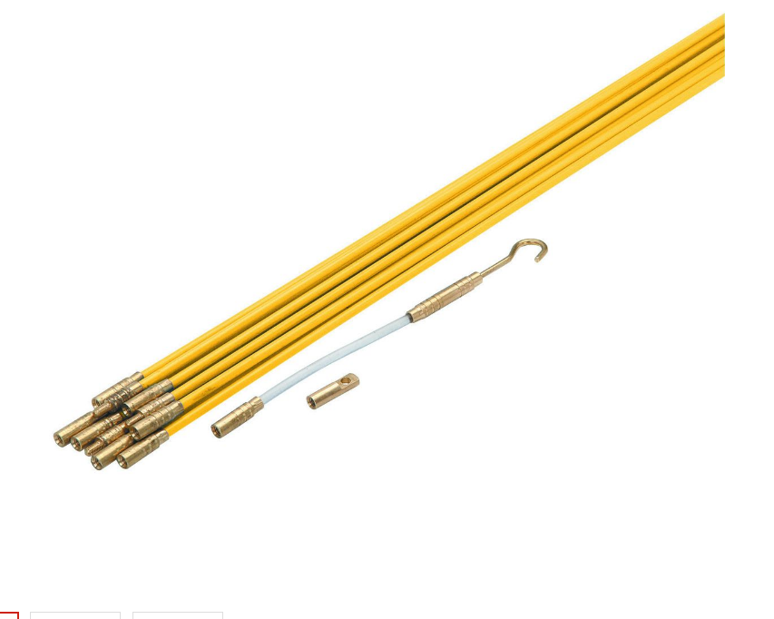

I lost my genoa halyard into the mast. A friend offered to go up the mast but was unable to drop a messenger with a few nuts for weight. Ended up going to Harbor F and buying three sets of their wire running kit (11" screw together fiberglass rods) And ran the messenger up from the bottom inside the mast. Then went to a marina yard and they hoisted a mechanic up to fish out the messenger line. an other alternative is to use a 6" piece of roller chain as the weight. It tends to rool around obstructions.

If I had a 20' boat I'd drop the mast. It's possible to do it by hand without anyone's help. I would suggest making an X out of 2x4's to support the mast and tie it onto the stern railings. The gooseneck may touch and damage the cabin top without it. To get the mast back up, I'd suggest help of a friend or use the mainsheet to aid with the tougher parts. At some point you'll have to step onto the cabin top. You'll want something to support the mast at this point.
For a larger boat I would use fiberglass rods like @RitSim suggested. The Harbor Frieght one I bought a couple months ago is garbage. The ends come off really easy. Hopefully I just got a bad one because they used to be OK.
Anyways, I'd loosely tie one end of the stick to a halyard that goes up the mast with a foot sticking out and the other end would be tied/taped to the halyard you want to re-install. Tying the stick to the existing halyard gives it some stability and allows it to actually get to the top of the mast. These sticks bend quite a bit under their own weight. Harbor Frieght ones are skinny enough that they might actually be able to go through the sheaves at the top of the mast with the halyard taped on. Klein and other more reputable brands are stiffer but thicker
