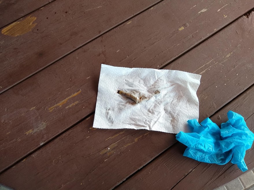

I was about to pull out of the dock when I noticed my engine sounded different. I looked over the side and saw no raw water was coming out of the boat. Closed the sea cock and checked the strainer, fine. Then pulled the hose off the sea cock and found this, a fish, nicely cut in half. I then had to open the sea cock and "fish" out the head. The guys at the club said I better get a fishing license before NY finds out about my illegal fishing.

That happened to me a few months ago! Except I didn't notice the dry exhaust quick enough and needed to replace the muffler due to the damage. Good "catch!"
