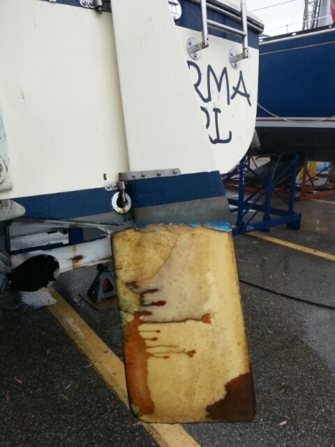

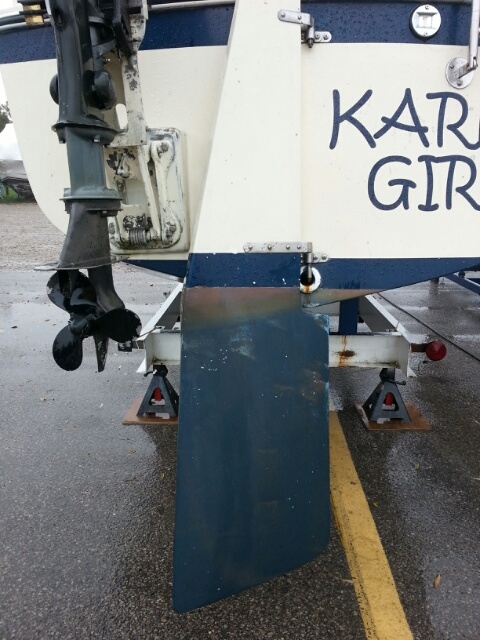

Afternoon all! Look what I noticed when my Karma Girl was hauled out of the water for the winter last weekend..... I have absolutely no idea how this happened????? I didn't hit anything, I always lash it to the tamer in place and there are no chains, blocks, or hazards near my slip. Only possibility was the last race was a bit windy and the rudder was working pretty hard against the heel. I have no idea where the scabbed off peice went either. Now,... can it be repaired or must it be replaced??? These pics show on side and then the other of it at the same time

I believe that the construction of these rudders is 2 halves, mated, and filled with foam.
So, if there are any cracks in the edges where the halves are joined, water can infiltrate, and freeze/thaw cycles can make it worse. I can imagine one half being forced from the foam interior, and breaking off as yours seems to have done. You may not have felt an outrageous difference in tiller feel if the foam maintains the foil shape.
You could potentially re-skin that side of the rudder provided the foam still retains the foil profile. I don't know that I would want to get too far into that project, though...
Check with Rudy at drmarine.com to see if he has a rudder for your boat, or can recommend a replacement. It won't be inexpensive, but only you can figure the value of your time, while considering your proficiency of a glass/resin layup like that...

Ok, thanks for the inputs... I am trying to sell her anyway! Hard to sell a boat with a rudder like that! I have a good glass guy at my club so going to pin him down for a quote and try to find a replacement and make the decisioon then...
BTW Brian you are exactly correct with the construction of the rudder
