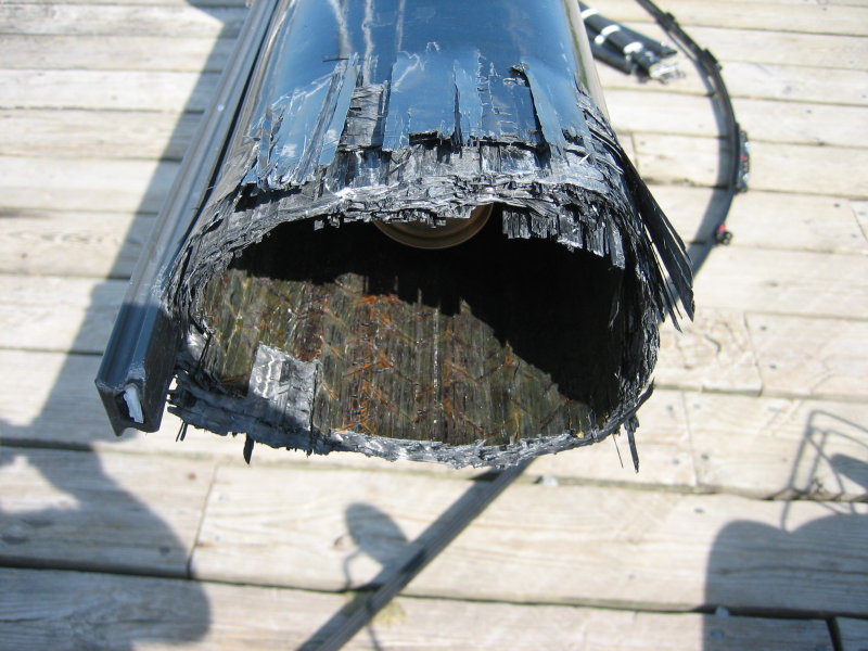

Below is what happens when you lose a spreader under sail.. This one happened to cost about 40k to fix because it was an expensive carbon rig. Lose the rig on your boat and the insurance company will total it..
This was caused by a spreader failing.
