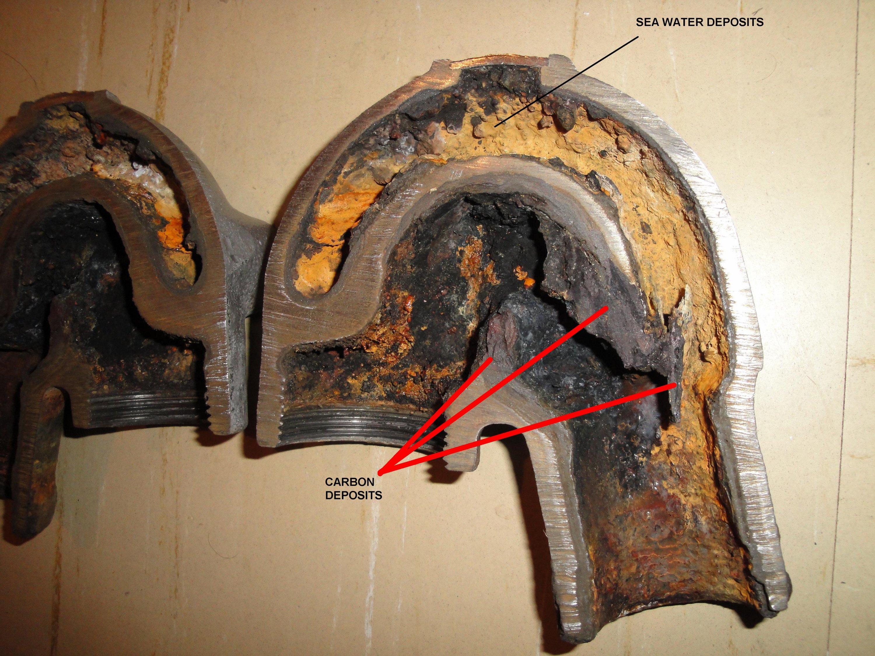

Easier to remove mixing and exhaust elbows for checking.
Seems pretty common for yanmar engine to foul mixing elbow.
Do a search on this forum and you'll find photos showing how bad the fouling can be.
Jan 4, 2006
7,870
You mean like this one .......................
I chopped this one up at about 4-500 hours. I show no smoke under heavy load but still seem to suffer from excessive coking since the engine and boat were brand new. All the usual engine operation and maintenance tactics as well.
