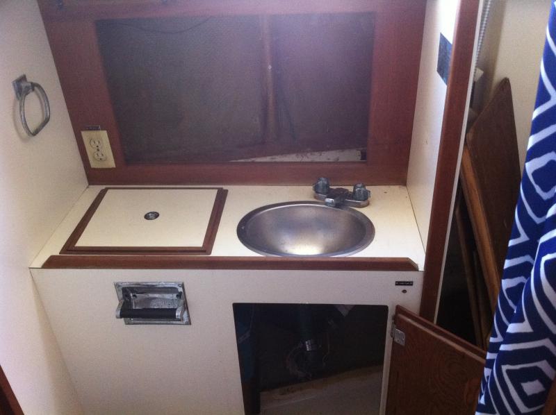

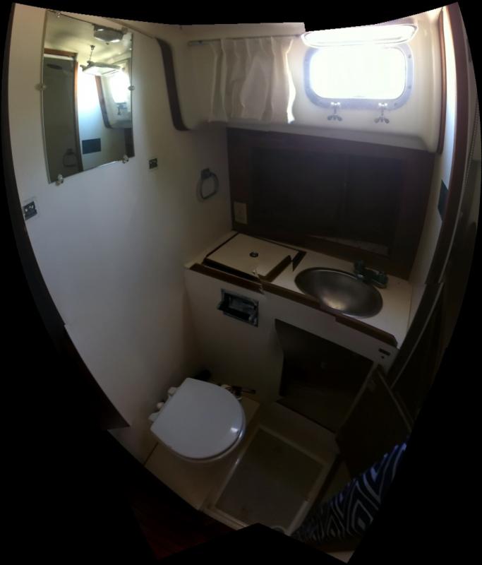

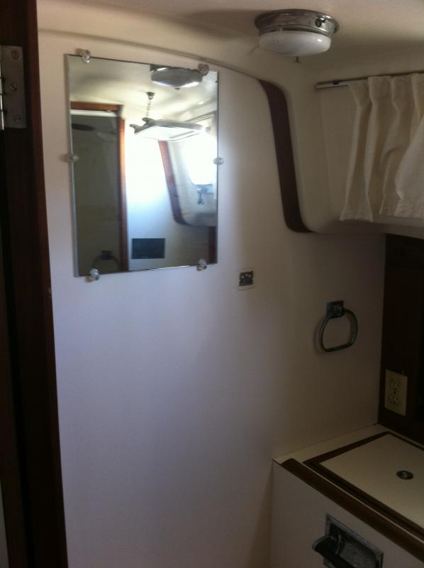

I have identified three spots in the head compartment that could achieve my objectives: vertically, against the wall behind the toilet; horizontally, against the wall behind the toilet; or a wedge-shaped tank in the hanging locker between the sink and the hull. There are actually two full-size through hull fittings dedicated to head use on the boat -- one from the one-before-the-previous owner, that's under the starboard settee and destined for removal, and another that's directly under the and behind bathroom sink. The latter one is directly below the back-of-sink locker, so would be well suited to serving as a gravity outlet, although I'm willing to remove them both and start over on the next haul-out.
I set out looking to find a polyethylene tank from Ronco, Raritan, etc., and have literally considered each of the 500 or so tanks from the two companies, as well as the other more anonymous companies I can find. Nobody makes a single tank that fits perfectly -- or even close -- in any of the spaces I've mentioned, although some would fit if I settle for a very small capcity (11 gallons or less) or very awkward placement, eg., jutting out uncomfortably behind the toilet. I considered a flat-pack-shaped tank behind the toilet as my favorite option, but there are very few that are thin enough -- 6 inches requires pushing the toilet forward off it's current ledge -- and none provide enough volume. I have built mockups from cardboard of several tanks that could work, but they're just awkward and take up too much space in the small compartment.
The locker behind the sink is looking like the best option. It's a wedge shape, about 10 inches deep on the fore end, 13 deep aft, and 20 inches high and 32 inches wide. It's much deeper near the top, however, one of the hull tabs and chain plates cuts into this wedge, so that without creating a tank with a slot cut out of the back, the biggest that would fit is a wedge 6 fore x 9 aft x 19 high x 32 wide. Nobody makes a tank this shape, so my only option would be a 10-gallon flat tank (6 inches deep) or to fabricate one (I'm very experience with fiberglass, epoxy and polyester); or to have one plastic welded (my first quote was for $1,050 -- which is way out of my price range.) I'm tempted to go with the 10-gallon solution, since I expect it to be mostly empty, anyway, but I'm trying to be forward thinking and consider the requirements of family and future guests.

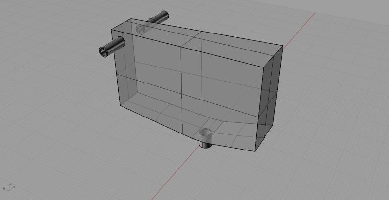

I'm attaching drawings of what I propose, as well as a quick model of the tank itself. I welcome feedback and criticism. I would much rather work this out on paper than by installing a quick-easy solution that will need re-fixing later.

OK, so I appreciate all your feedback about zero discharge and the realities of sailing guests. Points well taken. I will "contain" my unrealistic expectations.
That said, I still like the layout I'm proposing for my new head system. There's nothing anybody has said that precludes using it. It provides for pump out. I can lock or remove the thru hull lever. And the system I'm designing has about 20 gallons capacity (if I maximize the use of the space by bridging around the hull tab) which is about as much as I'll be able to fit anywhere on my boat, above, or below, the waterline, without removing/re-purposing one of the built-in water tanks.
At the risk of derailing a vibrant thread on the practicalities of "holding it," any comments on the proposed location or mechanics of the system?

Nothing wrong with an gravity emptied tank but the Coast Guard won't be amused by your river box policy. If that seacock is open inside 3 miles, you've committed a felony. Remember that the Coast Guard is a branch of the military with their own rules. They can board you and conduct a search without probable cause or warrant. It can get unpleasant really quickly.
With the gravity tank, sometimes gravity may not be strong enough. I'd do one or more of the following:
Make the exit hose very straight. No 90 degree fittings.
Position a deck pump out plate plate directly over the exit so you can push a stick down to clear a clog
Use a macerator type toilet
Use a 2" drain hose.
As to the 20 gallon tank. It will be fine especially if you use a toilet that doesn't require much water to flush. That way the tank fills up more slowly. My favorite is the Raritan Elegance (it's electric) that uses minimal flush water.

Lots of options, eh? Gravity feed, unless you use a bucket, will prove probelmatical. You have to "engineer" the height of the tank to assure you have enough "head" to overcome the friction loses of the pipes and elbows it would take to do so successfully.
Most of the ones I've seen or heard of simply do NOT work.
Either get a macerating head or use a macerator (pump).

I also believe that putting "stuff" into the tank first/always (as WM suggests) vs. either/or discharge with a Y valve, makes little sense.
Have you bought Peggie's book?
Hmm. Interesting point on the order of the tank/valves. I was thinking tank-first was normal. I just really loathe to repeat the rat's nest of hoses that was in there originally. Anyway, I'm ordering the book now.
