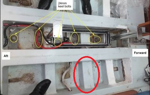

Sorry I don't have pics just yet...The attached image isn't from this boat, but will give an example of what I'm talking about. On the boat in question the area I circled red is the piece of 2x4-ish size wood, and it's loose. The rest of the boards that are oriented in this fashion are secure.

That would be a concern because it is supporting the weight of the keel.

Even with a swing keel and not a fixed keel? Also, this board on our boat doesn't travel through the bilge area like it shows in the picture. It stops at the "box" that surrounds the bilge space.
Weight is weight regardless of the shape it is in. The swing keel is housed in a metal (cast iron?) stub and the centerboard part retracts into the the stub. The stub and CB weigh in at about 1500 lbs. https://www.boat-specs.com/catalina-yachts/catalina-25-swing-keel
The keel version is about 400 lbs heavier. https://sailboatdata.com/sailboat/catalina-25
When the boat is sailing there is a tremendous amount of force exerted on the keel/hull joint. When the boat heels the keel acts as a lever, so you have 1500 lbs of force trying to go to the bottom. The keel bolts keep it attached to the hull and the timbers keep the hull from ripping apart.
The wood is not the structural member. The load bearing structure is the fiberglass that surrounds the timber. The wood is only there to give shape to the fiberglass. On my boat, with a 6,000 lb keel the timbers are foam cored surrounded by a ¼" + of laminate. Mads over on the Sail Life YouTube channel has been dealing with this issue, here's one video (there are several) where he talks about his options to repair the floor timbers.
The big question, is why is that piece of wood in there? What happened to the original structure? Why was it removed? Is the port side timber the same as the starboard side?
