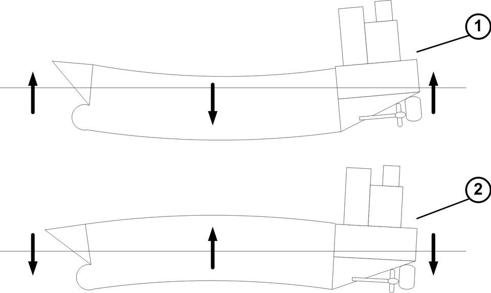

I believe that when the ends of the boat sag while laid up the term is hogged. I don't know a term for when the middle of the boat sags - reverse hog? Anti hog?
14,037
I have that same problem.
Hogging is when the middle of the boat is higher than the ends and sagging is when the middle of the boat is lower than the ends.
