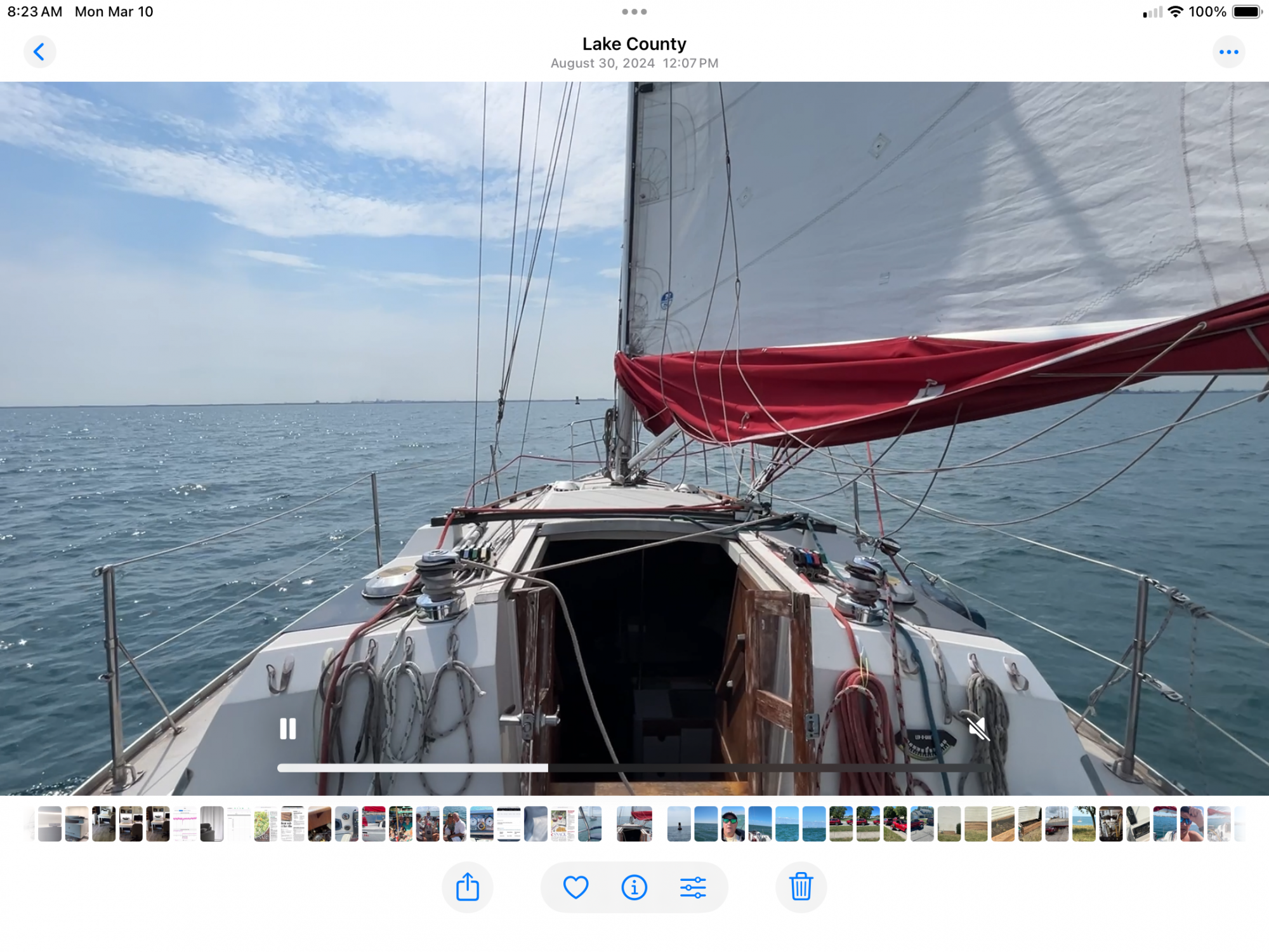

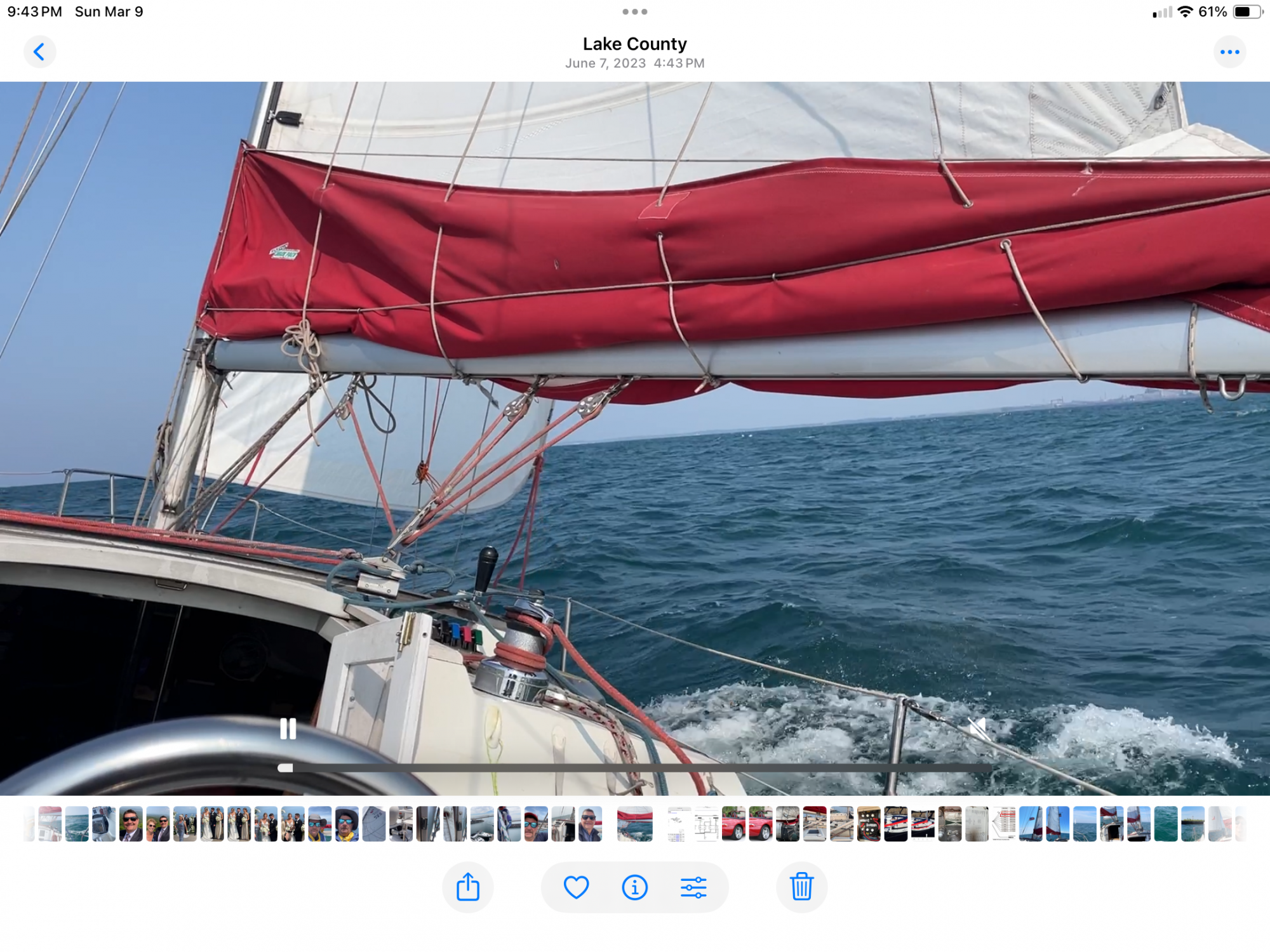

I have a loose-footed main, and a Mack Pack pack. Works fine.
But in light air, I will loosen the jacks and drop the Mack Pack out of the way so I can loosen the outhaul to get more belly in the sail. In heavier winds, I don’t bother dropping the Mack pack.
I like the fact that I can drop the main, start motoring into the harbor, and have the lines coiled and the Mack Pack zipped up before I get back to my dock. And when I head out for a sail, I have the bag unzipped and halyard attached beforeI leave the dock, and I can raise the sail very quickly once out of the harbor.
Greg

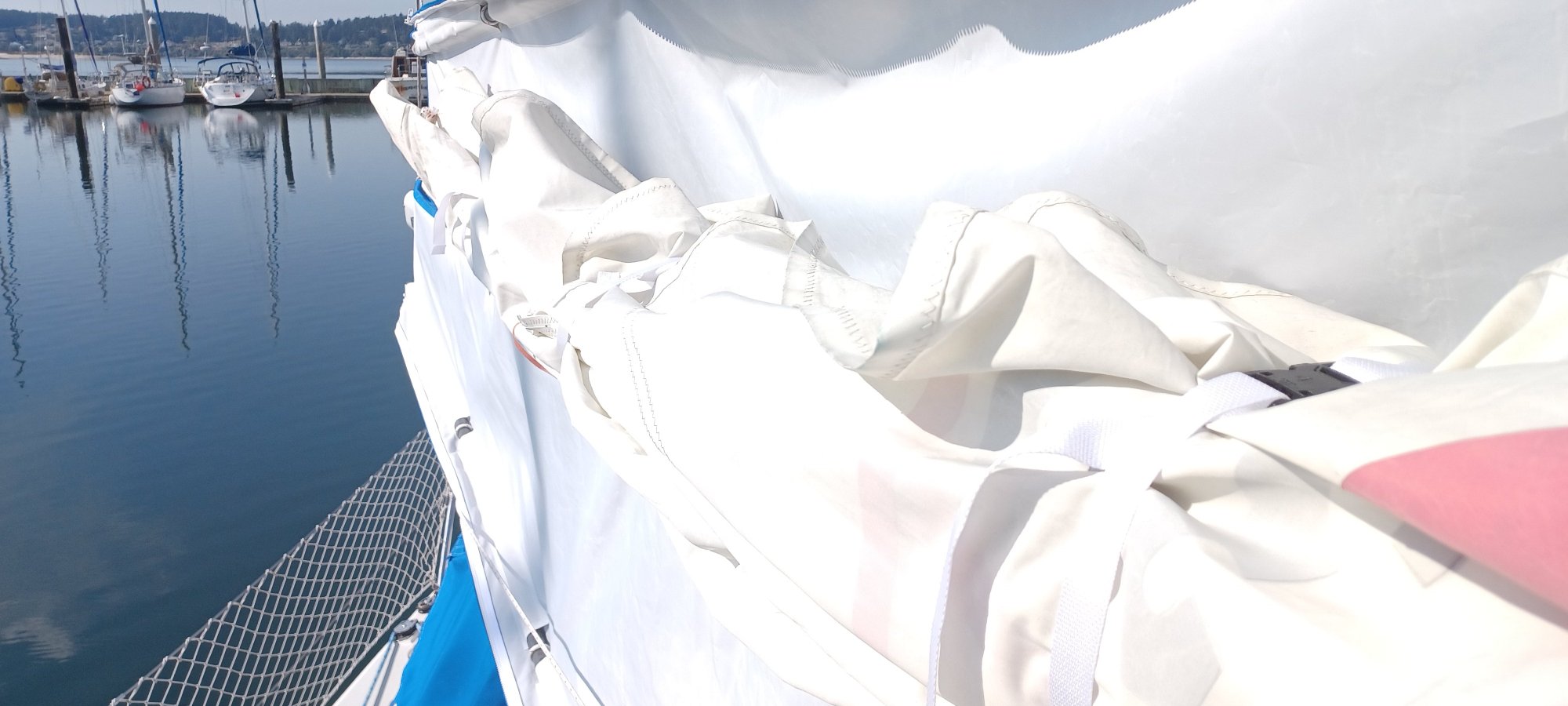

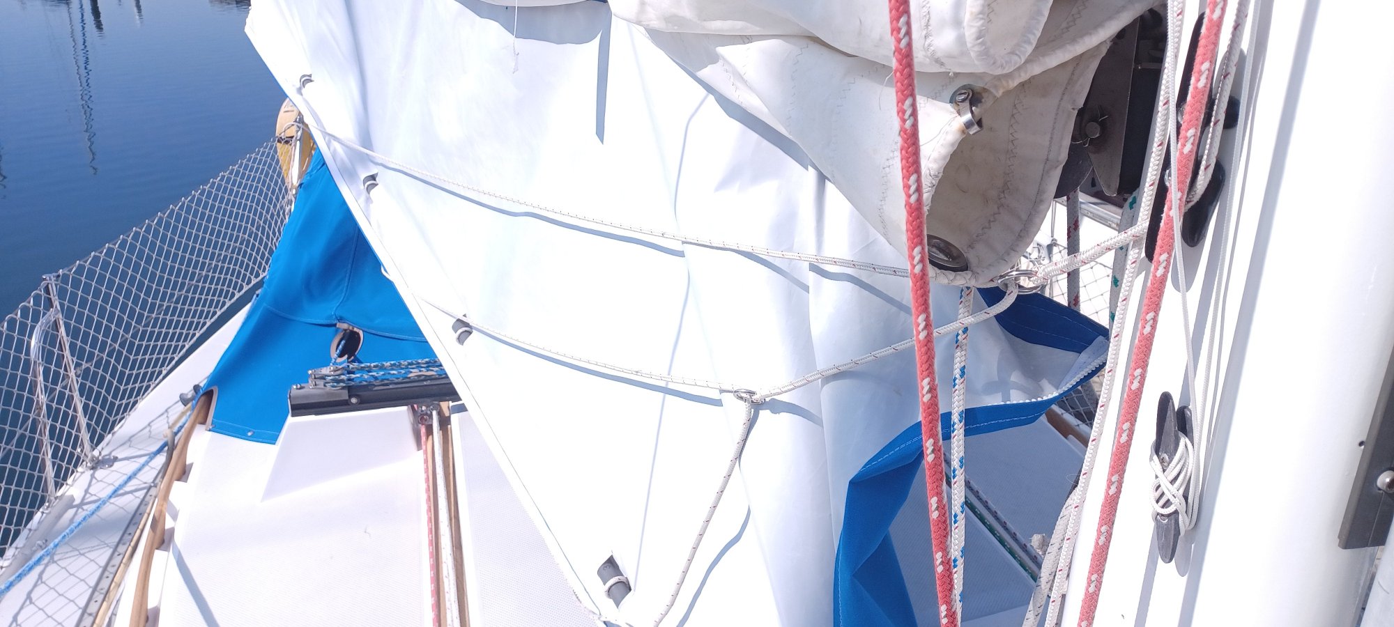

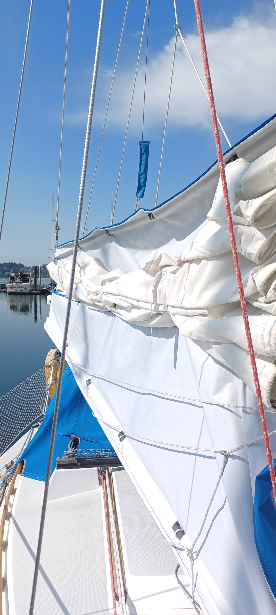

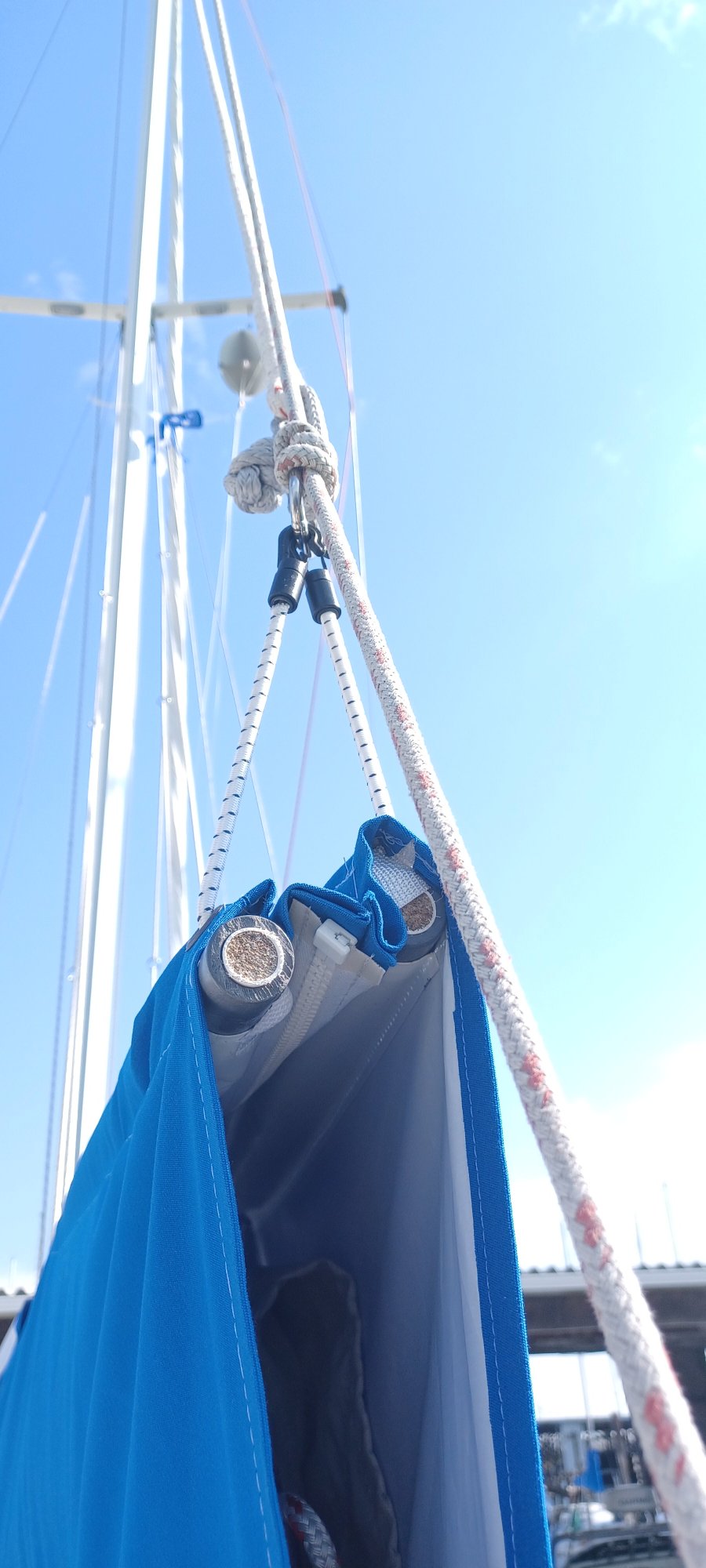

I personally would not have another footed sail on any of my boats but then I love to trim. If you are a "set it and forget it" type of sailor, you likely will not notice any difference. The loose foot makes the outhaul your super weapon because you can easily ease the foot of the sail to create a very round and powerful foot in very light air or pull it bar tight to create a flat sail that will perform well in the higher wind speeds.
I changed my outhaul from the factory 3:1 system to a 12:1 system that makes outhaul trim very simple.
I do not like most stack packs which is why I designed and sewed my own PapPac. My problem with most is that they are always up and ruin the shape of the foot of the sail. Mine are dropped and rolled along the mast when sailing so that there is nothing to interfere with the main sail trim.
Likes: smokey73
Apr 5, 2009
3,217
@Hayden Watson do you have a batten in yours? It would be great to see how it deploys if you have an photos to show.
I use a 3/4" sch 80 pvc pipe for the battens. they are 12' long so I needed to splice a couple together to make them long enough. I did that by getting a 3' length of SS all-thread which I cut into three 12" long pieces. I ground notches into the end of one to make a thread tap, and the other two were used for 12" long splices.
