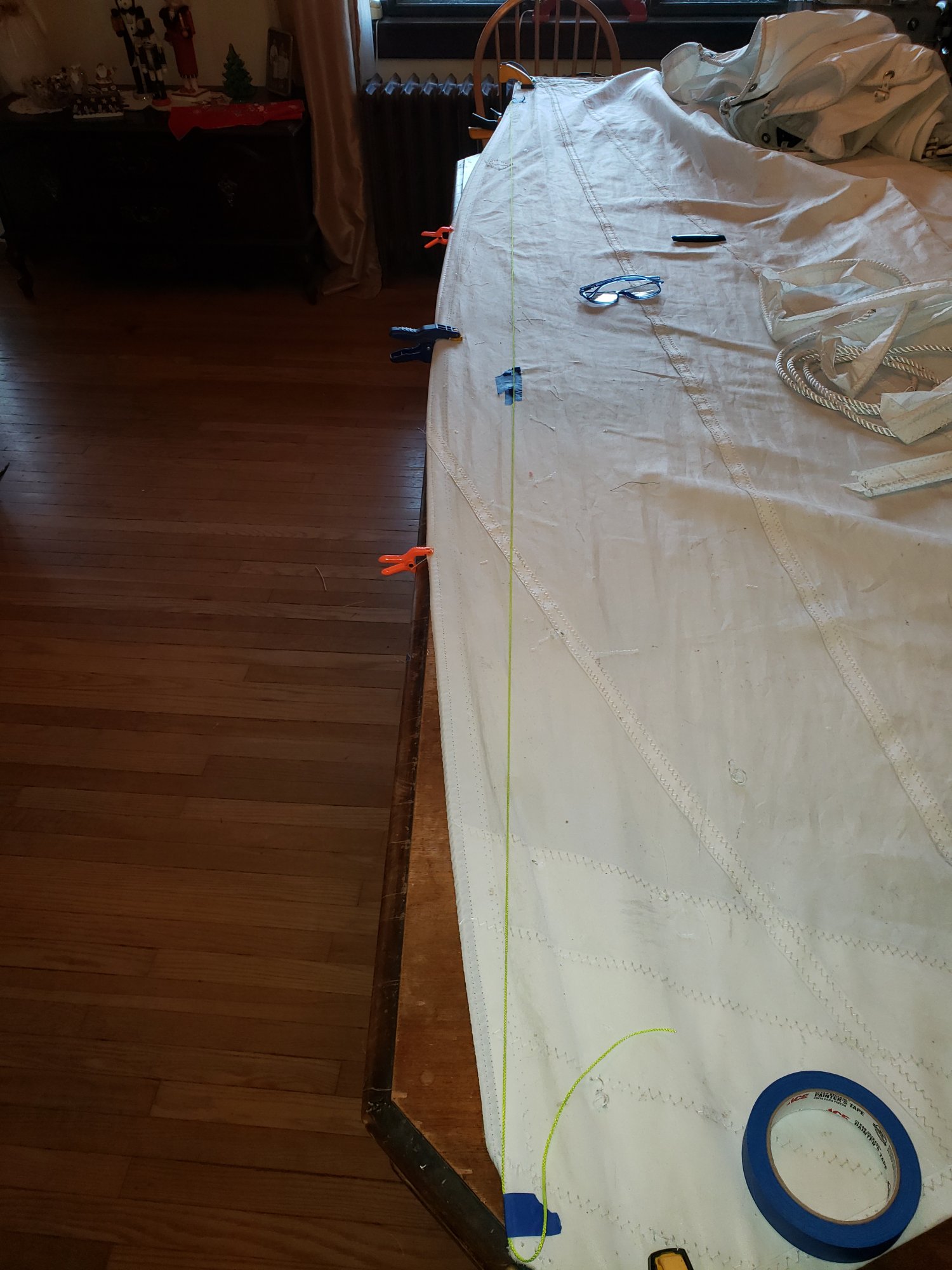

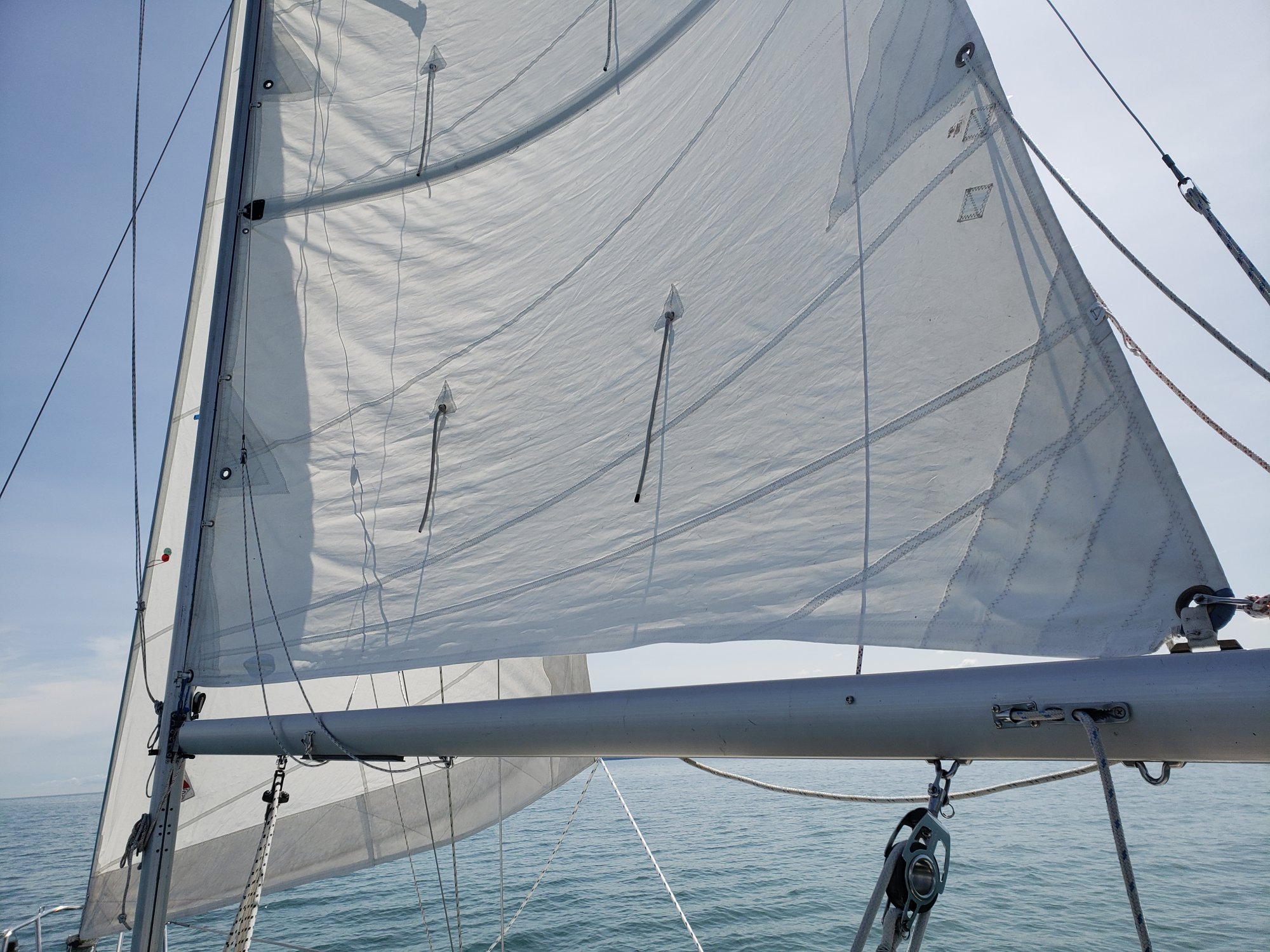

I did this exact same project last winter. I took my baggie bolt rope foot and converted it to a loose foot. It helped me adjust sail shape a lot, but it is not perfect (yet). My main was recently reconditioned by the PO, but still had the big foot shelf to give it shape. I cut off the bolt rope, some of the foot shelf, and added new edge binding tape. The biggest problem i had is there was not enough length near the foot shelf, so I would have to remove too much foot if I wanted it REALLY flat. I already had a slide at the clew, and I have boom end sheeting, so no worries there. This winter I'm planning some changes to make it better. I'll dig up some pics.
Would it be easier to buy a new one? Sure, if you have the money and don't want to spend your time on it. On the other hand, I love fixing things, making them better than new, and learning new skills. I can always buy a new sail later if I want (or if I screw it up). This is the perfect opportunity to start learning sail making. I'd much rather fix something myself than pay someone else to do it.
JBP-PA
Apr 29, 2022
620
Jeanneau Tonic 23 Erie, PA

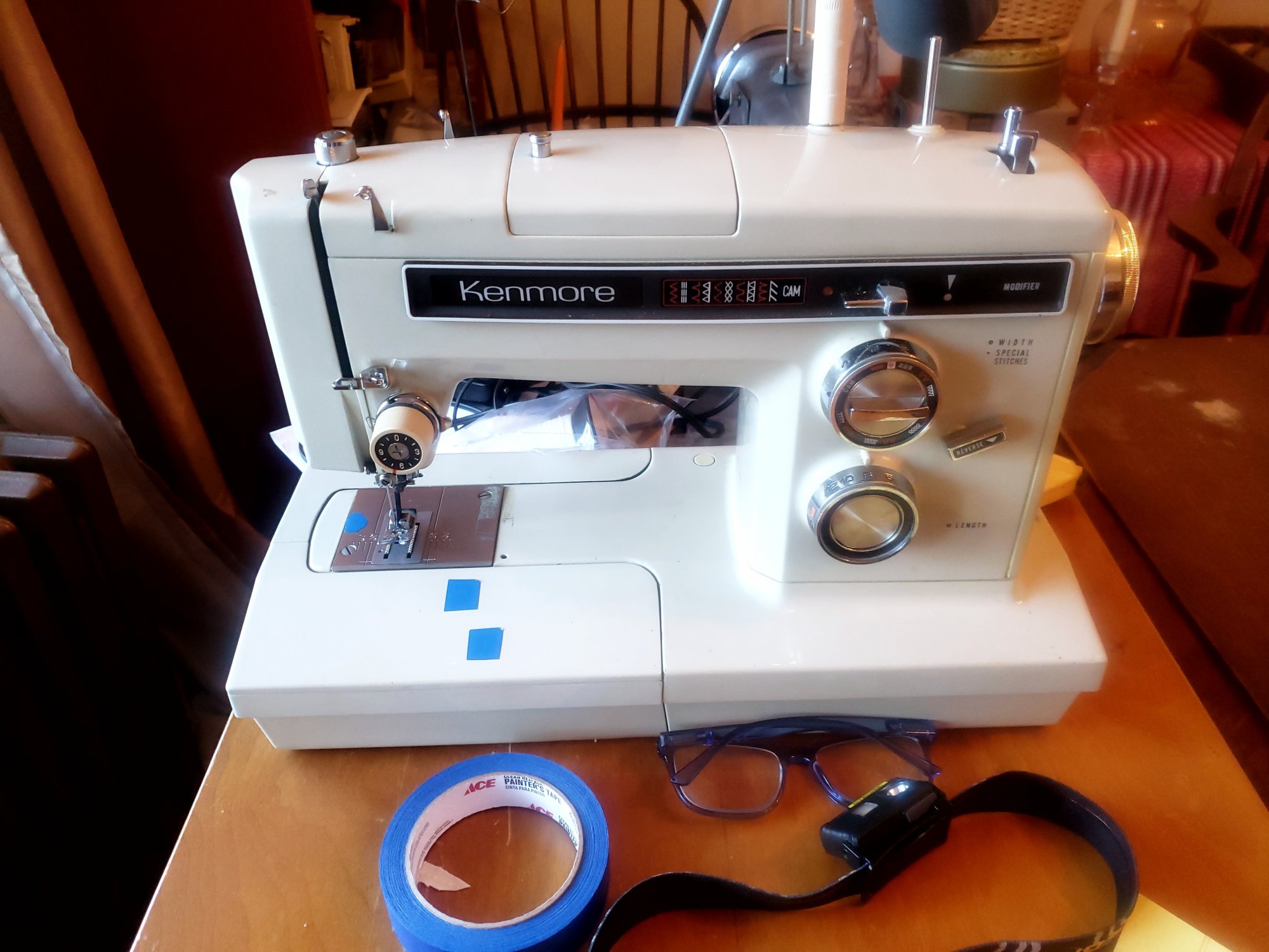

Bolt rope off, laying out where I want to cut.
My $50 zig zag machine, slightly modified for sail work.
In use.
Doing it was great fun, learned a lot. I'm not finished yet, I want to make the foot longer so I can get rid of the concavity and maybe raise the clew if I can (the boom does not quite clear my bimini when sheeted tight, thus the pendant at the tack).
