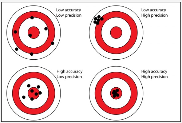

Your description is actually backwards - in terms of terminology. Precision is repeatability - accuracy is how close to the right number it gives you. That is exactly what I was saying above. Let me attach a photo - this shows it very well.
These gauges likely have fairly high precision but low accuracy.... Although, just guessing really...

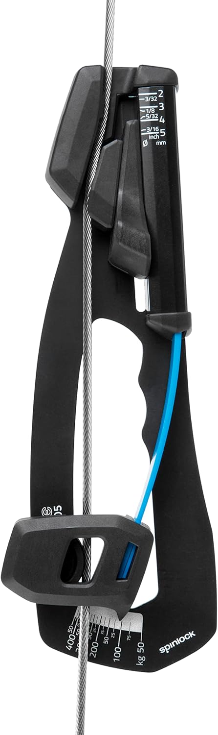

I see that Spinlock makes something similar ($150).

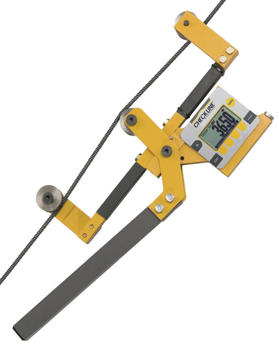

The gauges used for setting tension on industrial structures are both more accurate and more $$$. A similar principle, but they are less influenced by cable material stiffness. You can also do this with a ruler and a fish scale to very good accuracy.
Tension = Force*(distance between ends)/(deflection*2)
