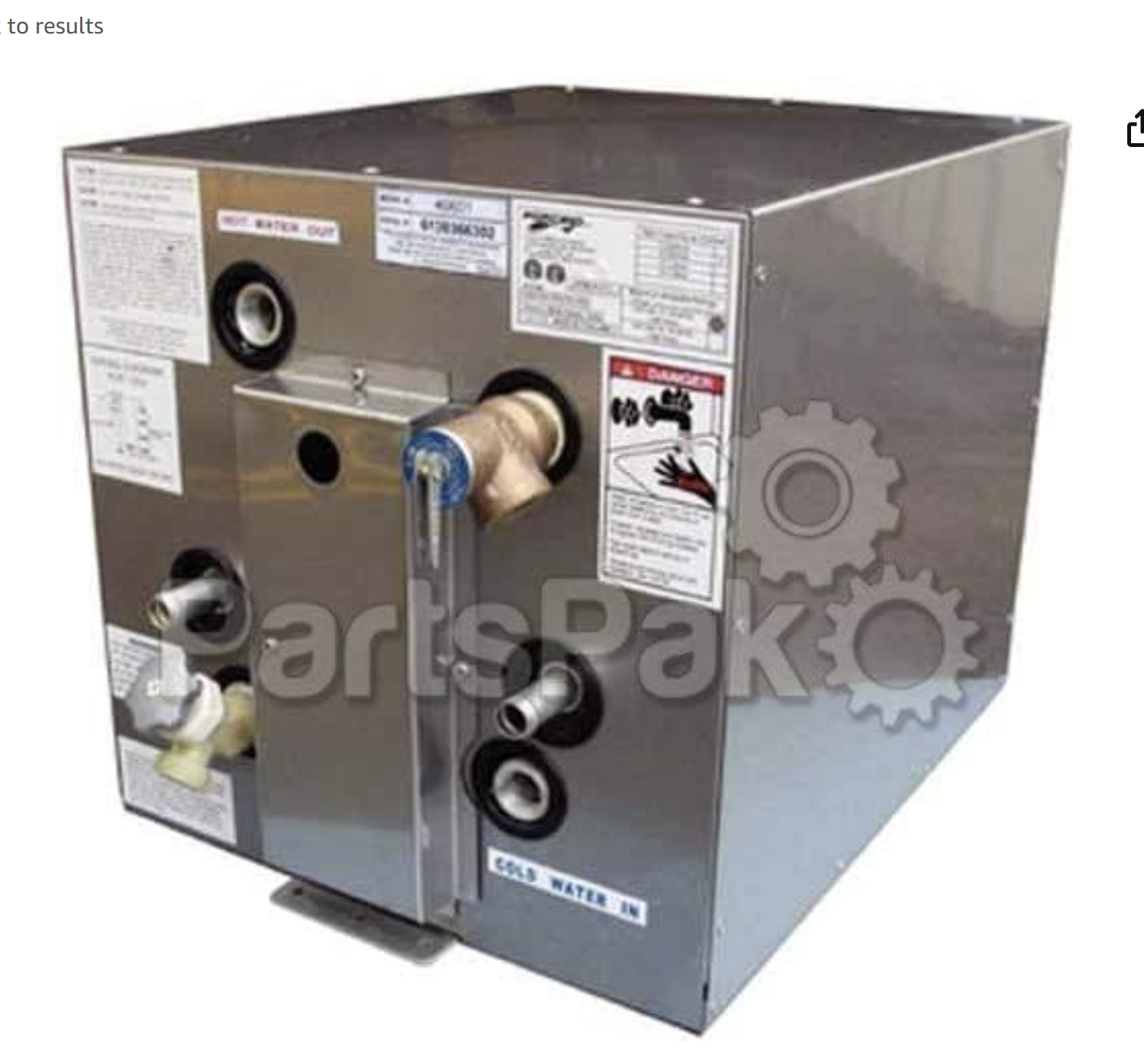

Looking to replace my 6 gal water heater on Hunter 320
Jun 22, 2004
40
Hunter 320 Benicia, Ca
I am looking to replace with a Kuuma 11811 6 Gallon 120v Front Exchanger Stainless Steel Water Heater - any thoughts?

I am looking to replace with a Kuuma 11811 6 Gallon 120v Front Exchanger Stainless Steel Water Heater - any thoughts?View attachment 222663
False advertising? Defender & West Marine describe this tank as having an aluminum inner tank. I think these guys are lying or oblivious. It's a lot cheaper than the Seaward and Isotemp brands that are stainless steel so it can't be the same thing. West marine recommends the use of magnesium anode to extend the life of the tank.
23,120

I'm talking about Kuuma and the Parts Pac (false advertising) ad displayed in the opening of the thread. West and Defender clearly state that the jacket and inner tank of the Kuuma model is aluminum. This ad in the post implies it is stainless steel.
According to Defender, the Seaward is an aluminum inner tank and exterior jacket can be galvanized steel, stainless steel or epoxy-coated aluminum. They recommend the magnesium anode for the Seaward and Kuuma, I suppose because it will inhibit aluminum corrosion.
Isotemp makes stainless steel inner tank and either stainless steel or polypropylene outer jacket. I bought an Isotemp with the plastic jacket for my Starwind and I'd like to replace the Seaward that I have now with an Isotemp heater eventually. I'd even like to increase the size if I can. Not that it may matter to other people, I prefer stainless steel above all other materials for water tankage. Aluminum is not good for water tankage due to the corrosive residue that develops. The aluminum tankage is surely the reason why Seaward and Kuuma are less money.
Scotty, Scotty Scotty...In an effort to begin to understand your post, I went back to the opening post in this thread. All it was was a photograph of the Kuuma heater. It did not link to any associative advertising.
Could you please help me to understand specifically just where this alleged "implication" of false advertising may have occurred? Would you mean I would have had to go to the Parts Pak website to find the written material? Because it doesn't seem to me to be in the opening post in this thread. Thanks in advance. :)
Stu, I'm afraid you must have missed this since it was the opening post .... Do you see where it says: Kuuma 11811 6 Gallon 120v Front Exchanger Stainless Steel Water Heater - any thoughts? Just to be sure, I did google "Kuuma 11811 and came up with this identical ad from Parts Pac. Or you could have simply clicked on the provided link. It shows up in Amazon with the exact same description. To be sure, it is an aluminum tank, not stainless steel as implied in the opening post.
Are you ok? :facepalm: I don't know why you are seeking an argument ... I'm just discussing facts that are easily discovered by reading the documents provided with the advertisements for this product.
To be sure, I'm not blaming @Stephen Dale for the implication ... he just pasted the verbiage and the picture from the amazon advertisement from Parts Pac.

Stu, this is just plain silly. Stephen's original post has the caption Kuuma 11811 6 Gallon 120v Front Exchanger Stainless Steel Water Heater - any thoughts? just above the photo of the water heater? Do you NOT see this? Am I the only person who has noted this obvious glitch? Are the words "Stainless Steel" in reference to something else? I don't know. But the description from West Marine also states that the case is also aluminum, so why is there a reference on the front page of the Parts Pak ad that includes the words "Stainless Steel"?
It appears that Stephen copied and pasted this directly from the Amazon link that advertises this water heater with the source from "Parts Pak". Here is the link, since it seems that you have not seen it .... https://www.amazon.com/Kuuma-11811-Gallon-120V-Front/dp/B07GD38SCB/ref=sr_1_3?adgrpid=1342505407637787&dib=eyJ2IjoiMSJ9.wJARiPmwUQqDxhEjthUCCMAcl5zxWoxuTkUGOWmGRqHqbT2WcJC5vX5YxQigRxIFvI2dmXFKwRxKhTdpy1b0GgjfkZIFu4YR9rCvkrRAFV75GxFSaVO9tI_gS0tma0T-48usdMEFVPBWrnLh14z3Sykx5W7sFuIN9gji4gwjZR1IUJDmCI0nbsClMR2rphFhQCv58kXU9VDIoPfxZKFXM2ULj16lJ-mLhEMDkThbwvG31xtPggAYFjzSNW37r_sR4nk7PWoqLhN4T30QbVFjnDdMykfBBTky7R_DS5z_U8s.wrkrJRMu9-jZC5_ZrpfmizEFAdeAMAYokd6l9JF1oDA&dib_tag=se&hvadid=83906869039765&hvbmt=be&hvdev=c&hvlocphy=97011&hvnetw=o&hvqmt=e&hvtargid=kwd-83907641546212:loc-190&hydadcr=18832_10464968&keywords=kuuma+11811+marine+water+heater&qid=1708538829&sr=8-3
See there right in the advertisement? It is shown exactly as Stephen posted it. It is long past the time that Stephen asked about this model and I suppose he may have already obtained it. I was only wondering if he bought this model under the false impression that it is a stainless steel tank. To be sure, I used a question mark (perhaps you are familiar with punctuations) so I wasn't really accusing anybody of anything. I was simply questioning. I certainly wasn't accusing Kuuma since the advertisement was NOT from a Kuuma source.
But I'm glad this came up. I was always under the impression that a Seaward tank had a stainless steel inner tank. Now that I have found out otherwise, I will hopefully exchange my water heater for an Isotemp .... now sooner than later.

The link in Post #1 is a link to a low quality image of the Kuuma water heater, it is not a link to any description of the tank.
When in doubt about a product's description in a vendor's site, it makes a lot of sense to check the manufacturer's website.
From Kuuma:
Kuuma Premium Water Heaters are constructed of corrosion-resistant, marine-quality aluminum and heat using electrical power or integrated heat exchanger. Features include ignition protected controls, mounting tabs and manual reset. Available in 120V and 240V in 6 gallon, 11 gallon, and 20 gallon sizes, Kuuma Water Heaters are the choice of many OEMs.
Fisheries Supply, a reputable marine retailer also lists the Kuuma HW tanks as being aluminum. Defender also lists Kuuma tanks as being aluminum.
If I recall correctly, Kuuma did make SS tanks, so any advertisement for such by a retailer suggests that they are selling old stock, especially if the price is lower than found in reputable retailers.

I have had difficulty finding a Kuuma stainless steel heater on the web, using a Google search. All I've found are aluminum cases, even though I Googled "Kuuma ss water heaters".
If you can provide a link from ANY advertisement for a stainless steel Kuuma heater that says its tank is ss I will publicly eat my hat and apologize to you. If not, I can only repeat my statement in my reply #10. Kuuma has done nothing wrong and it is not false advertising.
That's funny ... I don't think that I said to look under Kuuma "stainless steel heater". It makes much more sense to search for Kuuma 11811 6 Gallon as a reference. The Amazon sources popped right up and an exact copy of Stephen's reference photo popped right out front and center when I looked - caption referencing stainless steel and all. (It still does). Being curious, I looked under the other sources, such as West Marine and Defender. Both had accurate descriptions of the water heater, specifying that the inner tank and casing is aluminum. So there you see where my comment came from. I was wondering if Stephen was mislead by misleading information from "Parts Pak", which was the obvious source of his reference.

1. See there right in the advertisement? Yes, I clicked on your link, thanks. Here's what it sqays:
About this item
  • welded aluminum tank
What part of the link says the tank is stainless steel?
2. perhaps you are familiar with punctuations - Excuse me, but what prompted this unnecessary bit of stupidity?
3. I was simply questioning. I certainly wasn't accusing Kuuma since the advertisement was NOT from a Kuuma source.
If not, then who were you accusing of false advertising?
4. ...I was always under the impression that a Seaward tank had a stainless steel inner tank. Now that I have found out otherwise...
As I've mentioned a couple of times before, in this and many other posts about marine water heaters, the ss refers ONLY to the case, not the tank. Just like the reference link you provided says it does!!! You may be one of the last people in boating who don't know this fact.
Would you at least have the decency to retract your accusation of false advertising?
The internet is rife with conflicting information, given the preponderance of the conflicts, it seems prudent, to me, to determine why the conflict is there before making accusations that some one or some business is engaging in fraudulent practices. Too often incendiary remarks are made that are simply unwarranted. In this situation there are conflicting statements about a product, it seems to me that rather than accusing a company of poor business practices, pointing out the conflicting ads and suggesting the OP confirm with the seller the tank is indeed SS or call Kuuma about the discrepancy before besmirching a business is a better course of action.
The link in the post was indeed a link to a low quality image and the source of that image was quite easily found (the watermark "Parts Pak" was an obvious clue). I'm not sure why a question would be considered incendiary when there are obvious discrepancies. If you go to the source of the post's link, there is an actual advertisement (Amazon/ Parts Pak) and within the advertisement where it says "About this item" the description says that the product is "welded aluminum tank with an aluminum cover" even though the heading of the ad says "Stainless Steel Water Heater". Perhaps the "Front Exchanger" is stainless steel? I don't know. Perhaps that is what they mean. Misleading? Am I too unknowledgeable to dicipher the wording from an advertisement? Could be. I raised a question ... that's all.
