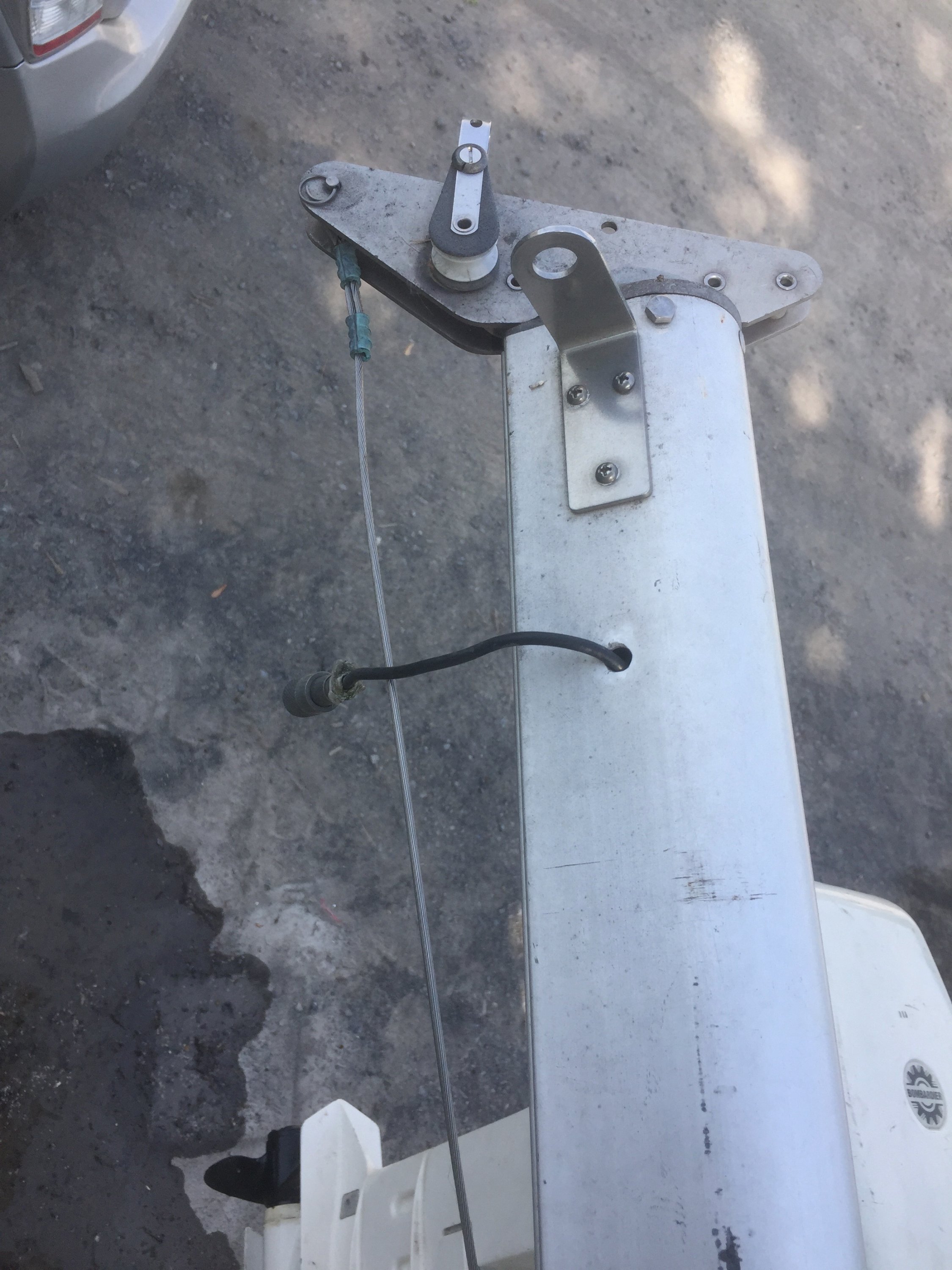

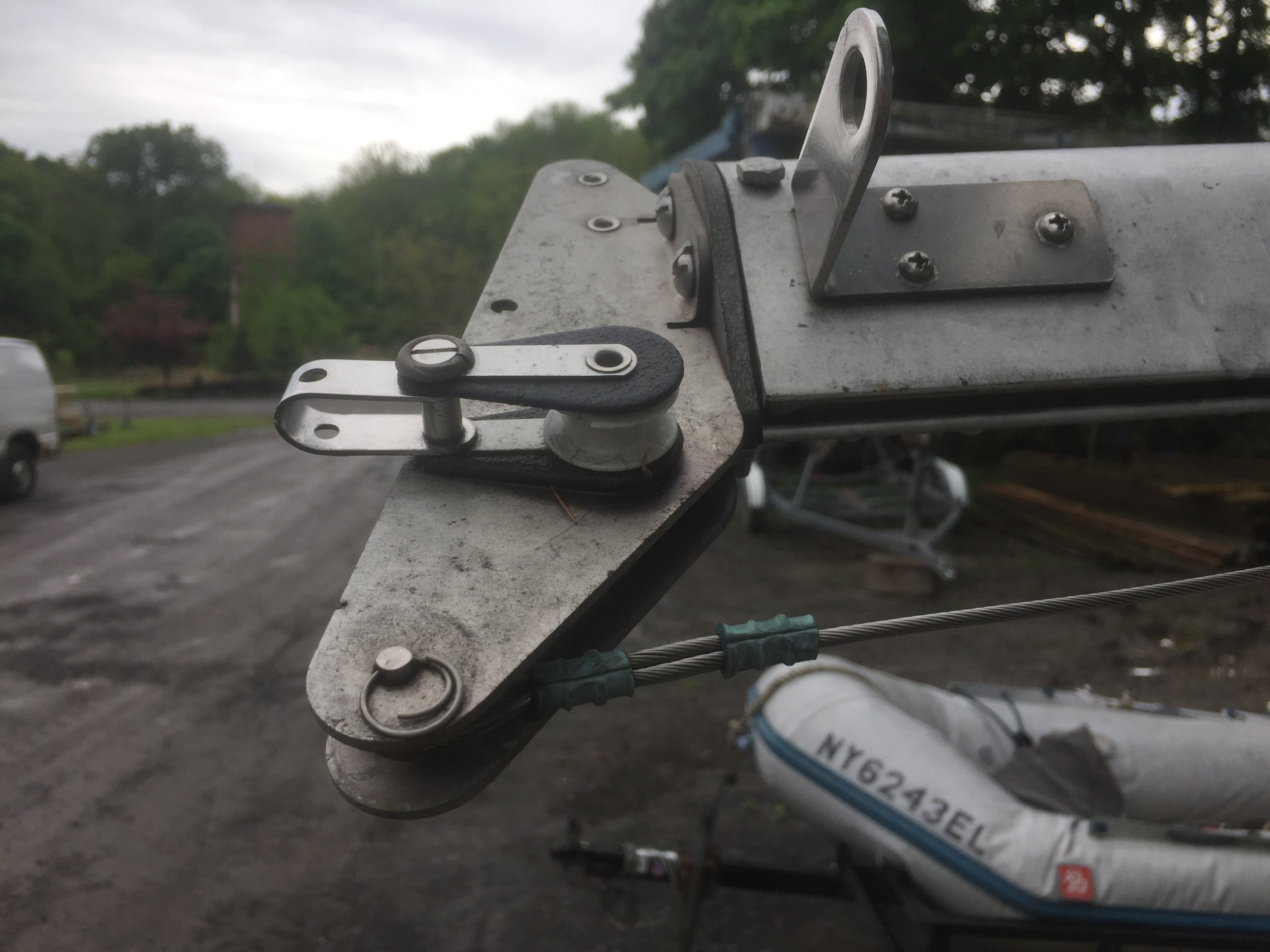

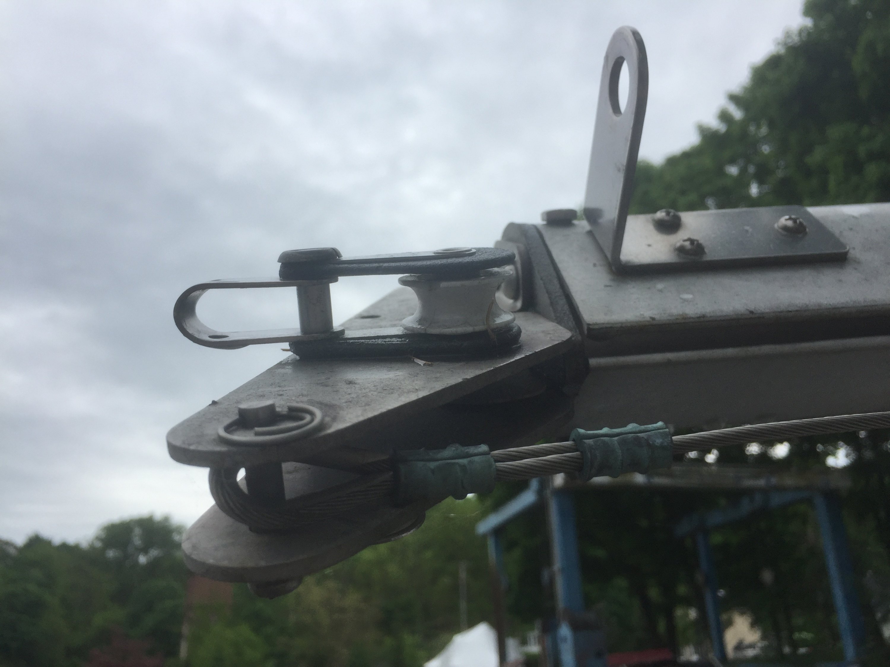

While we are on the subject of the main sail. This is the top of my mast. What are your thoughts on the set up for the halyard? The current set up looks a bit weak to me. Any suggestion for improvement/replacement? I am also interested in installing an anchoring light but can not figure out how I can install using the current set up.

Russ, is the red line a topping lift?
Erik, how big is your halyard? That block looks huge! I think given my druthers I would want the block in line with center of the mast. Maybe see if the block fits between the ears of the masthead, drill it, and put a bolt thru? If you don't need the full height on the mast, a tang or mast strap might work (I think that's what I have - now I am going to have to look when I'm at the boat next!)
http://www.sailcare.com/mast-boom-fittings.shtml
http://shop.bwyachts.com/product-p/3453-1v0.htm
Or even get a simple sheave, and mount it in the masthead. So many possibilities. How do you want it to look? It even looks like a nice setup if you want to make the halyard be internal to the mast. Eventually I want to have my halyards do that - way bigger fish to fry on my boat, though. Of course, planning is half the fun!

You could do the anchor light similar to how the Stingy Sailor did his
https://stingysailor.com/2014/08/31/anchor-light-solution-2/
You could even get another L bracket, fit it on the other side of the mast, and mount the light on a stick to that, and have the power come out of the mast thru a hole like your antenna cable does. Just have to make sure the stick brings the light above the masthead so it shines 360*

Interesting possibilities. I had not considered the halyard internal to the mast option. Maybe I will sail with it in this configuration this year to get my sea legs. The bigger issue next year is that I am going to want to anchor overnight and need to mount a light up there. I do not see how I can put a light up there in this configuration. Timebandits set up is sweet: Next year project I think.

Technically, the anchor light doesn't have to be at the masthead - in fact, there are some good arguments against having it all the way up there. They do sell an anchor light that I think plugs into a cigarette lighter that is designed to be hauled part way up. You could even simply just run a small line thru where your back stay connects to the masthead and back down, and tie off the light whatever height you'd like! I know Perko makes one, but couldn't find it on Amazon. This one might do it, though:

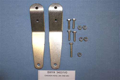

I'm still jealous of - what did Timebandit call it? - your chicken head!

Yes, "chicken head"....very funny. The internal halyard is an interesting idea that I am going to be mulling over. The cool thing about this boat is that it is relatively simple. A wonderful platform in which to learn and experiment. Seriously.....thank you.
