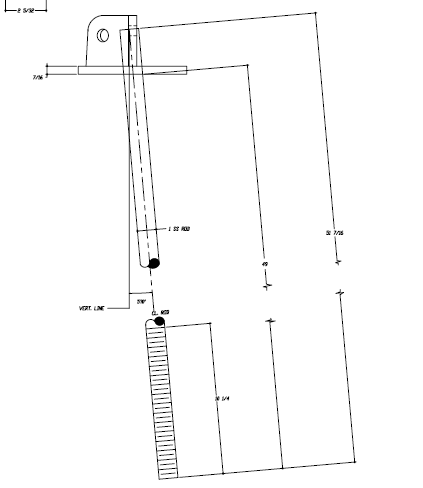

No one was hurt just a big shock. it was the 1" steel bar from the hull to the deck sheared off

Where exactly did it shear off, Dean? Now you've got me worried about our rigging. Our 1991 has an Isomat mast. Rig Rite might be a source for replacement.
Dec 25, 2000
6,070
Thank you for the sketch, Dean. So starboard side? The shear occurred within the one piece rod itself; what appears to be where the rod was threaded on the lower part and below the interior cabinets where it attaches to the chain plate, not where it actually attaches to the chain plate or the chain plate itself?
What were the conditions that caused the failure? Any signs of metal fatigue, or corrosion, at the shear point? I've never inspected that part of the rigging system; all out of sight, you know. There were times when ours were under quite a bit of stress, but she held together. Perhaps time to take a close look.

yes the metal down at the hull that we had to cut fiberglass to see is where the corrosion was at. Yes Starboard side.
