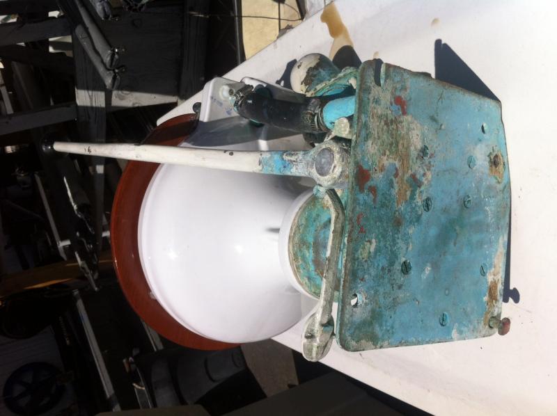

We have a 1954 Airstream trailer, which is being outfitted with several marine-environment appliances, ranging from the fridge: an Isotherm 12v fridge/freezer combo to the oven: and a used Hillerange range/oven with the gimbal hardware removed. All are in stainless steel, and will have custom galley cabinetry designed around them.

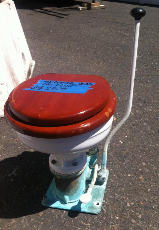

When it comes to the bathroom (a wet bath design), I really want to avoid the boring, modern plastic toilet. While visiting family in California last month, I found a Wilcox Crittenden Skipper head at a marine salvage place in Newport Beach.

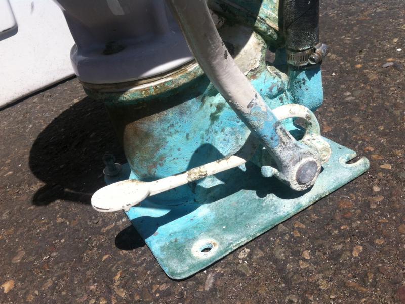

In doing a little research, I believe I got it for a good deal (sub $300) and despite its very hefty weight, I just love that its reputation is that it'll last as long as our trailer. I'd like to polish and wax the bronze portion, which would hopefully look good in a stainless bathroom setting.

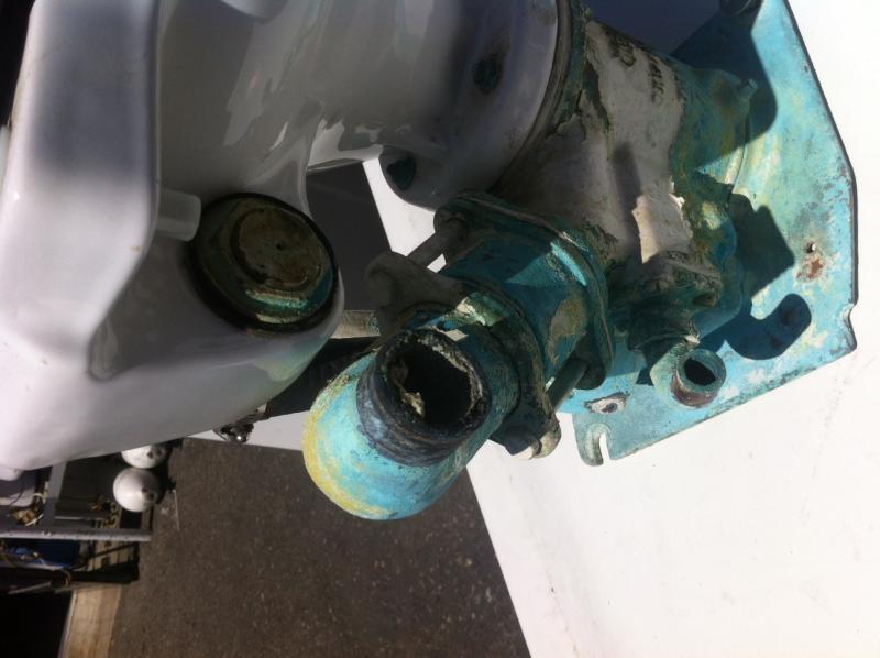

My hope is to determine if this hand pumped head can be used with a modern, on-demand water supply (run by a pump) and black tank fittings. Obviously this toilet isn't a gravity feed setup, so I'm already assuming I may need to adapt some fittings to connect the head to the waste tank. My first concern, though, is whether or not my pump (which automatically runs when one turns on a faucet, for example) will respond to having this toilet connected to the overall system.

Nope...the Skipper was designed to be a sea water toilet...and all sea water toilets are designed to PULL water in. On-demand water pumps PUSH water (which is how they keep the system pressurized). Pushing water through a toilet pump that's designed to pull in water plays hell with the seals and valves in the pump.
There's also another problem: There are toilets designed to use pressurized flush water, and they have the necessary vacuum breakers and backflow preventers designed into 'em to allow 'em to be safely connected to the potable water supply. That's NOT true of sea water toilets. No toilet designed to use sea water should ever be connected to the fresh water plumbing because it risks e-coli contamination of the potable water...and and every toilet mfr specifically warns against it in their installation instructions.
So if you want to use the Skipper in a trailer, you'll have a to install a separate flush water tank that it can pull from.
There's more: Thetford--who bought Wilcox Crittenden about 10 years ago--discontinued the entire W-C product line a couple of years ago. The only repair parts that are still available are rebuild kits what little hardware is still left in inventory. If the bronze has worn enough to require re-machining, it'll cost you BIG bucks...more than the toilet is worth. The best thing you can do with it IMO is plant geraniums in it.
However, if you're still determined (keeping in mind that neither you nor your guests know much if anything about how marine toilets--or anything else "marine"--work and how to maintain 'em) to install the Skipper in an Airstream trailer, I have the parts list and exploded drawings for it if you need 'em. To send me an email, click on my name at the left this of this post and select email (NOT private message please)
However, IMO the best thing you can do with it is shine it up and plant geraniums in it. The Skipper was a fine toilet in its day, but Remington typewriters were the top of their line in their day too.
