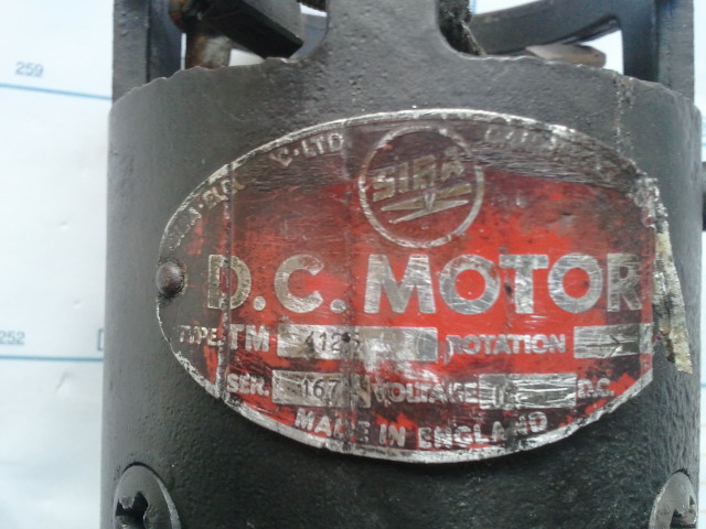

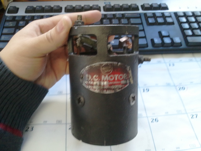

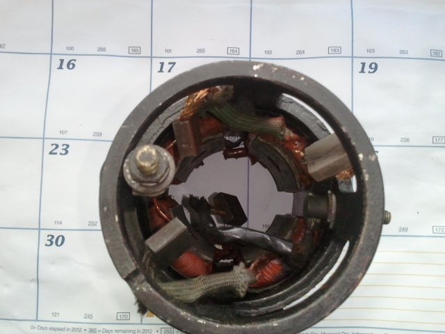

Hello all. I have been searching for this old motor for a long time. Any Information would be greatly appreciated. I've attached photos of this Motor. The Tag on the motor reads as follows:
SIBA ELECTRIC LTD.
D.C. MOTOR
TYPE. TM 4126 ROTATION: ----->
SER. 1674
MADE IN ENGLAND
10,253
What does it do for a living?? Starter motor or is it a winch or windlass motor.. If either, the manufacturer of the driven machinery is likely to have a substitute motor.. Good luck in the hunt !
EDIT: Going to bet that the motor was probably a starter motor that was used on an older car made in the UK.. like a Morris or Triumph..?? There is most likely a Lucas motor (and several other brands) that will have the same mounts and rotor shaft dimensions..
Appears that SIBA was bought by LUCAS in 1957..
