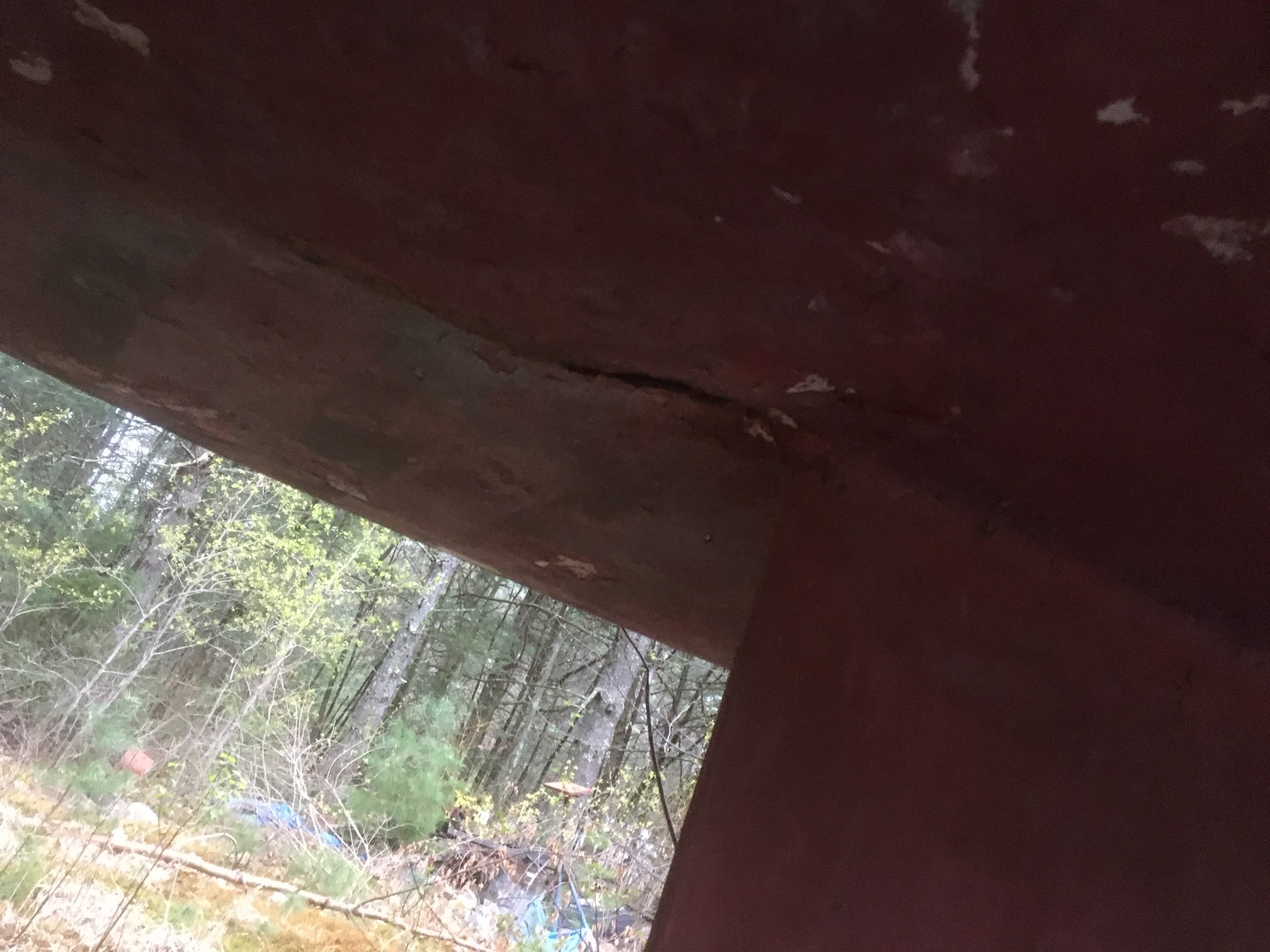

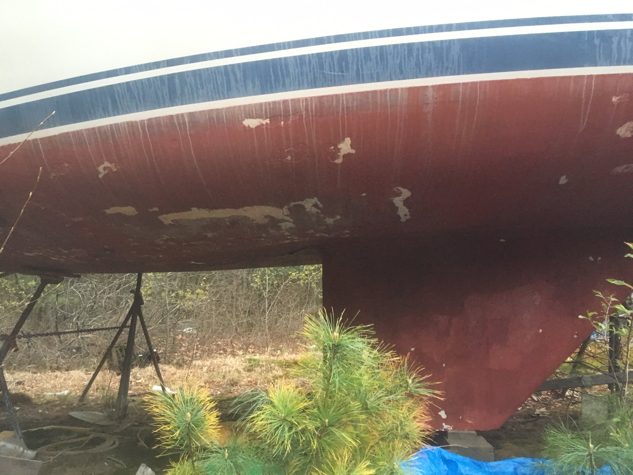

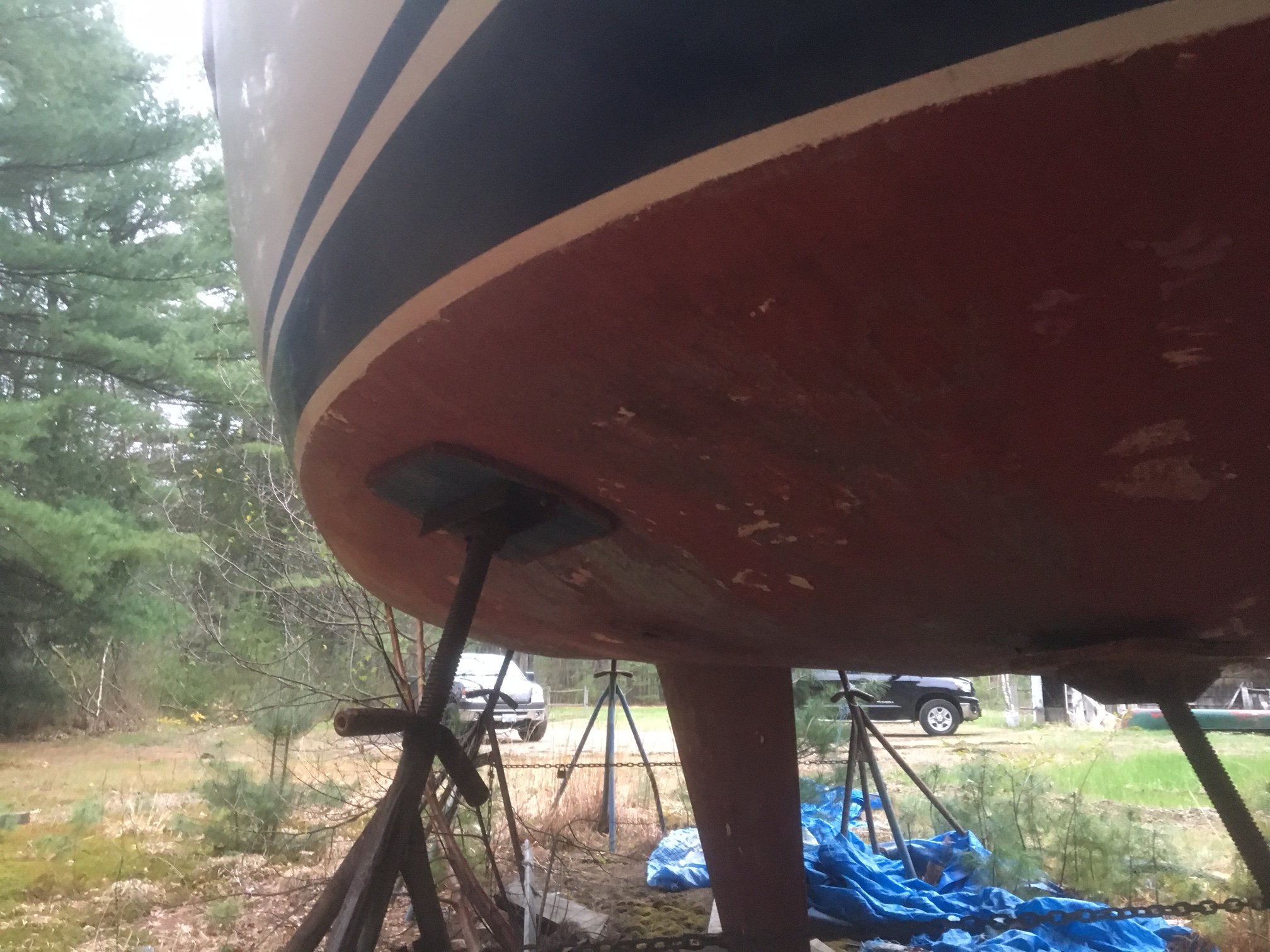

Hello, I was looking for some advice and please be patient, just learning. I'm looking to get a 28ft O'day project boat and was looking for some hull advice. This boat has not seen water in over 10 years and has been sitting on boat stands on soft ground. Along with about a foot of water in the cabin, the keel has appeared to have pushed itself up into the hull. Also, one of the stands (aft port side) looks like it has dented the hull. In anyone's opinion is this project worth it or should I keep looking I only ask because the boat is 2 miles from my house and the owner is asking for nothing. Just curious if it would be worth the money cost in repairs and shipping.

If you buy (or are gifted) this boat you will end all chance to enjoy sailing. Two or three years from now you will have an ugly hull full of weeds that have been fertilized by shredded $100 bills and over-watered by your tears! Buy a boat you can sail the day you buy it.

If it's free strip all the parts off it and sell them. Then sell the keel for scrap metal. You might get 50 cents or a buck a pound for scrap metal. Chop up the remaining glass and dispose in a dumpster. Take the proceeds of the parts and buy a boat in better condition.

The keel is encapsulated type, so what you see in damage is severe structural problems. Scrap for parts is likely more work than you would want to deal with as well.

this is NOT the project boat for you. it sounds like standing water has rusted the keel bolts which is a major investment of time money friends beer and and know how to to repair properly. Run away.
