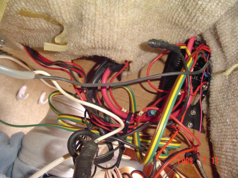

The existing wiring is horrible. It is melted in some places and on the verge in others. My intent is to take a rake to it and start from scratch.

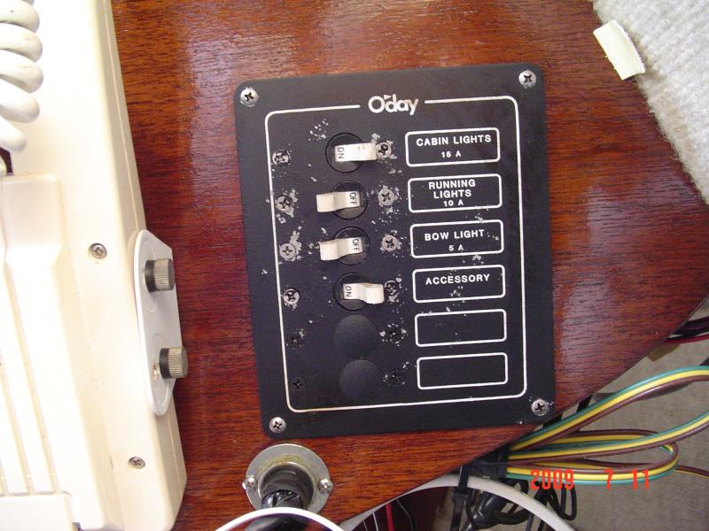

If your load center or electric panel is questionable, you should replace it with new. The new load centers have built in LEDs and they are wired in just a little different than the old panel that is on your boat right now.
The panel that came with my 1986 O'Day 222 has a red + wire running from the battery to a buss bar in my panel. All my black - wires are twisted together with a black wire coming from my battery. To my way of thinking, this is kind of Mickey Mouse, but I bought the boat new and that's the way that they set it up at the factory.
My suggestion to you is to buy a terminal connector strip for the grounds only if you don't have one on your existing panel, or a new panel if you choose to buy one.
This way, you have better access to each pair of wires and you could separate any pair and ring them out a lot easier in the event that you ever have a fault in your wiring.

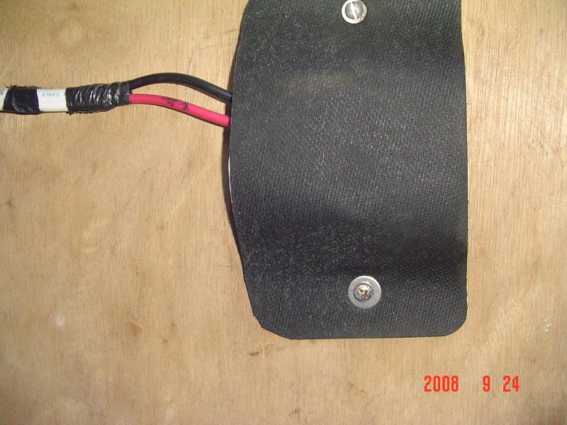

I got rid of my cabin dome lights years ago and hid the wires under the head liner. I use self contain LED lights only for a short duration when I need them. I have Velcro glued to the back of the lights and I can remove them and place them anywhere I want light. I have three of them, one in the main cabin and two in the V birth section.
