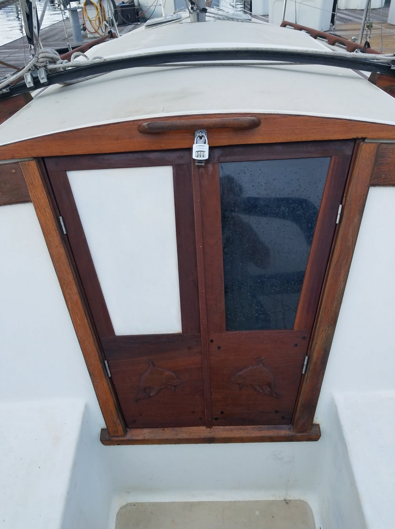

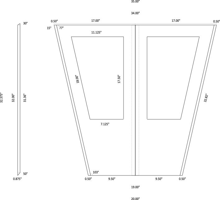

I made my own companionway doors. For my previous boat, a Catalina 30, I used Cumaru (Brazilian Teak). For my current boat I used PVC trim lumber. I measured again for my 36, but basically used this:
The Cumaru doors had removable slide in inserts for clear or opaque and also had carved dolphins. (My late wife loved Dolphins)
The current doors have permanent plexiglass and solid inserts for privacy.

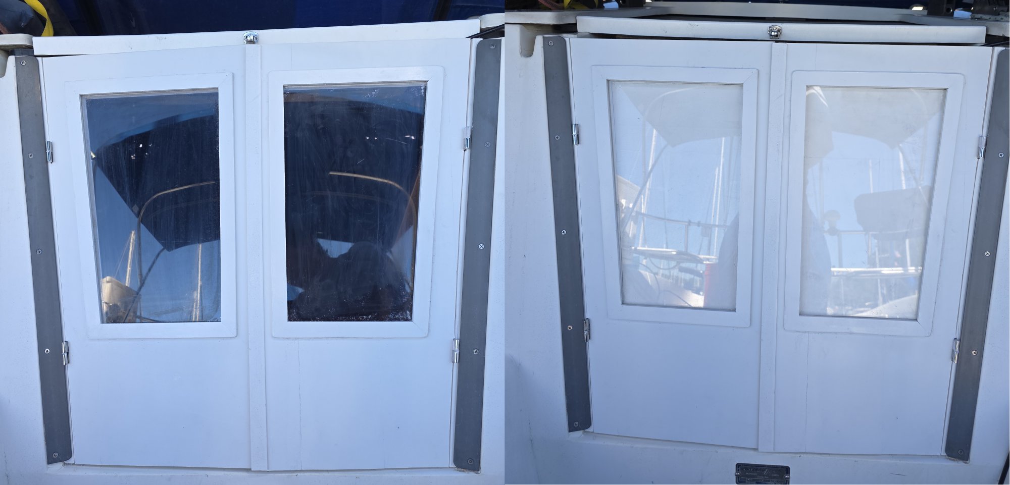

I've been using 3/4" Lexan hatchboards for the better part of 20 years . I really like the light these let in .
Especially on gloomy and rainy days . At first I was concerned about privacy and long term UV exposure .
Turns out I need not have worried about either issue .
I haven't figured out how to remove the many small scratches .
Lexan has proved to have been a great choice for durability
