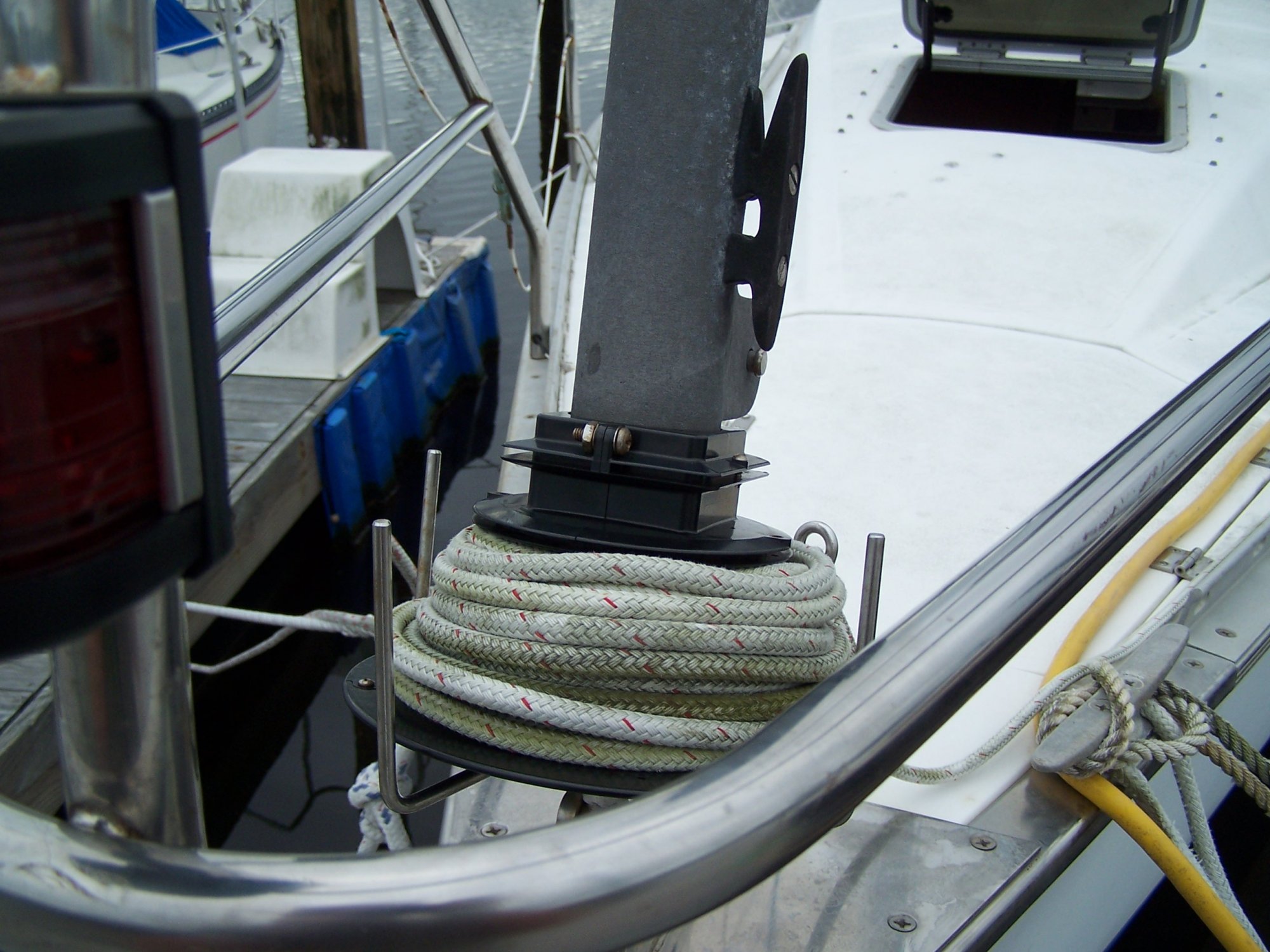

Greetings fellow sailers. Have just acquired a '87 Hunter 31 with what I have investigated as a CDI 'the reefer r.8'. Mine (pictured) is missing the top part which causes the reefing line to try and wind up the forestay. 2 part plastic. Diameter of my bottom spool is approx. 9". Already contacted CDI. No help. Thanks

I wonder if you could not cut the end off of a piece of 8" PVC pipe... put an end cap on it and cut a hole in the top...and secure the entire mess to those SS posts you have on your furler. Then cut out a rectangular opening in the face for your line to pass through.

Well if you go this route, maybe use black pipe .... it will look better. You could then secure the bail using a few small holes drilled to either side of the SS rods on your furler... then run a black zip tie through the holes and around the SS rods. The black on black will be hard to see. Should work rather well and it will protect the bulk of your line from UV

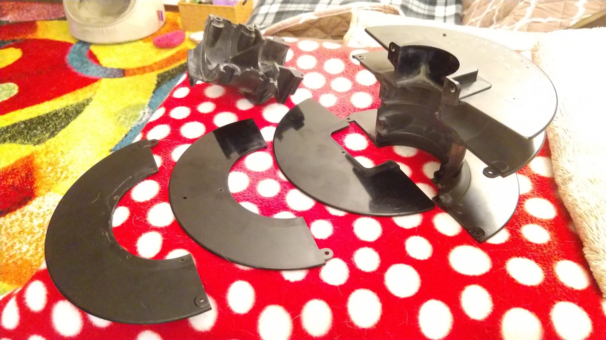

From your picture, are you missing the middle and top flanges? If so, when my original one broke, I saved the pieces. I have one full half including the hub and the three half flanges for the other side. It was from a 1985 Reefer II on my Hunter 34. They're yours for the asking.
Later you might consider converting the drum assembly to the newer CDI ball bearing system that retains your existing aluminum foil.

FANTASTIC Allen12210!!! How do we make this happen? This looks exactly like mine.
