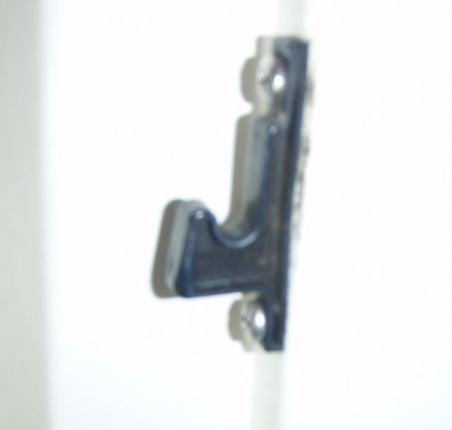

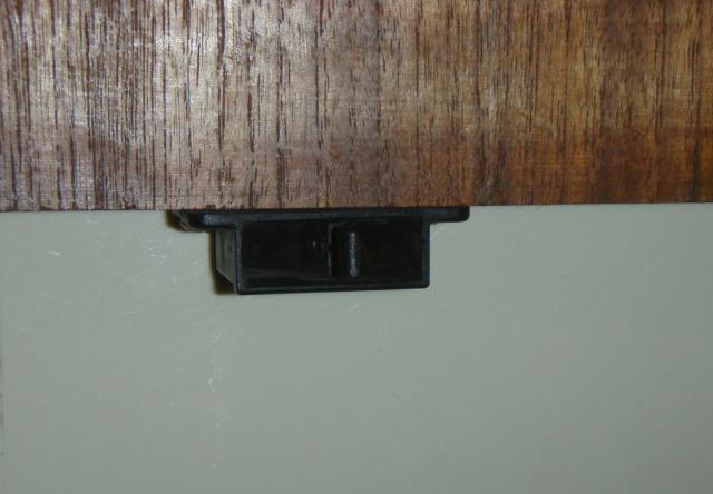

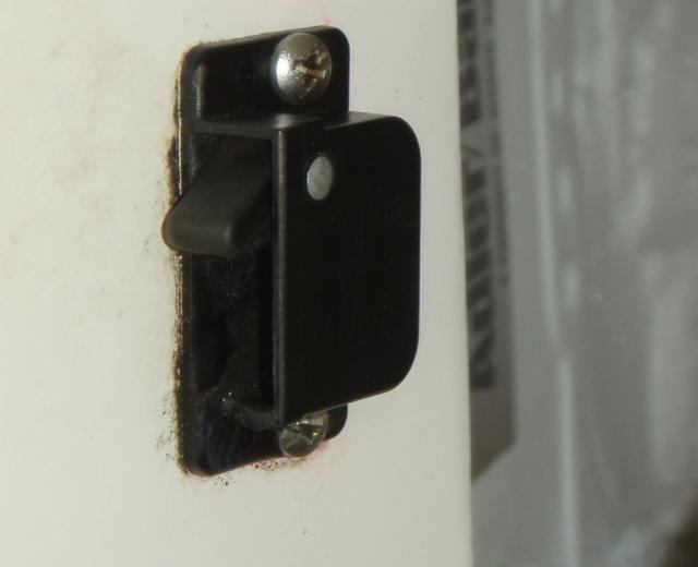

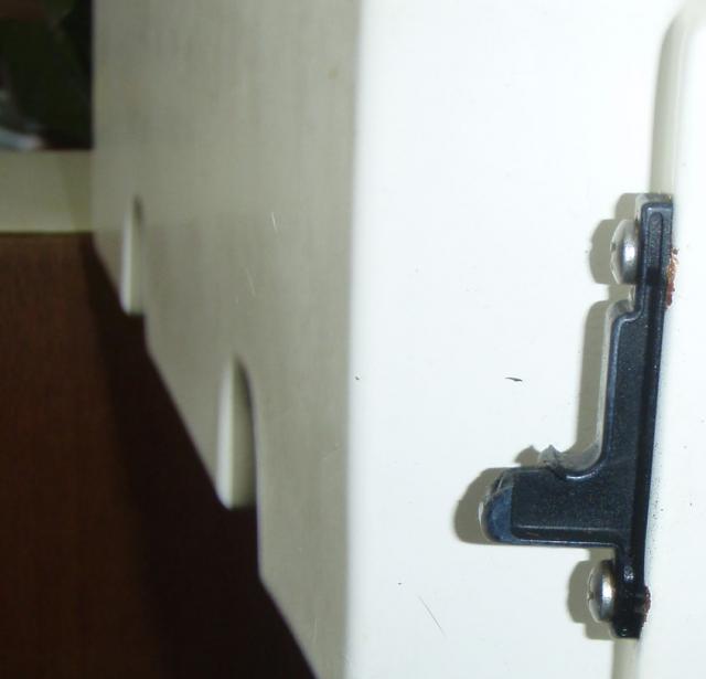

Okay, I figured out how to attach photos...
Descriptions:
upper inside with peg not in place - ignore the peg not in place part - that is how it should look.
bottom male broken off - the curved end broke off and the last photo called door part is how this broken piece should look.
I would love to have two sets of these if I can find them.
Thanks.

check amazon.com
They are Southco latches and can be had for $4.06 ea. These have NOTHING to do with the refrigeration mfg.
Part Number: C3-803
In the meantime put your warm beer on the lid to hold the top down.

They will ship from Amazon in 24 hrs. Be sure to order a half dozen so you have spares for the other ones that WILL break sooner or later. The new ones are a little more robust than the older models. The male part may also need an additional hole drilled.
