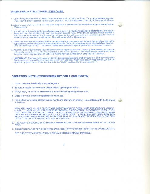

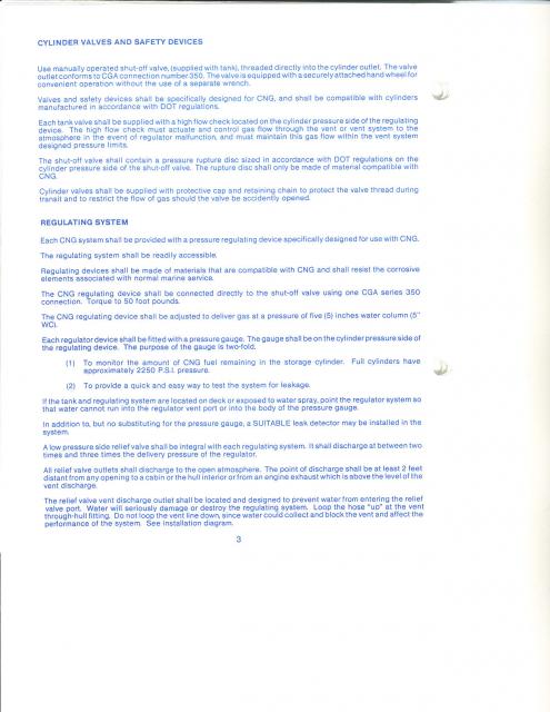

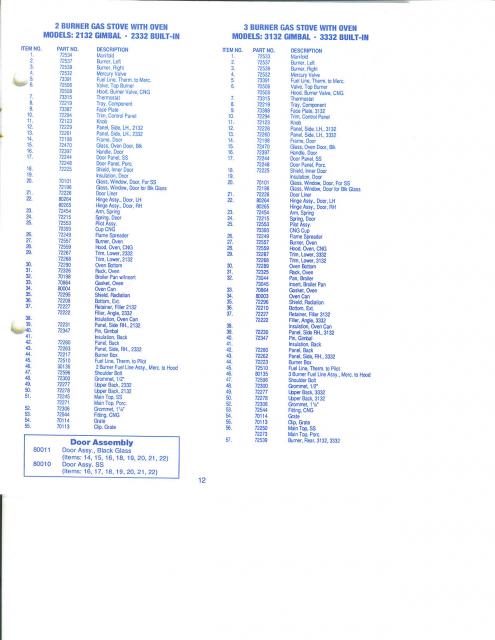

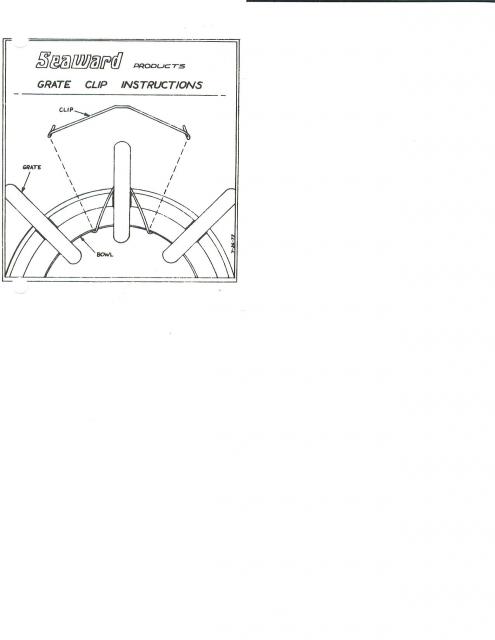

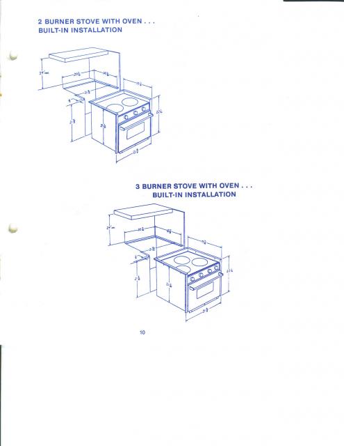

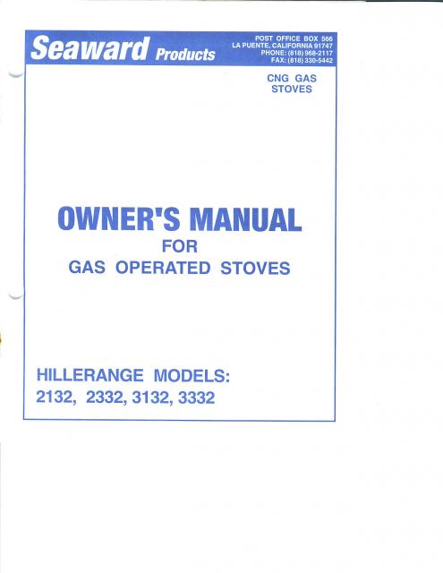

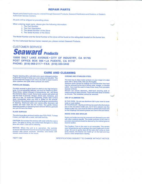

Thanks for all the feedback!! I admit my absolute favorite breakfast is ham and bisciuits. Hard to make the biscuits without the oven. Any ideas where I might an owners manual??
Feb 10, 2007
213
Hunter Legend 40.5 Coconut Grove, FL

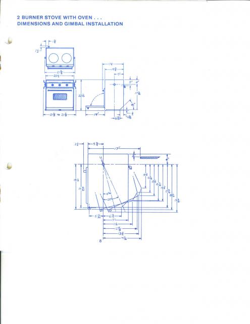

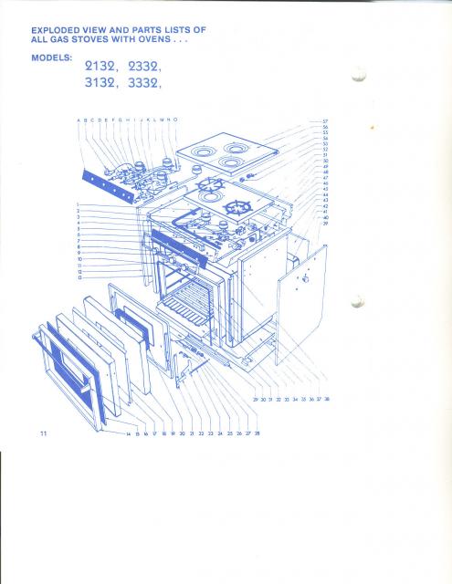

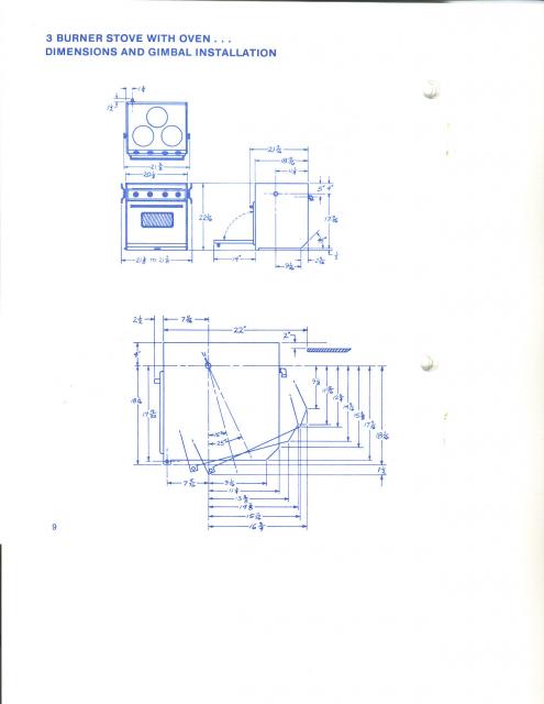

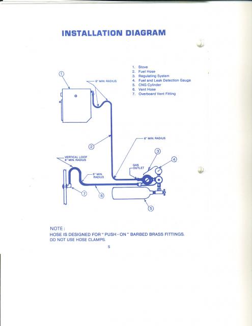

Hillerange by seaward 562-699-7997.
Here is the manual for the CNG. Propane have a different manual
