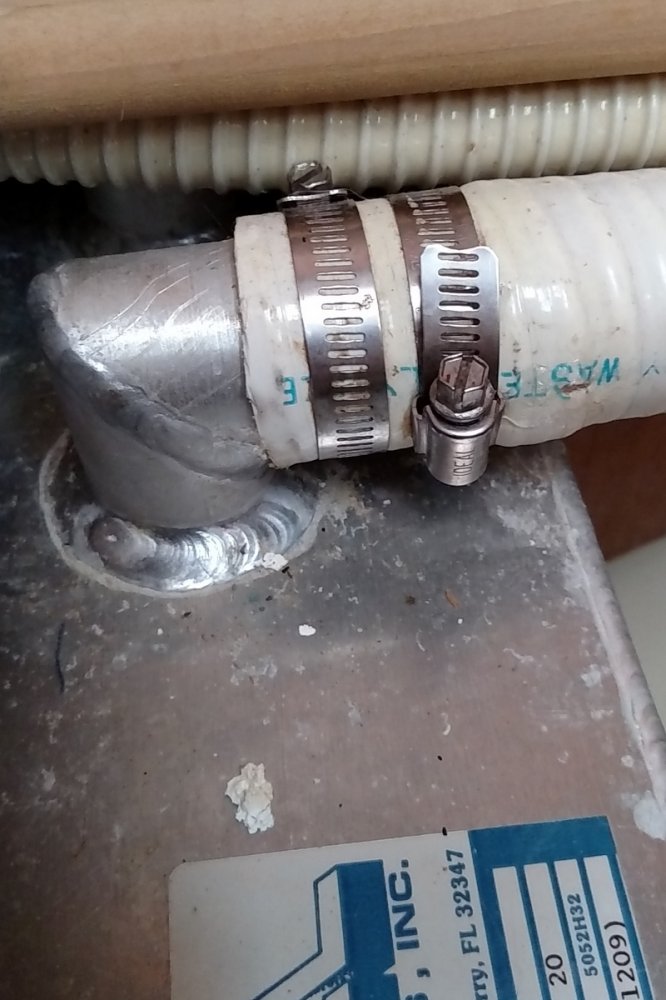

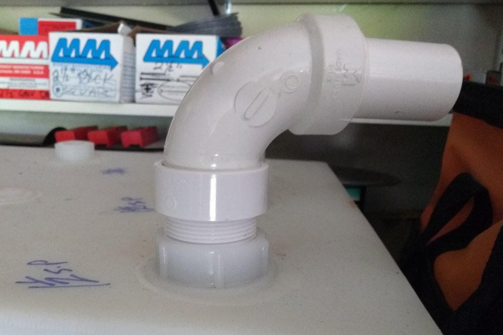

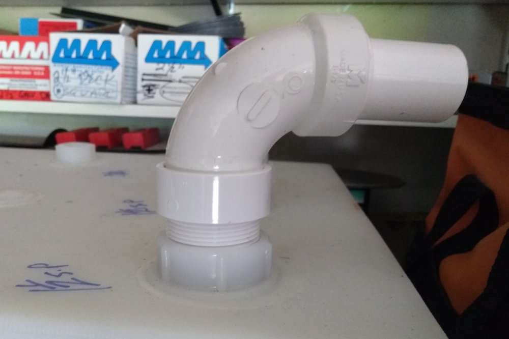

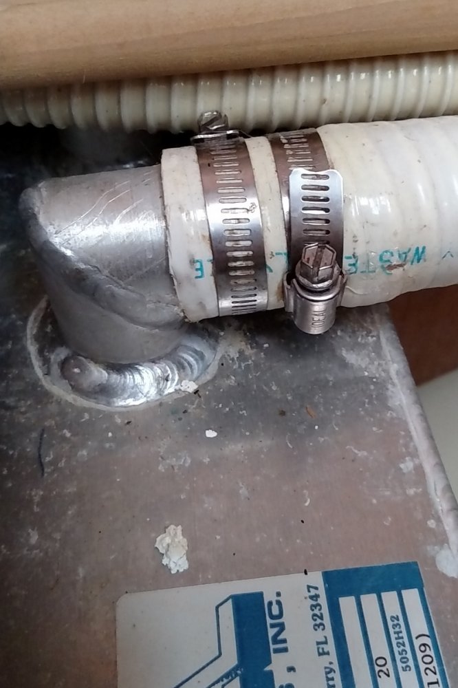

Ronco supplied some fittings and when I saw them, I knew immediately what I had neglected to take into account. The height of the fittings. The original aluminum tank has welded aluminum fittings which make sharp 90° turns. The fittings supplied by Ronco stand tall and proud and will not work.
I could get a 15 gallon tank with the same footprint which would work with the fittings supplied by Ronco, but first I'd like to see if there's a low profile 90° PVC fitting available. I only have 2.5" to work with on the tank I've already bought, but by getting a new tank with different fitting locations I could get just a hair over 3". I'll be using 1.5" Raritan Saniflex hose.
Any ideas? Or am I destined to go with a 15 gallon tank?
Are there better options for fittings?
Here's the new tank fittings, and the include dip tube, as well as a shot of the original fitting.
