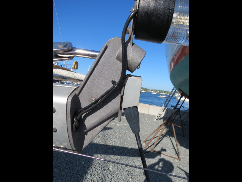

Looking for a manufacturer and possible a dimensional drawing for Hunter 1993 Legend 40.5 masthead. I hit a bridge last year and broke off the small platform that holds the anchor light. Would love to fabricate an aluminum plate that would hold a new LED light as well as the windex . If i knew who made the masthead maybe i could get a drawing to understand what will fit. Any help is greatly appreciated

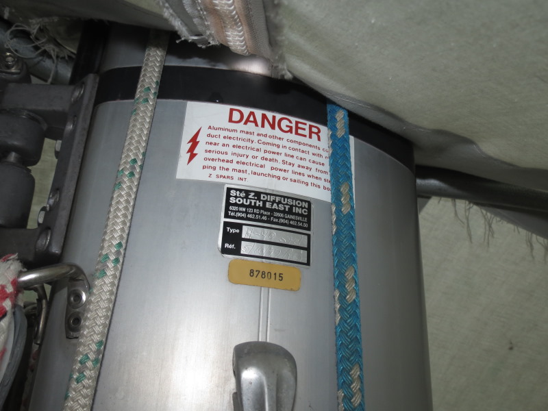

My 1997 h40.5 use a mast manufactured by Z-Spar. My mast info suggests that it is a Z701 mast. I think Z-Spars is now US Spars. I have a mast cross-section diagram but nothing about the masthead.

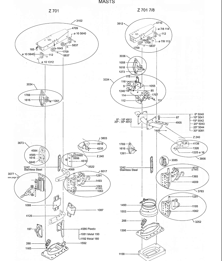

I recently ordered a number of parts from US Spars. Go to the catalog tab and you probably want the Pre-2000 catalog. Get the part number. Go back to the home page and plug the part # in and search. This part looks like it but you should verify.
