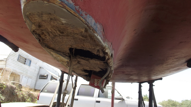

Here is some pics. Actually boat is in Mexico at auto lot. doesn't know where keel is. Said that's the way he got it. Not sure where it might be. Hull seems to have no other damage. Interior is fine, motor is clean. Boat was taken care of by owner by the looks of things. Someone stole the wheel and compass. Sails look good and dry. Needs a good cleaning inside but other than that it seems fine.

Looks like it hit a reef and the keel was lost based of the way the stub has pieces ripped out of it.

They were cast. Lead with 1% antimony for strength. A winged keel would need a split mold to be removed.
Better start collecting tire weights.:)
Also the stub the keel bolts on to will have to be rebuilt - better than new since they were prone to falling off apparently. That may mean the removal of some of the interior to allow the glassing to extend a ways on each side of the stub. There may be cross members that have to be removed (cut out as they will be fiber glass) to allow this, then re-glassed in properly.
ps I think by the time you're in the water ready to go you will have more in the boat than it will be worth.
