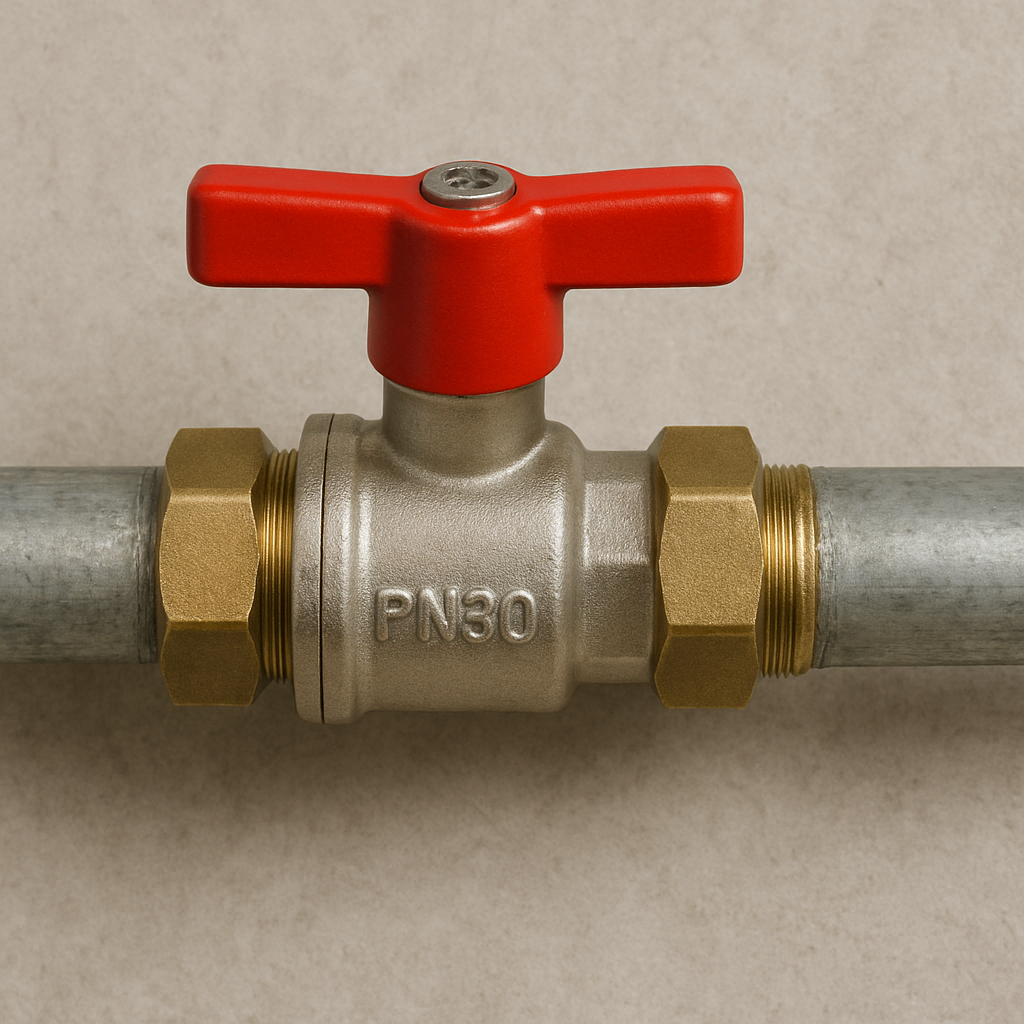

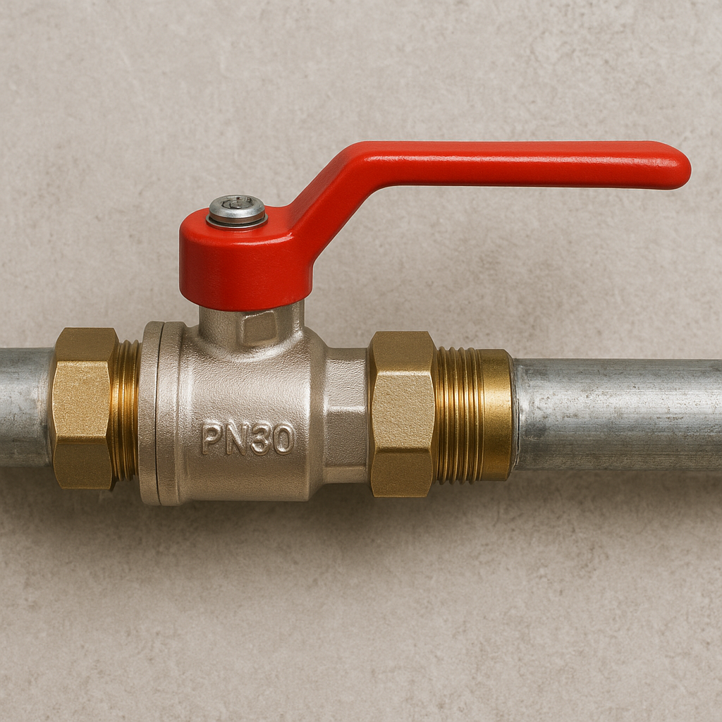

Ball valves are easy when you have direct force rotating the ball shaft using the leverage provided by the arm. A simple quarter turn. If you are thinking about doing it from further away, the problem will be that the 1/4 turn of the shaft will be needed. If you can approach the shaft in line you might be able to use a T handle.
The standard ball valve. The handle turns 90º to open or close the valve.
A T-handle moves in the same 90º but the rotation is from above the shaft.
Now imagine the T-handle but 3 ft long inline with the ball valve shaft.

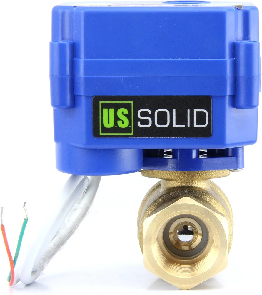

I'm not sure I'd trust a $40.00 electric ball valve on a boat I owned, especially in saltwater, but there are more expensive ones on the market that one might trust to keep a boat afloat. The product information sheets on a fitting such as this would be very helpful in choosing the correct electric ball valve.
While a marine quality solenoid valve would be ideal in in inaccessible places, I would always lean towards a simple cable or extended handle. KISS.
