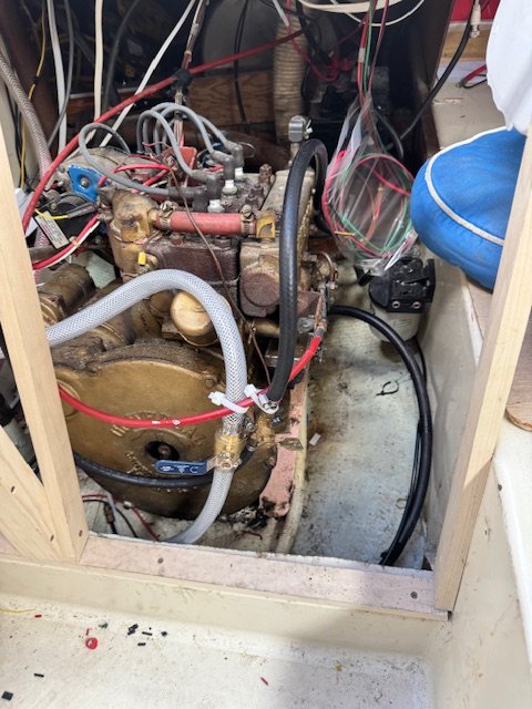

I am redoing my galley / stairs….
I want to have easy access to open and close the water and gas valves, they will be located in front of my motor, how would you design a panel to hold said valves?
7,762
The problem at least for the blue valve handle is that it is right where the step will be. So from one of the step risers it will be a reach to grab the valve and you won't be able to see it..
It might be better to relocate the valve to somewhere where you can make an easily used access panel. I can't think of a reason that valve can't be relocated.
The other valve my early morning eyes don't see. But on my Ranger 29 with the A4 engine, the gas shut off was right at the tank, not near the carb.
I would look for a place on the side of the engine where there could be access from the 1/4 berth. A hinged panel which would fold down and uses a latch on the top to keep it closed when not in use could work. You might even get access to the oil dipstick in there. The hatch could be decorated with a nice wood panel finished bright, or creatively with a port, or whatever else.

I would put some thought into the step itself being hinged . Lift the step , turn valve and close . I also don't see the second valve .

I was thinking about having them behind the stairs, having a small door/flap so they won’t accidentally be turned on/off.
the second valve is smaller, it is just beside the water valve, if you follow the black hose, it is just below the second ty-wrap to the right of the water hose one.

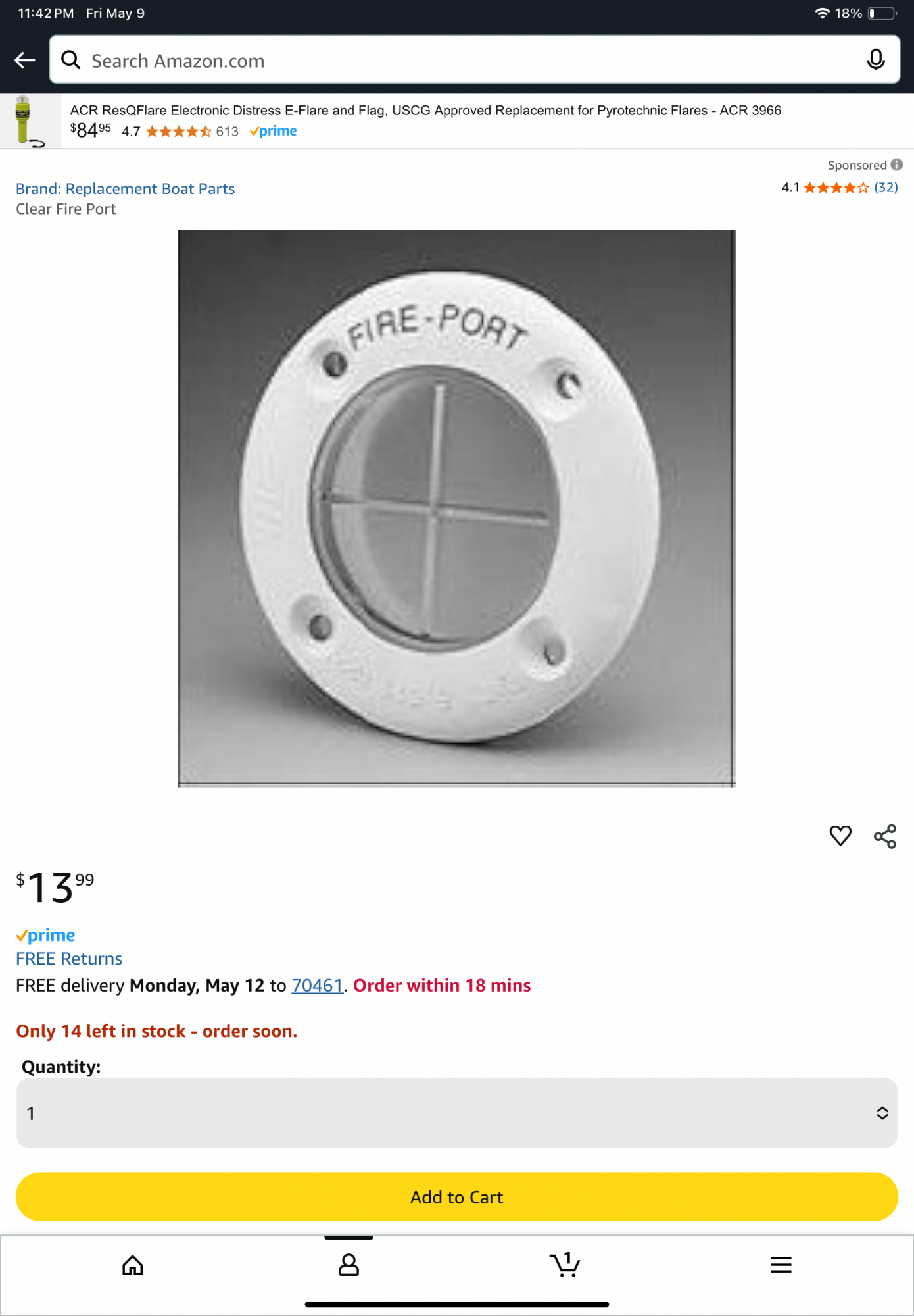

Seems that for safety reasons the gas valve should be located on or near the tank. Use a manual shutoff valve with a push/pull cable remotely located to a convenient & readily accessible location, but not in the engine compartment. I would also install a plastic fire port / plug into the engine compartment door that allows a fire extinguisher to be inserted & discharged into the compartment without removing the engine cover. The port is an A.B.Y.C. requirement on newer boats. $14 on Amazon (Marine east, Vetus, Osculati, etc.)
Yup. Don't want to open the stairs to get at a fire. A big rush of fresh air isn't good.
