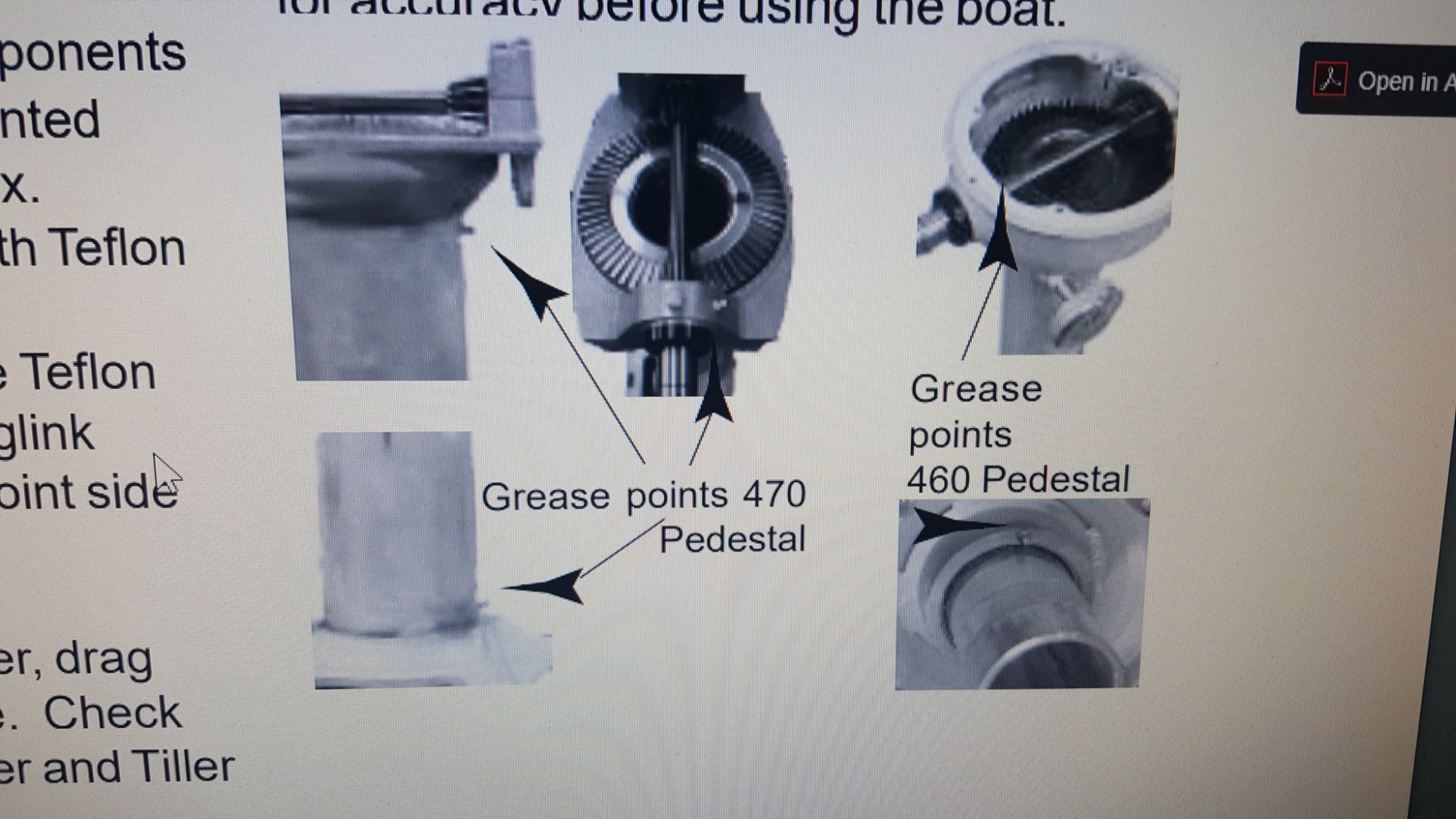

I think I may have found a manual online that shows pictures of the fittings...see attached. Are these where your's are?

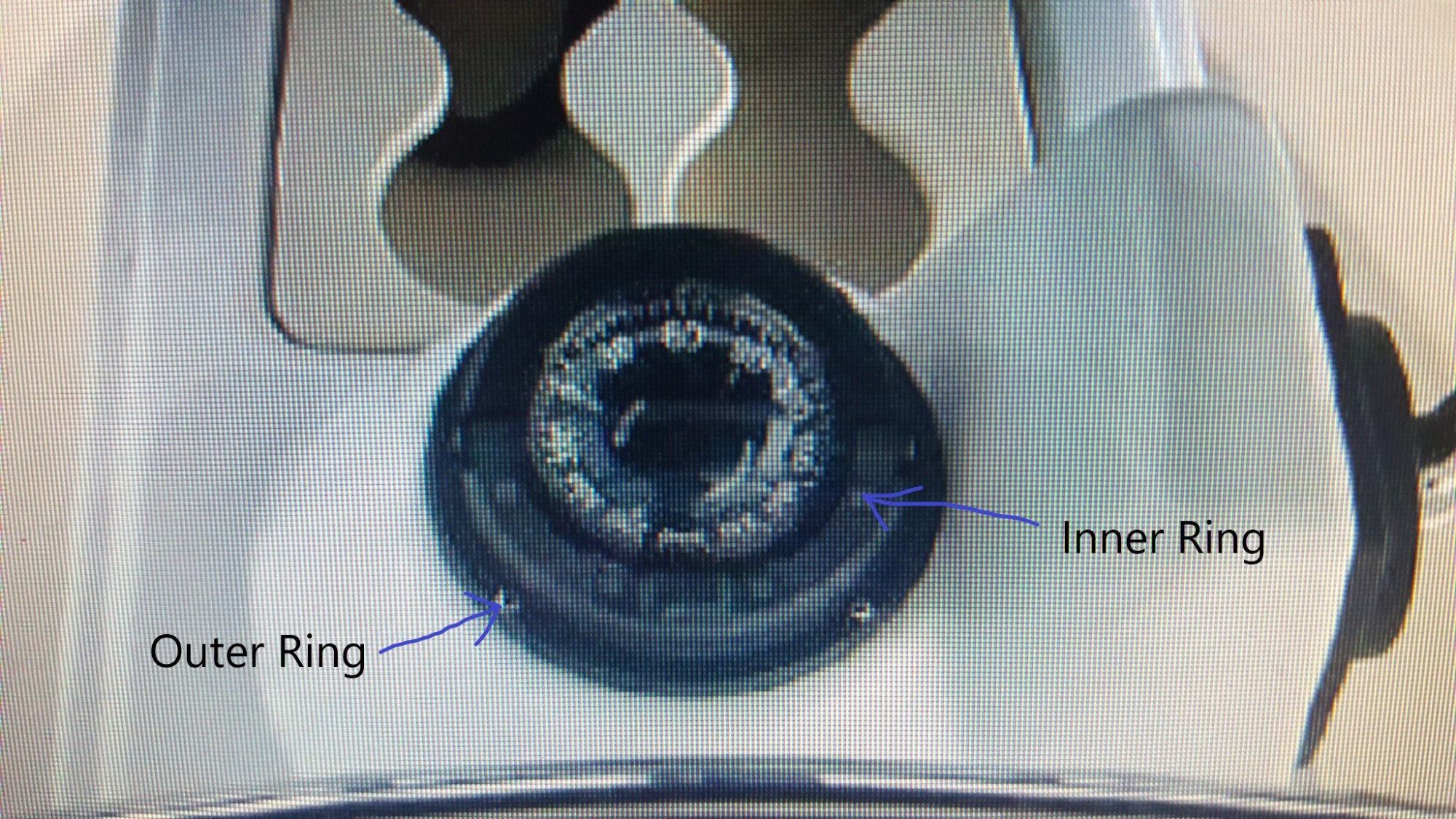

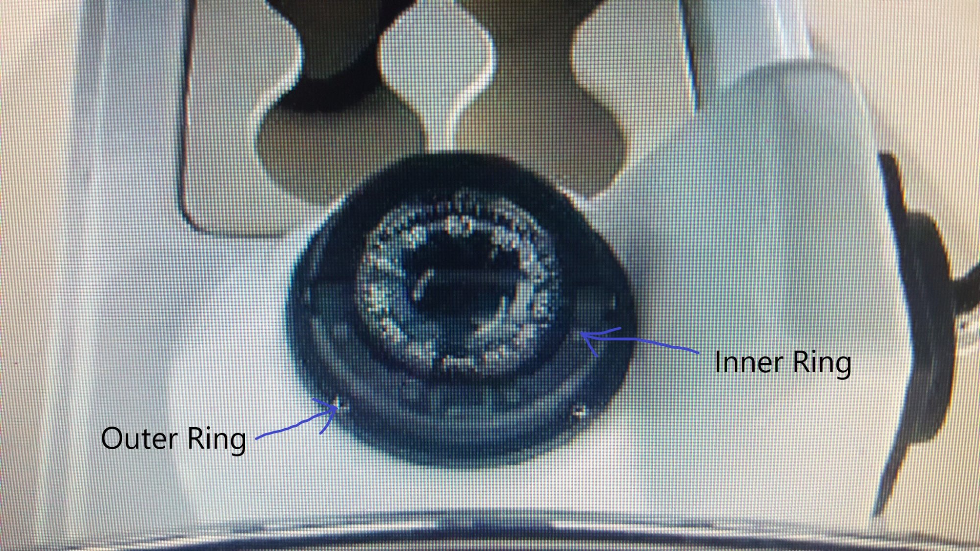

Which ring of screws do I remove for compass...outer 4 or inner 4? Mine doesn't have red or black...it's all black.
Sep 26, 2008
795
Hunter 340 0 Wickford, RI
The four inner screws closest to the compass globe. Yes those are the grease point locations. The center photo of the five pictures is the point under the compass. The bottom left picture is the bottom of your column. Depending on your column, you may or may not have the point in the top left picture.

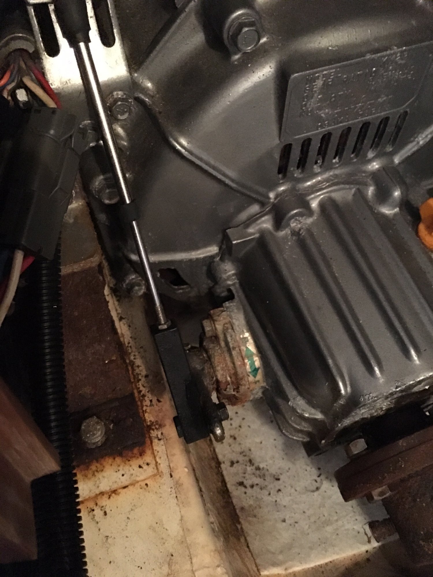

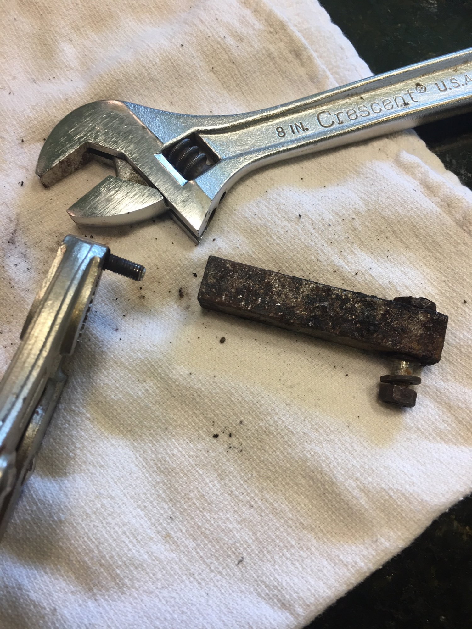

One thing that broke on my boat due to lack of lubrication, the gear shift on the transmission. The block at the end of the cable seized up on the transmission lever, wouldn’t rotate and the threaded cable end broke off in the block.
There’s rumors that before I managed to repair it, I actually laid in the aft cabin and shifted the transmission manually so we could get out of the marina to a race.
